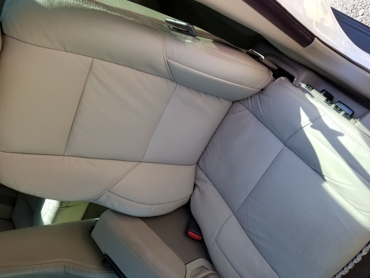

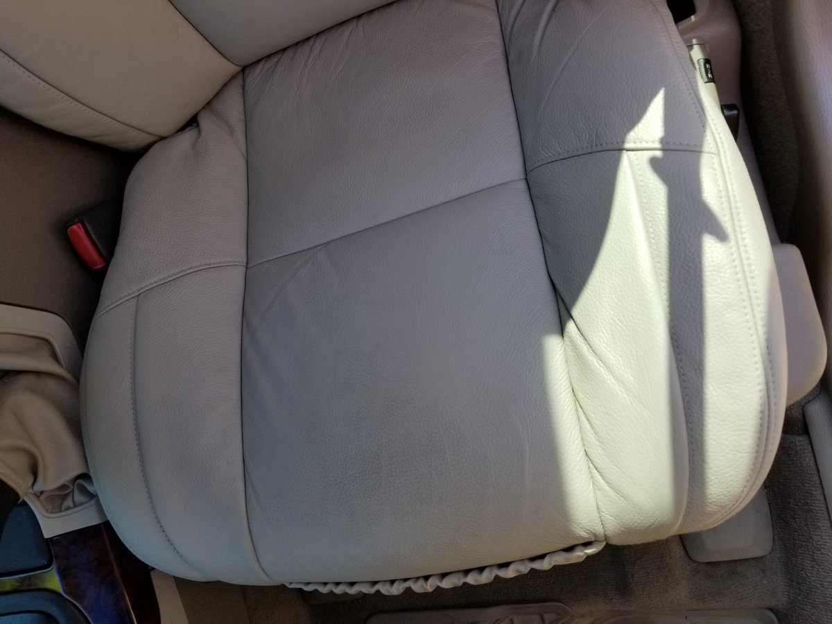

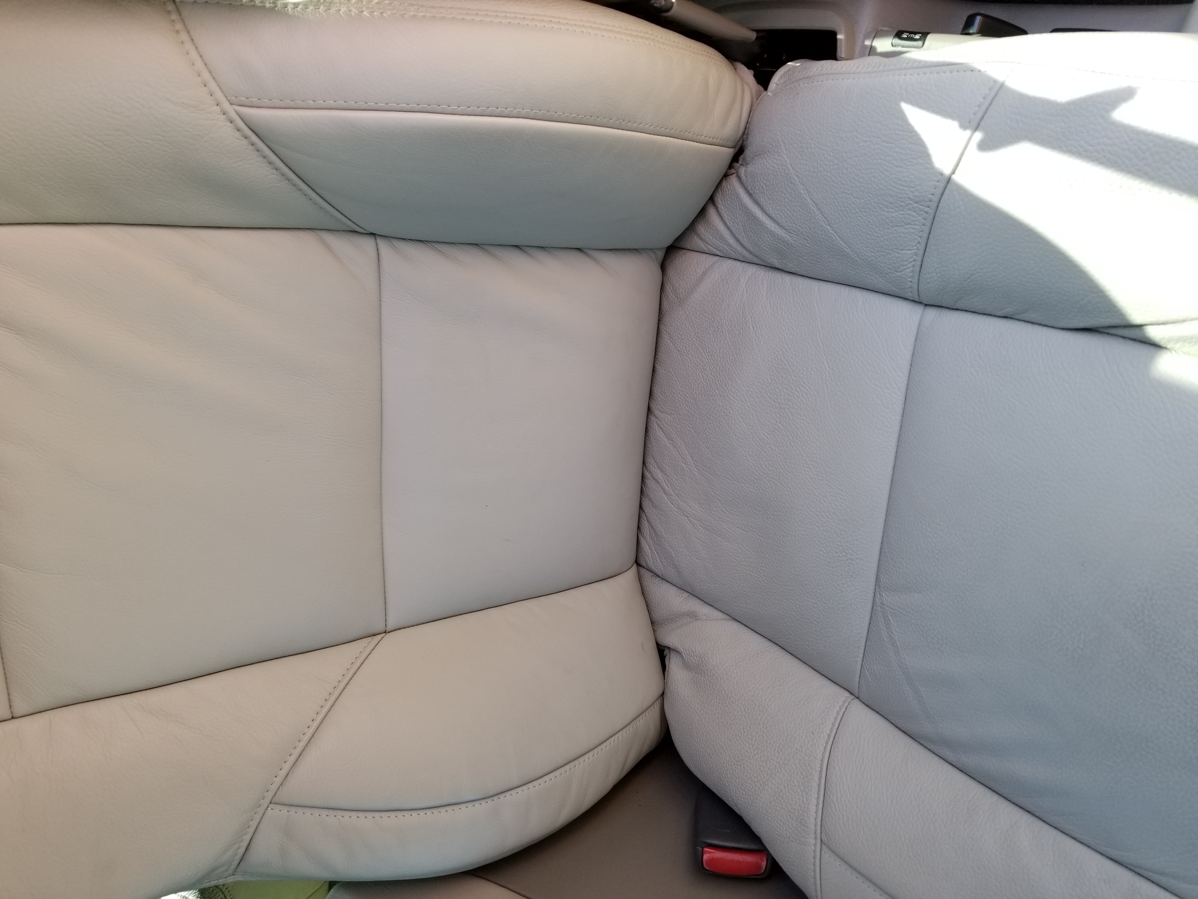

My new Volvo skins.

Get some Connolly leather treatment on those, and put a 'no screwdriver' post it on your window.

abscate wrote: 26 Apr 2018, 08:24 Get some Connolly leather treatment on those, and put a 'no screwdriver' post it on your window.
πŸ™ˆπŸ™‰πŸ™ŠπŸ‘§ I will definitely treat them. I am so happy to have my car back! They had her three weeks! I got used to the XC90 T6, but it sure feels good to drive the real T6 again. June
