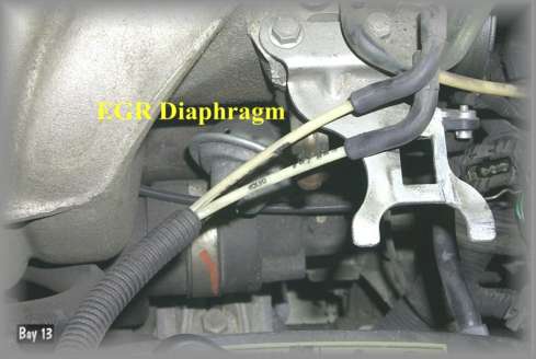

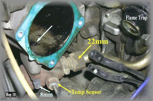

Take note it is easy to confuse EGR valve with the SAS valve, even though they are located in different places. There are three pics on this page: http://volvospeed.com/volvo_repairs_how ... n_egr.html. Pic #3 shows part of the EGR right under the word "Diaphragm" you can see that from the front of the car if you look down under the throttle body. And in pic #2 the back end of the EGR assembly is pointed to in yellow arrows. Actually that pic also shows the fame trap (throw away the flame trap disc!).

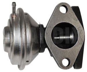

Here's a clean EGR diapragm: http://media.skandix.de/pimg/1026122.jpg

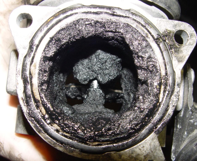

And here's a dirty one: https://www.volvoforums.org.uk/showthread.php?t=127481

"pic #3"
"pic #3"
"pic #2"
"pic #2"
clean EGR port
clean EGR port
dirty EGR port
dirty EGR port

Checked my VIN and it shows mine has an EGR. Will doublecheck following the pictures. Thanks again.
