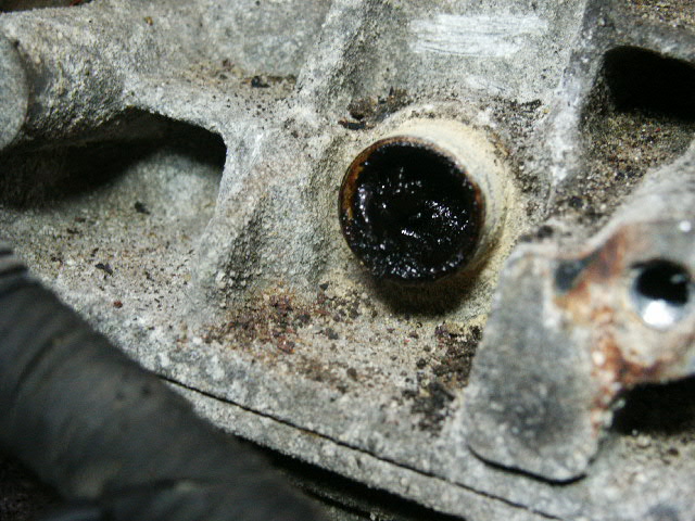

Yes, I think they just replaced the box. That's what they told me through the phone and what appeared on the receipt. If they replaced anything else, I think they will charge me for it. They also showed me the old box, which is definitely clogged. Not sure whether any cleaning is done or not.ecbsykes wrote: 29 Apr 2018, 13:45 All they replaced was the oil trap box? That's usually the one part you can re-use because it rarely gets fully filled/clogged as far as I know. Where it connects to the engine block IS a place that needs to be cleaned out though.
I don't know whether the box is fully clogged. But they showed me the input and/or the output are clogged. So this means I need to replace the pipes? I have read through several posts on the forum. Looks not like a very easy project. (The most difficult one I've done is replacing the cooling fan.) Guess I will start with figuring out the parts I need.Rattnalle wrote: 29 Apr 2018, 15:07 If the box was clogged the pipes into the block most certainly are too. Other pipes may be as well.

If the box is clogged, then PCV service is badly needed. Replace all the PCV hoses, find and throw away the flame trap (probably also clogged up), and most definitely inspect and clean out the passages from the engine block to the box.rred wrote: 29 Apr 2018, 22:06I don't know whether the box is fully clogged. But they showed me the input and/or the output are clogged. So this means I need to replace the pipes? I have read through several posts on the forum. Looks not like a very easy project. (The most difficult one I've done is replacing the cooling fan.) Guess I will start with figuring out the parts I need.Rattnalle wrote: 29 Apr 2018, 15:07 If the box was clogged the pipes into the block most certainly are too. Other pipes may be as well.
For the three smaller hoses that connect to the box, you must buy Volvo branded parts. Many people have done this aftermarket PCV hose experiment: if you buy aftermarket, you must go back in 2 years or less replacing rotten hoses. For the long hose/pipe that connects to the oil trap, you can either DIY and buy your own hose (find the method posted on this site by tryingbe, the hose he uses is definitely the best choice; second best is a pre-bent 90 degree heater hose) which will save you about $50, or the other option is you must buy the Volvo branded pipe.
PCV isn't hard but it takes a long time to take everything off, then put everything back on. Don't forget you also need an intake manifold gasket to do the PCV job. I would replace all rubber vacuum hoses while you are in there (viewtopic.php?t=65002). It is a pesky job but the 20 year old rubber hoses under the hood are mostly falling apart by now.
