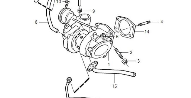

I searched online under 2001 V70 2.4T and this is what the part diagram shows. I believe someone changed your studs/nuts to bolts and that is your problem. We are talking about #4 and #6 in the diagram. Even #2 and #3 are stud/bolts.

I did a search on your questions and there are theories galore. Ranging from easier to superior.
What makes the most sense based on my readings is that the stud is tightened until it bottoms out b/c of no more threads then the bolt is used for the clamping force so only the bolt takes the twisting and related forces. As the bolt is pinched it doesn't want to readily come out. Not sure what the correct answer is, but you have a problem and the best solution may be to copy the original set up.
From what I see your studs should be 8mmx40mmx1.25. Buy the studs at the dealer would be the for sure solution. If not, I don't think longer would be an issue, but you will have to judge this when you see what is readily available. Restricting parameters is the ability to get the thread to bottom out on the exhaust manifold while being inserted far enough and have the non-thread portion not be so thick that the bolt cannot exert clamping forces and the ability to get the nut on. For the nut the proper size was listed before - just look for one that is pinched. From what I have read don't use stainless steel.
