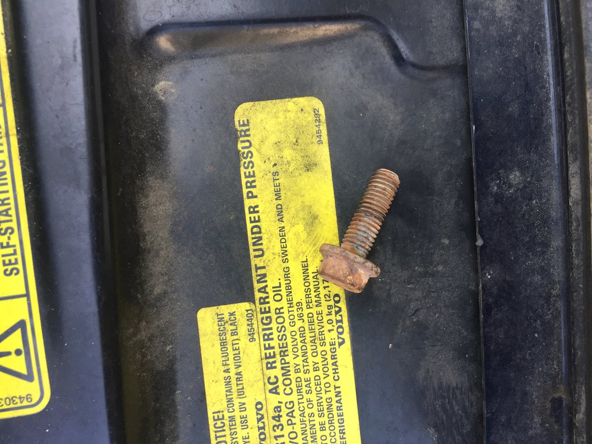

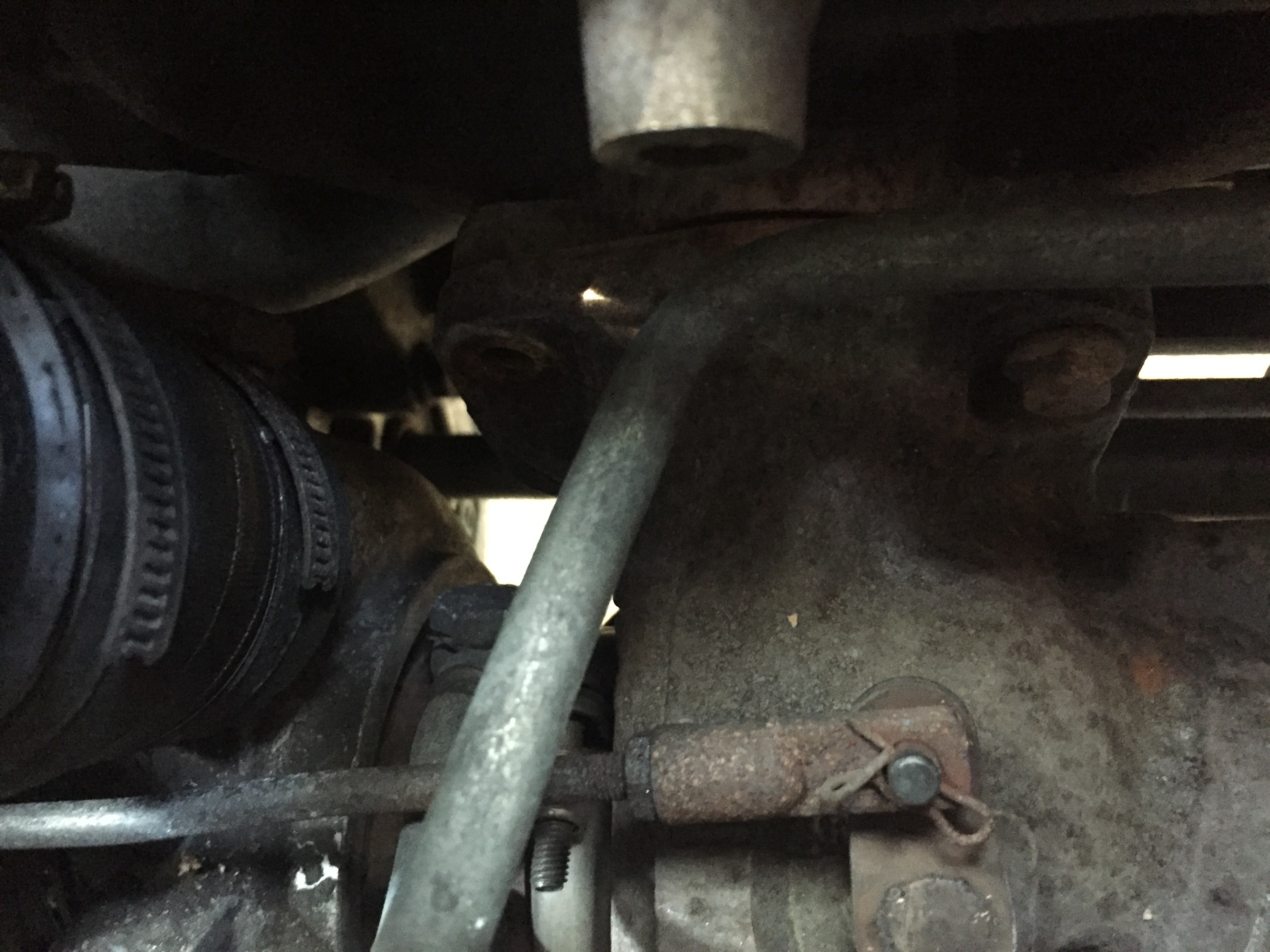

Here’s what I’m talking about.
See the missing bolt on one side?
But wait, it gets worse. I took the other upper bolt out to show you all. Because it was FINGER LOOSE! So is at least one lower bolt!
Ahhhhhh!
Ahhhhhh!

Not what I was thinking, indeed

Turbo to exhaust manifold, correct? I think several poster were talking about the turbo outlet to the downpipe.
