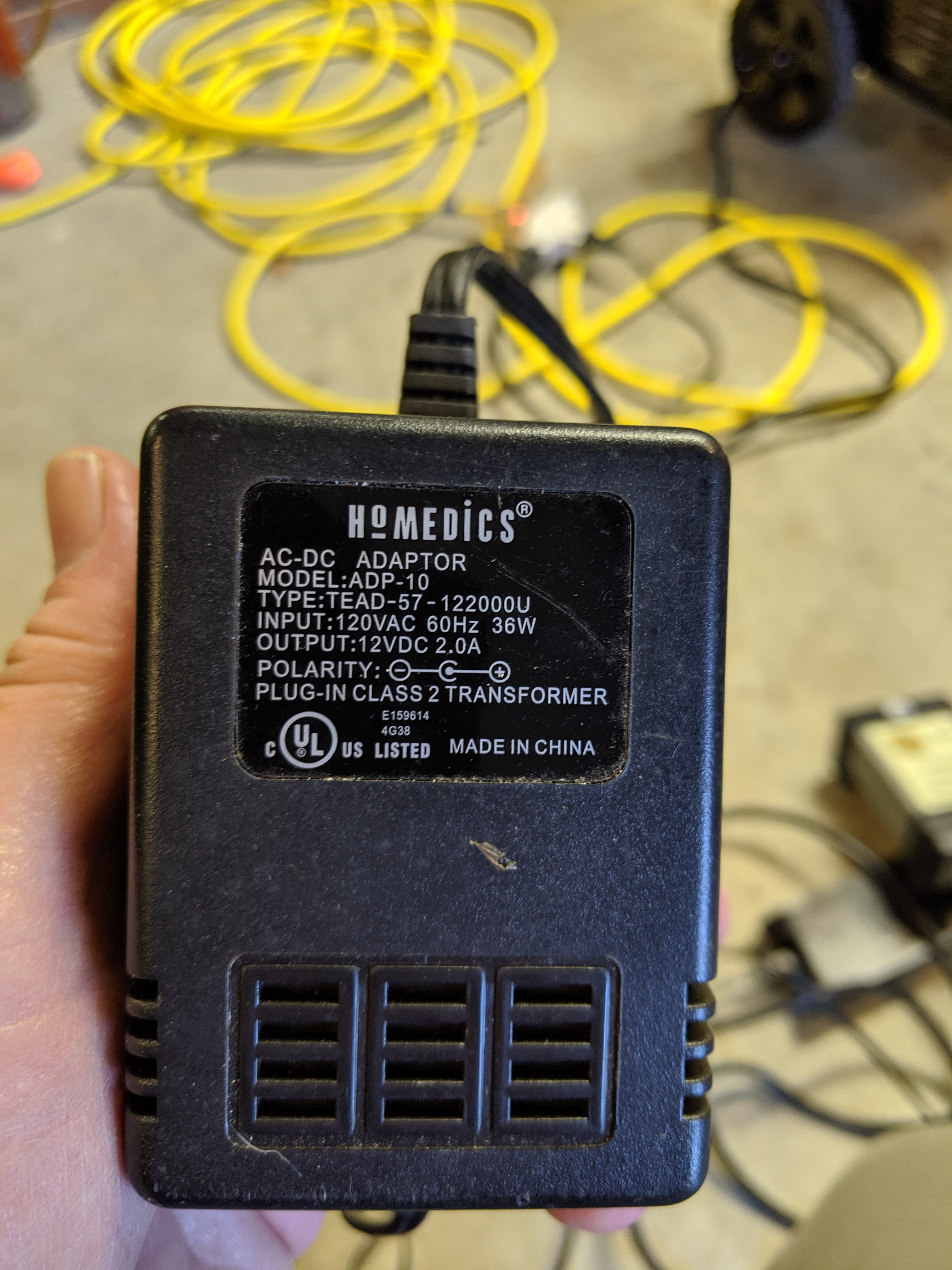

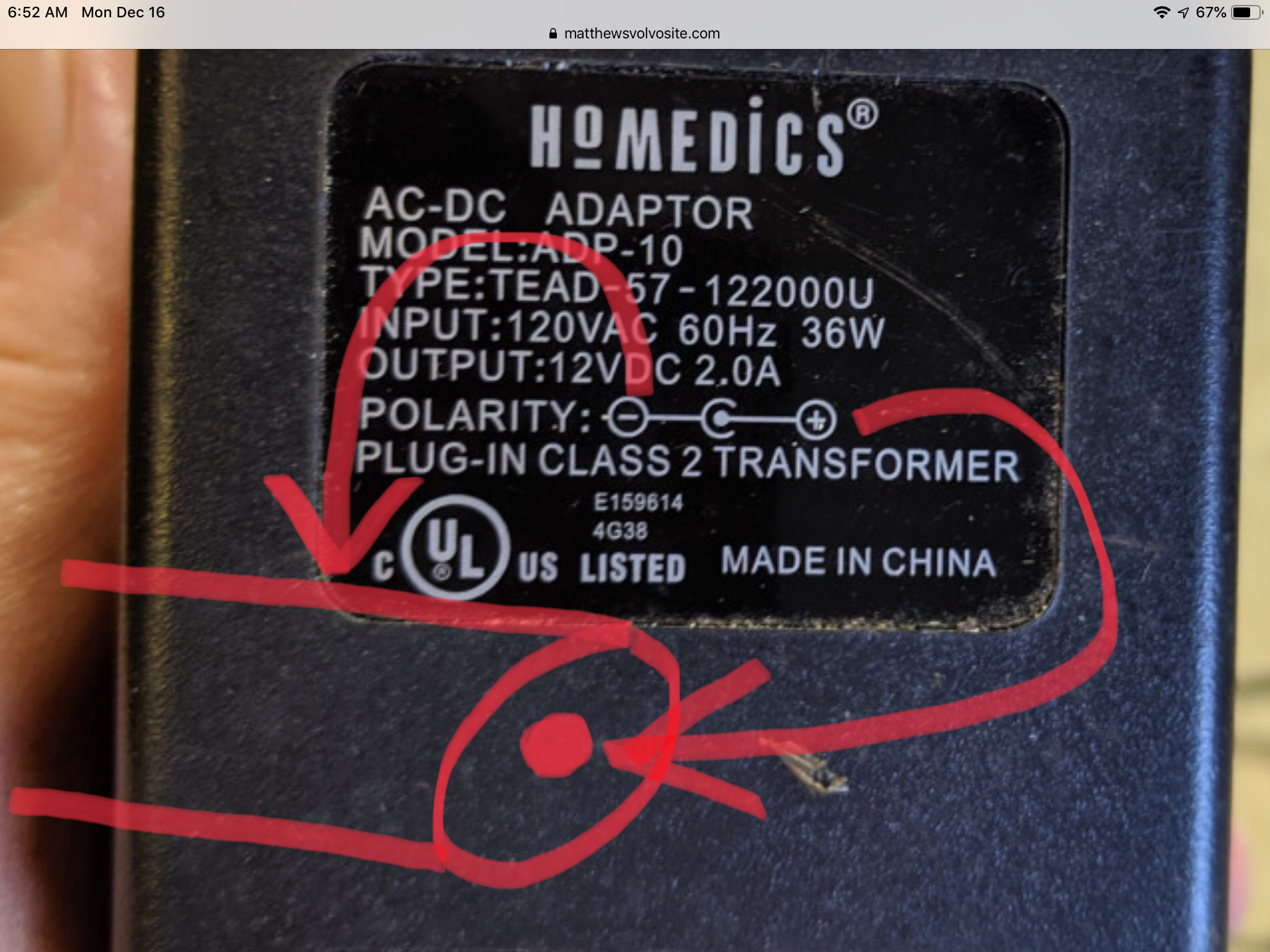

regarding the 12 volt DC 1 amp adapter, can you tell me the polarity of the tip? Is it (-) on the outside and (+) on the center?
I have a 2 amp 12 volt adapter that fits perfectly but I want to make sure the polarity before making it live.

Update: I disassembled the Dice and checked the 12v power socket. It matches what my adapter has: negative outside and positive center.

PatrickHenry wrote: 15 Dec 2019, 13:25 Update: I disassembled the Dice and checked the 12v power socket. It matches what my adapter has: negative outside and positive center.
Here is the scoop...probably 99% of things with module power supplies are wired for this
