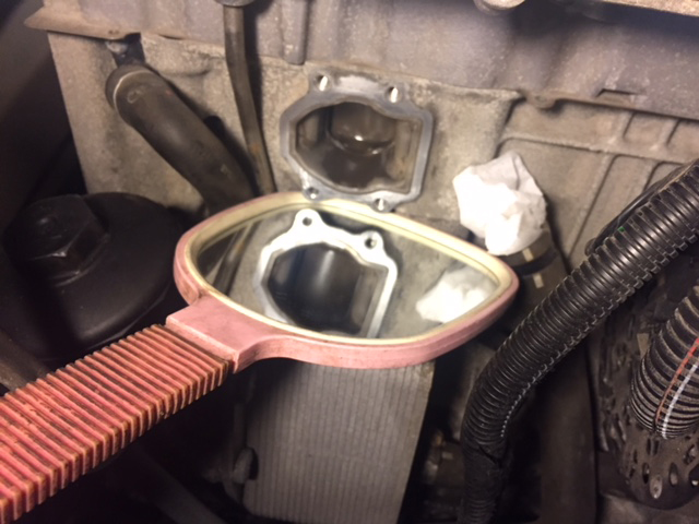

New hose to oil cooler and thermostat installed:
- MVS_XC90_2655.jpg (180.26 KiB) Viewed 2492 times
- MVS_XC90_2656.jpg (201.27 KiB) Viewed 2492 times

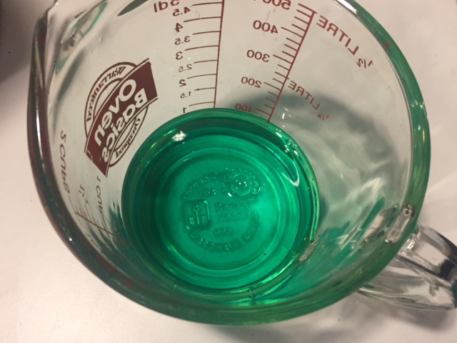

The new Volvo coolant color is a lot translucent then previous. The jug is 1 gallon (3.78 liter). I'll mix 2 liter coolant with 1.78 liter of distilled water (approx 55:45 ratio). 2 concentrated jugs will make 16 quarts for an initial fill of 11 quarts.
Even after the drain, there was some old coolant in the block and heater core. What is the best way drain out old coolant before filling with the new Volvo coolant?

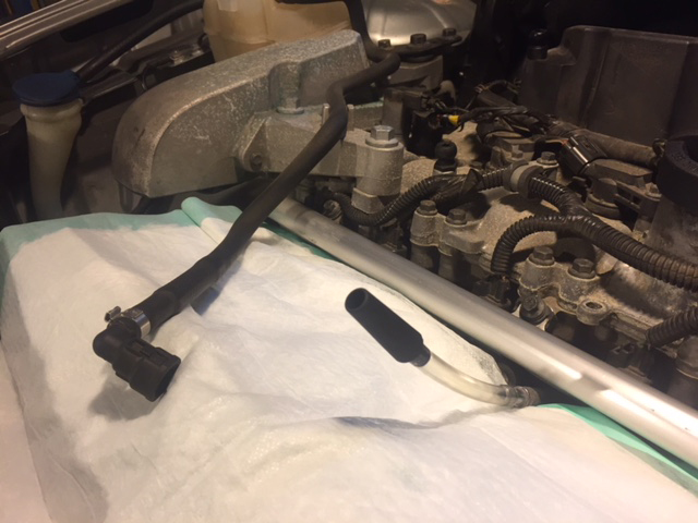

The monitor/refill tube installed at the intake.

Switched from the old Volvo coolant to new Volvo coolant after installing new radiator, thermostat, hoses, o'rings etc..
Supplies:
- Volvo Coolant PN: 31439821 x 2 @17.85 ea. (made 55:45 mix/ 16 quarts)
- 4 x 1 Gallon Distilled Water @ $0.68 ea.
Here are my steps after everything was connected:
assuming there was some old coolant in the block
Supplies:
- filled the expansion tank with 4+ quarts of distilled water to flush and rinse off old, added more to keep level as it self burps
- ran the engine, added more distilled water to keep the level, once stable, ran the heater and blower fan at max
- once engine temp reached WARM shut off
- cool down and drained at the radiator petcock - 4+ quarts came out as normal
- REPEAT ABOVE IF YOU'RE CHANGING COOLANT MAKE
- connected translucent tube at nipple
- added 4+ quart 55:45 mix, let the coolant level settle in the expansion tank
- began adding 4 more quarts while monitoring the tube at the nipple -- the distilled water/old coolant mix appeared in the tube -- allowed the visible bubbles in the tube to escape and fluid to settle in the tube
- connected a pump with longer hoses to the tube
- now continued filling expansion tank with 55:45 mix to max
- ran the pump and siphoned off close to 2 quarts. At this point new turquoise color coolant filled the tube/hose connected to the nipple and pump
- checked for any leaks everywhere. Prepared to catch any spill and disconnected pump and hose
- disconnected tube at the nipple, catch spill, and reconnected expansion tank hose back for normal operation
- close to 9 quarts of new coolant is in the system at this point
- filled the expansion tank to max with 55:45 mix
- ran the engine, add 55:45 mix to keep the level, once stable, ran the heater and blower fan at max. once engine warmed up shut off engine
- cool down and drained at the radiator petcock - 4+ quarts of new coolant came out
- added 55:45 mix to keep the level, once stable, ran the heater and blower fan at max
- turned off the engine and cool off
