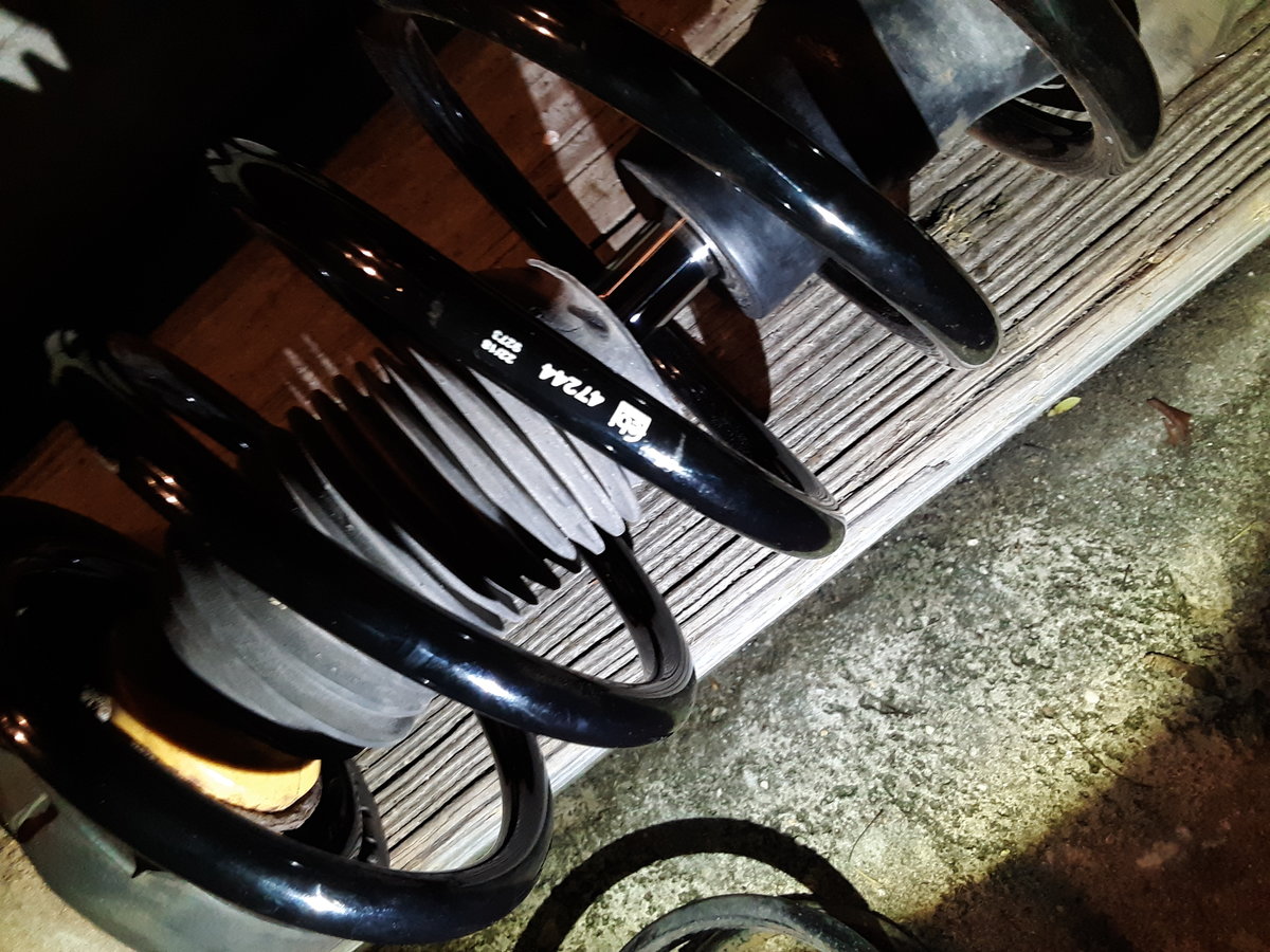

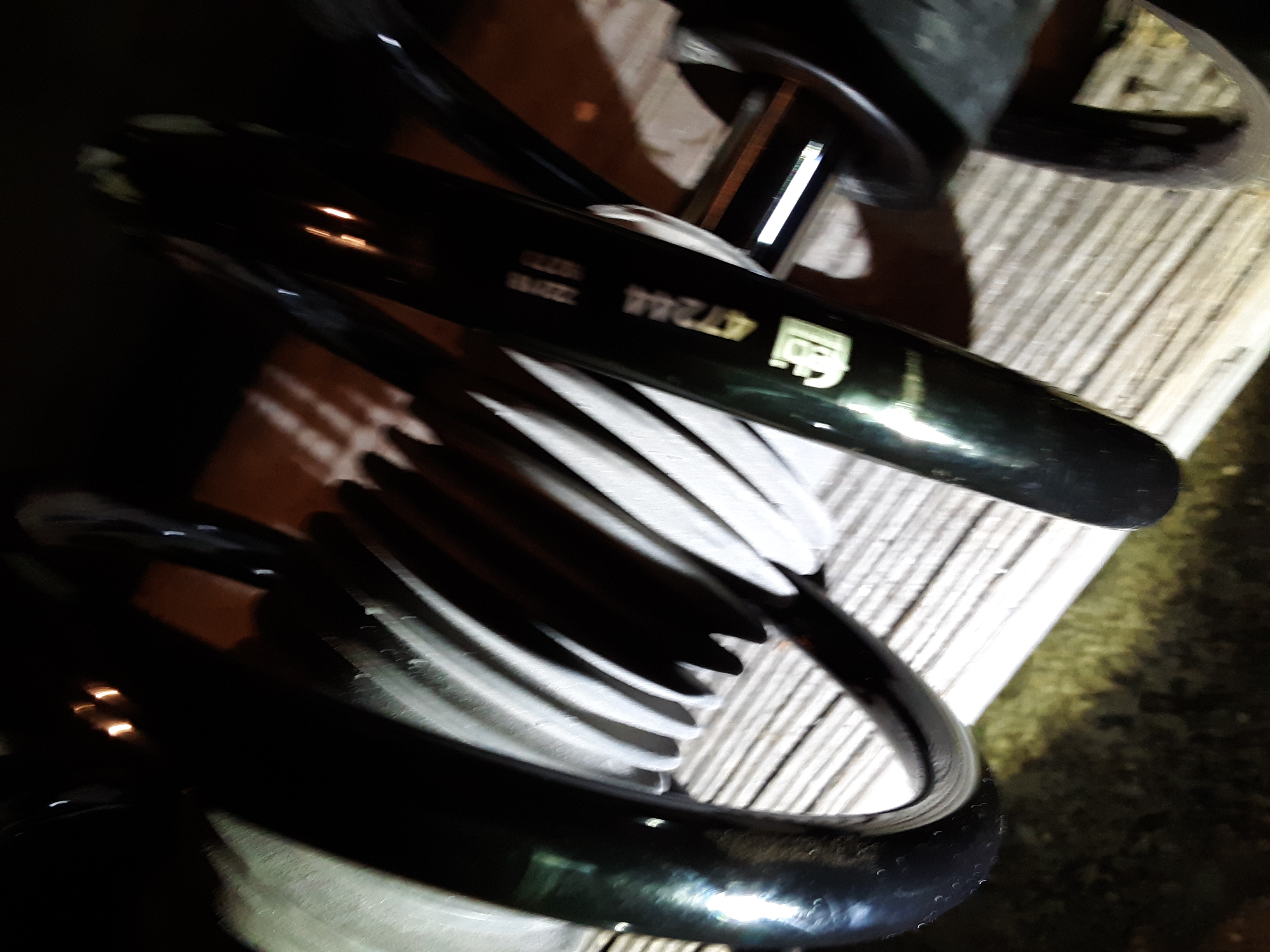

So this is the F/R strut with a new Febi Bilstein coil spring. I figured I would try a different brand this time, Bilstein is very well known for excellent suspension parts whether factory spec or high performance. I've seen springs break but 3 broken springs from same vehicle I haven't seen. But after reading everyone's responses I'm getting the feeling that the P2 chassis V70 Cross Country should of had a heavier duty set of coil springs at all 4 corners.
