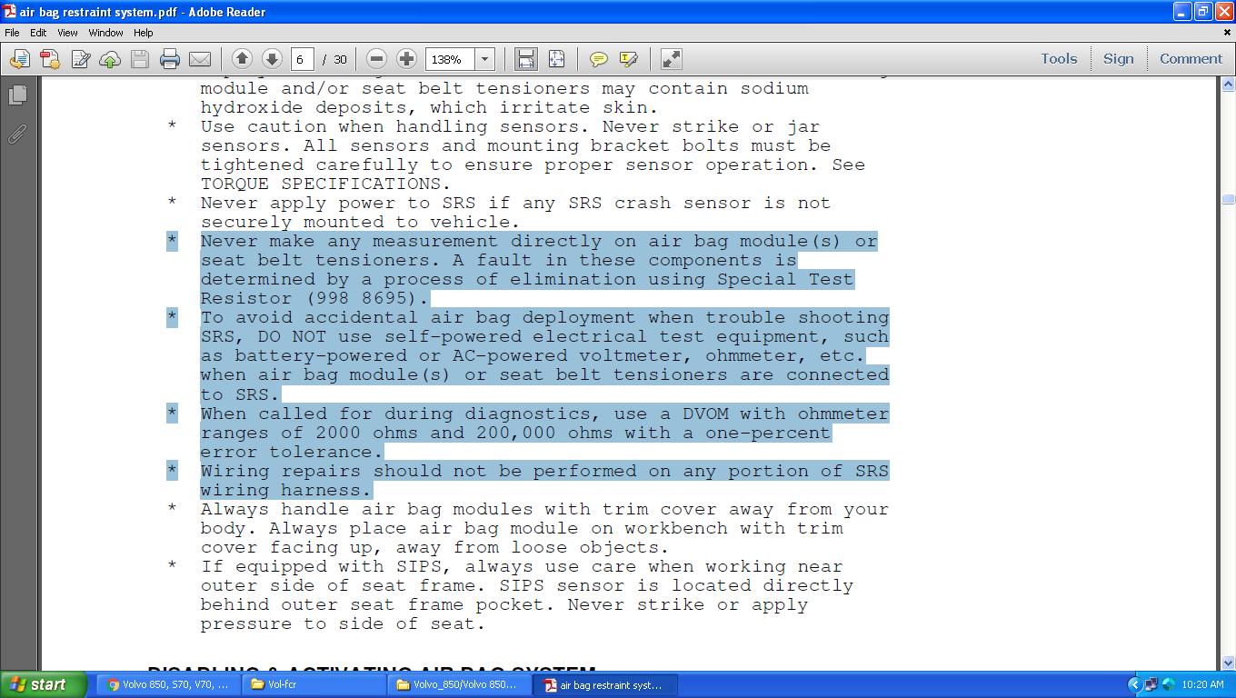

Carefull....resistance measuring with a multimeter can lead to airbag deploy!
There is a statement about that,somewhere in Volvo SRS documents.
No measurements of any kind should be performed in SRS system.
