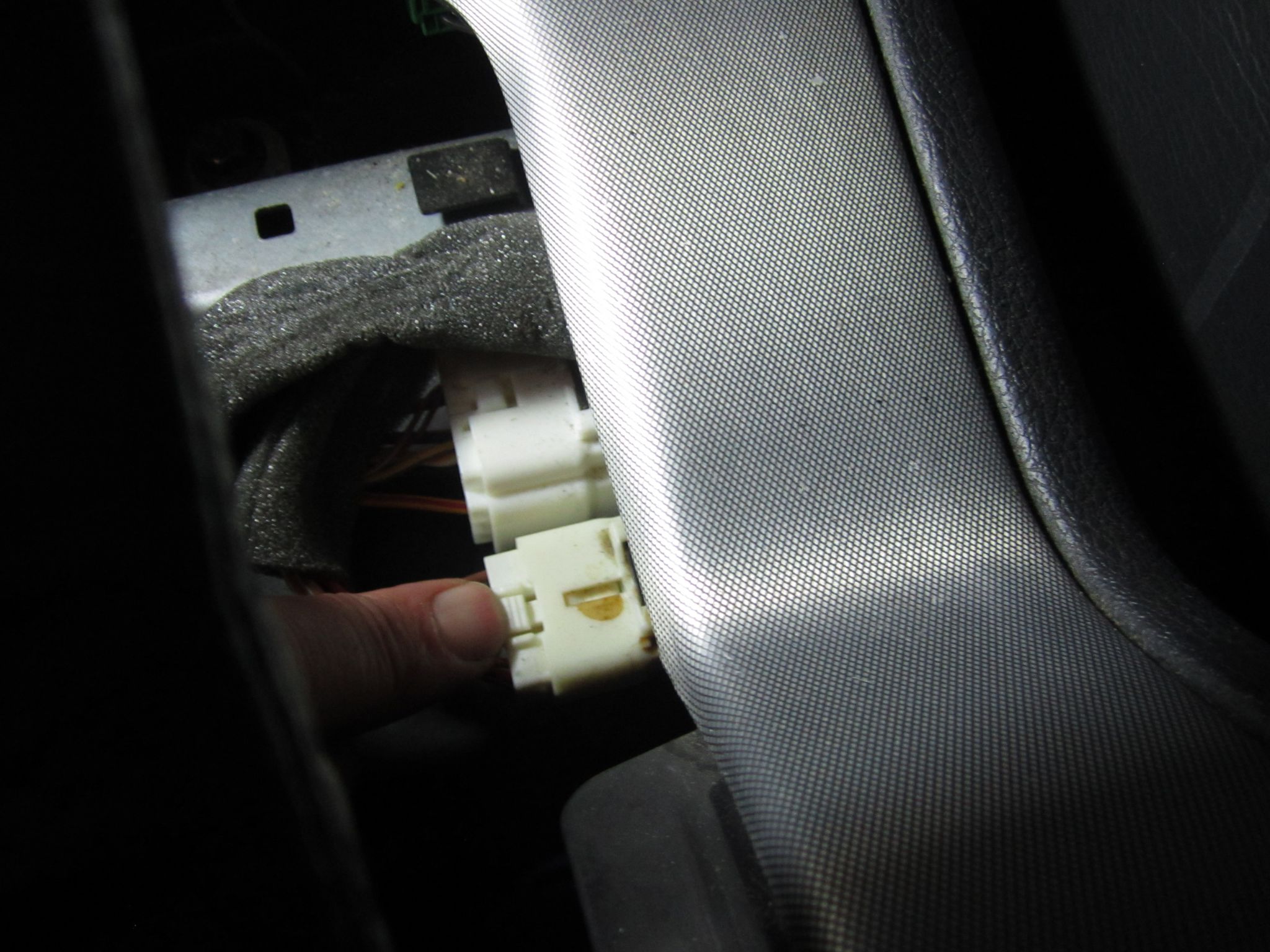

Has anyone removed the center console? Could be as simple as the connectors have not been re-fitted or re-fitted correctly. Also worth checking no one has spilled a drink in there. To check you will have to remove the parking brake plastic panel. Careful not to break the pins.

scot850 wrote: 31 Mar 2022, 10:28 Has anyone removed the center console? Could be as simple as the connectors have not been re-fitted or re-fitted correctly. Also worth checking no one has spilled a drink in there. To check you will have to remove the parking brake plastic panel. Careful not to break the pins.
Hope this helps.
Ok ,cool.
Will try that! Thanks
