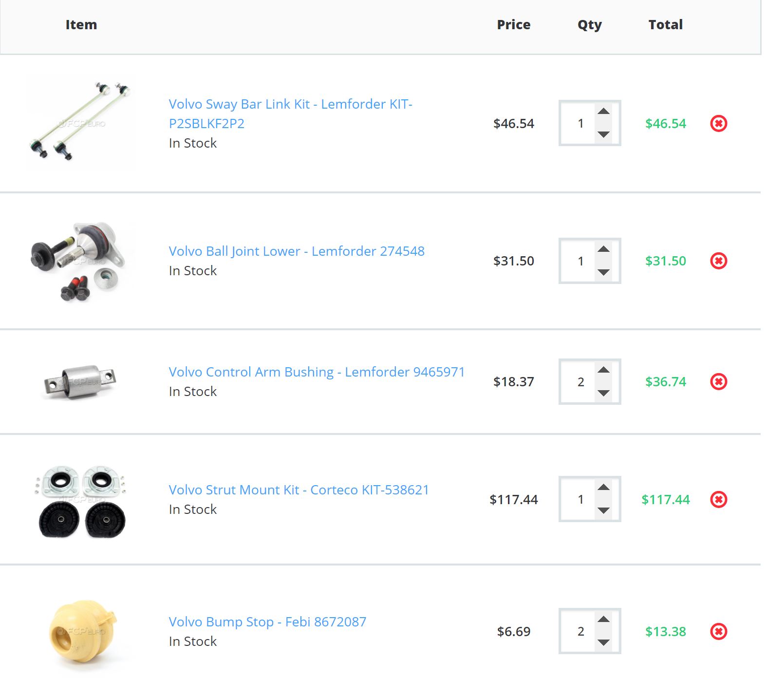

Post by fontoledo »
Hello all again. I´m about to purchase all the parts needing replacement but before doing so, wanted to quickly check with you guys, to ensure I´m choosing the right parts and brands. See attachment for the image of my Cart in FCP Euro.
I appreciate the advice, everyone!

Post by oragex »
My take on this, is to spend only money on the known worn items. Reason is, after 100K miles there is always money to spend on something , so better to save it for the necessary repairs.
The say bars and the ball joints are good in Lemforder, but I would only replace them if they have play to them. It is very easy to test these at an honest garage (notice I didn't name the main dealer). For the control arms, buy only the full arm Lemforder, not the bushings alone - assuming your arms are worn - see here www.youtube.com/watch?v=P1QaJbyjr2s )
For the Corteco kit, the spring seat is Sachs=good, but not sure about the Corteco strut mount
For example, in this other kit the spring seat is Rein but the strut mount is Lemforder and is very suspiciously cheap - https://www.fcpeuro.com/products/volvo- ... atkit1-oem
What's more the reviews downvote this strut mount by Lemforder.
https://www.fcpeuro.com/products/volvo- ... 68#reviews
Rein/CRP and Sachs make the genuine spring seats for Volvo (same part with the 'Volvo' name scratched off)
I would recommend testing any original part when removing it and not discarding it, just in case.
