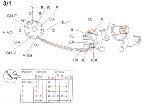

Here's the ignition switch straight from the '98 diagrams,
along with the color code chart to help you rat this thing out.

Are you sure you have nine loose leads, not eight?

Here is what I have
50 GN-R
X Y-VO
15A GN-Y
30 R-SB
15L BL-Y
30l R
15. Y- W
S. Y
With this it engages the starter in the on position
If I switch the last 2 to
15. Y
S. Y-W
I have the starter engage at the right time but the ignition isn’t hot to start the car.
I have something inconsistent here. Any thoughts??
Posts: 36153
Joined: 17 Feb 2013, 17:54
Has thanked: 1610 times
Been thanked: 4069 times
50 GN R is in the wrong place. Thats the starter trigger wire

A couple of things
1 thank you
2 my list above is incorrect
3. I had no green and red, and my yellow and yellow and white were switched.
4 I had blown the #1 fuse
But mostly thank you for your patience
