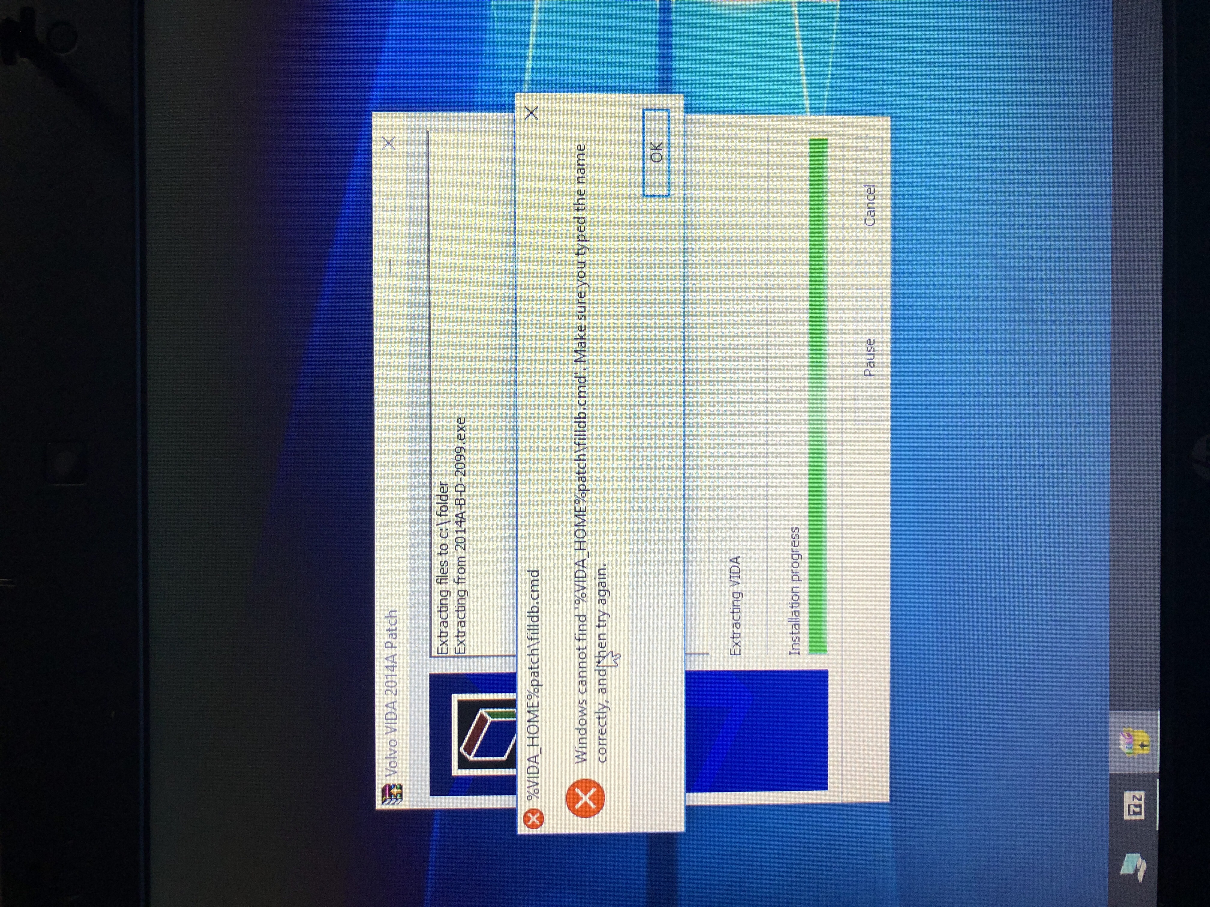

Oh wow I think that is well above me And my computer knowledge tbh. Is there a thread that explains how to download vida etc. tbh I don’t even know what a virtual Machine is..

Check and make sure the data from the DVD is first copied to the hard drive and then run from there, this may sometimes help. Sometimes installer packages get retarded and try to write temporary files to the DVD...
