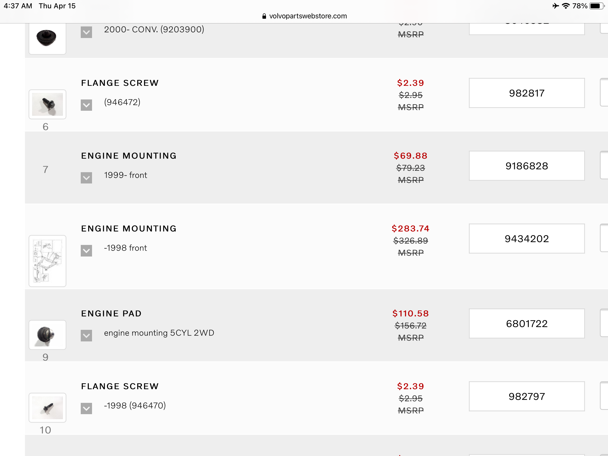

That's very possible that they sent you the wrong rack. Check for any identification stamps/marks on it.

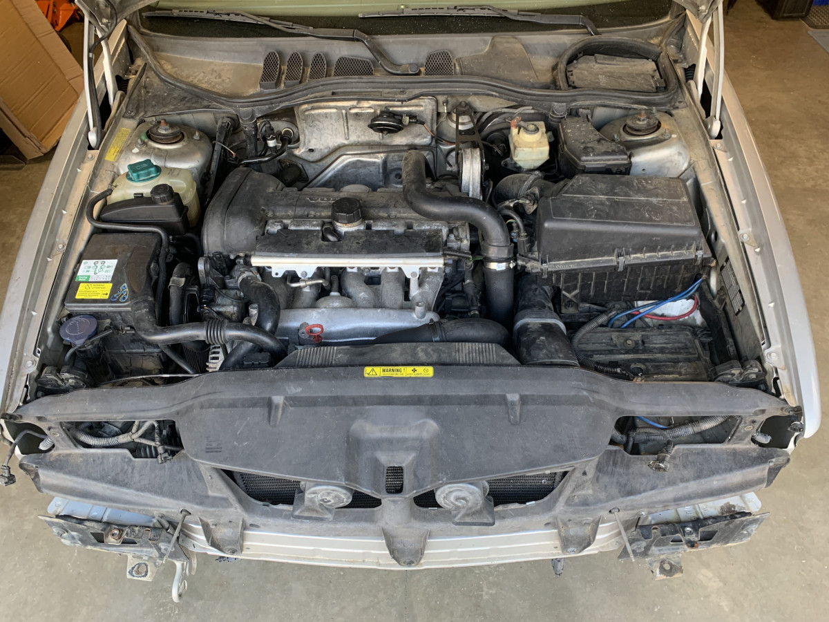

Hate to bump this thread, but I’m pondering the way my S70’s engine sits... it looks to be crooked. It’s been sitting like this since I dropped it in last year, but I hadn’t worried about it until I’m really looking at it again. Am I remembering correctly that you figured this out?
I’m thinking it may have something to do with the passenger side engine mount.

There is a chassis break on the front engine mount , on the passenger side of the car, so if you grabbed one from the parts bin......
Good news is the 1999- one is the cheap one. I think I would stay Volvo here

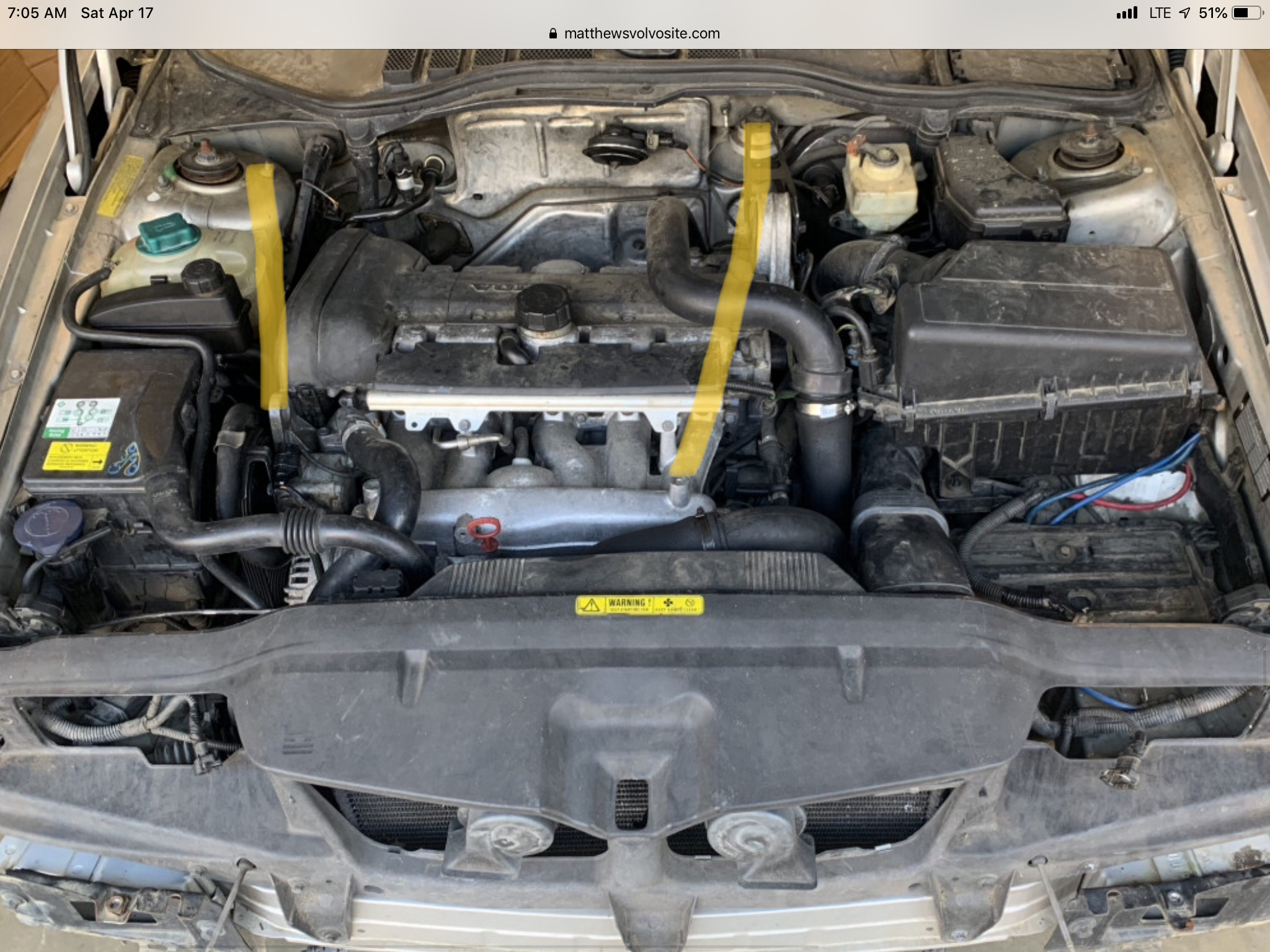

I know it’s subtle, but unless I’m going nuts this engine is definitely askew.

Maybe measure these two distances and I’ll measure on my 2000 to see what’s askew?

That does look off.
A little hard to compare with the current set-up in her car, as we reinstalled the "N" bits, but I don't recall anything being off when we put it back together. I know I wasn't happy to have to buy the more expensive PS motor mount, as we had just installed a new one of the older type a few months before the engine swap.

Yeah, your engine definitely looks to be sitting straight int the engine bay. I’ll check these measurements today.
