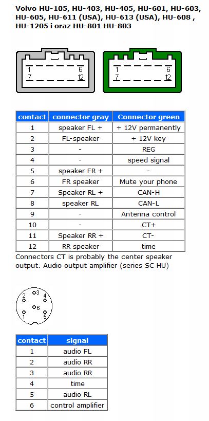

Ok i just downloaded and took a look at those diagrams. Not being picky at all, just not what i expected. That is a very confusing diagram. Basically what im looking for (if i can figure out how to attach the pic) is something like this...
I understand it is a pic of HU wiring for an 01 v70, but that is the example diagram of what im looking for pertaining to the power seat wiring.
wiring HU-XXX more.JPG (73.77 KiB) Viewed 1362 times

Yeah, I can't say I've seen a diagram like that for the seats unless someone has made one. Just follow the colors for each connector for the seats. The second page should show which connector is which, and you should be able to sort of piece it together from there.
Unless of course the wires are different colors from the seat to the vehicle harness connector... I could take a look on my car at some point and confirm.
