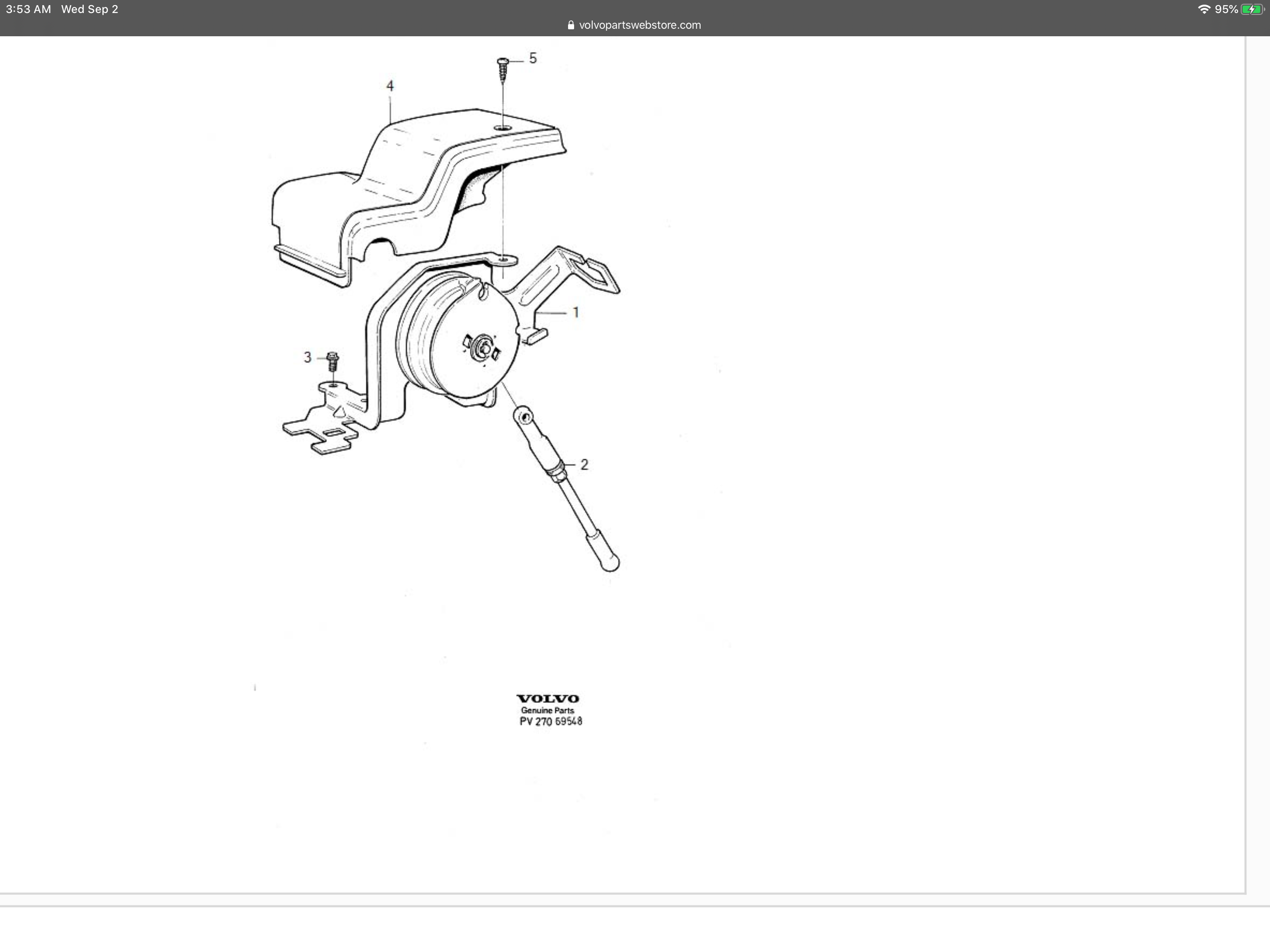

Maybe I’m just putting this on upside down?
I’ll check if the “ head with lock nut” is up it down
Volvo web store shows head up.
