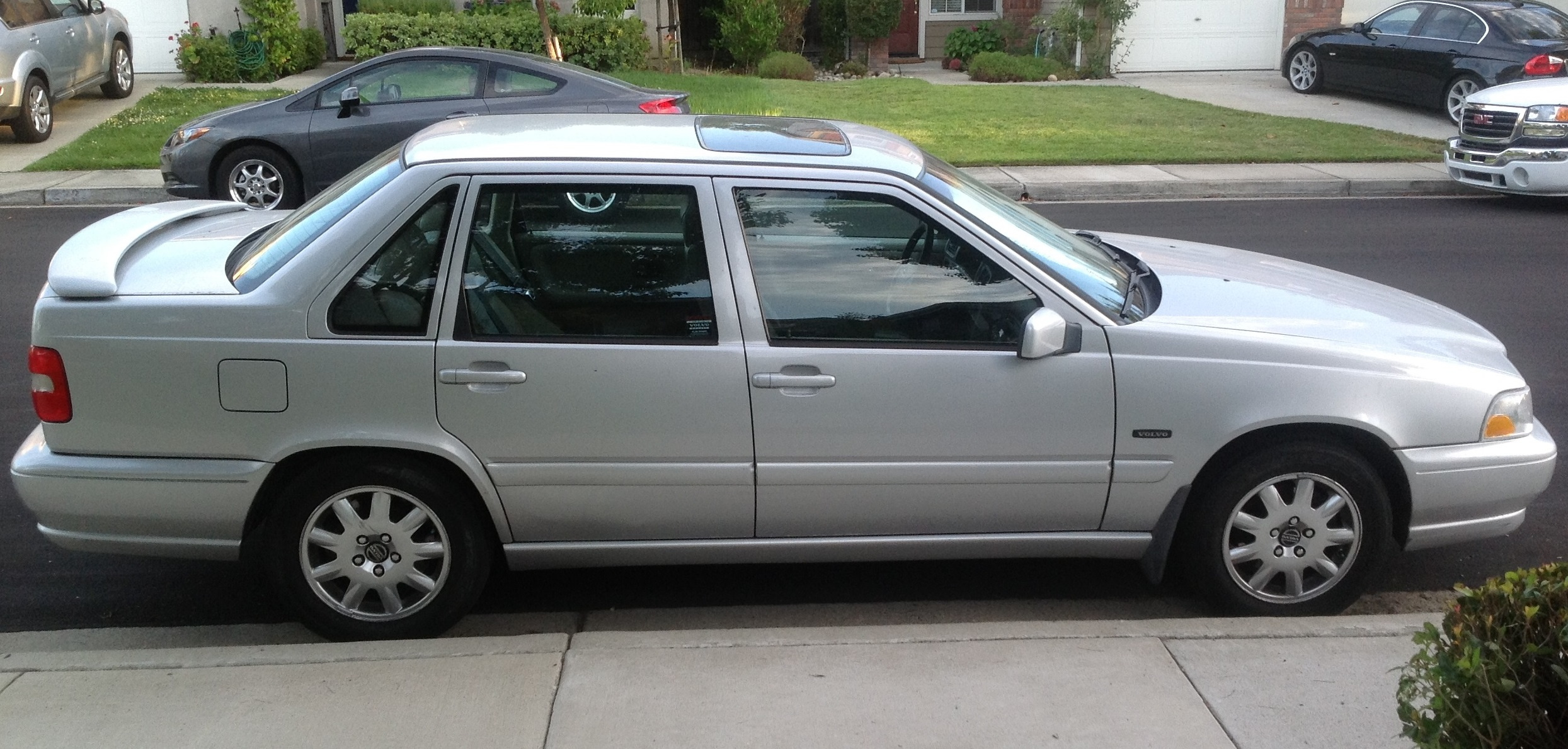

I no longer own this 98 T5. It was purchased with the T5 rims and old tires. Happened to see those 2001 V70 wheel on Craigslist for $300 with Bridgestone's that had at most 2K miles. The young guy purchased larger rims and tires for his V70.850oldschool wrote: 15 Nov 2019, 18:48 I just went from my summer wheels (16" with Goodyear Eagle GT's) to my winter wheels (15" with Michelin X-ice) and the ride is *dramatically* more comfortable.
Those rode on new Gabriel Quick Struts up front and Gabriel rear shocks. The ride was exceptional but it did howl when pushed on and off the freeway ramps. Didn't buy it for speed so enjoyed the sleeper kind of look. Not sure I would like the 16" ride? Didn't care for it with the older 16" tires. Night and day difference.
