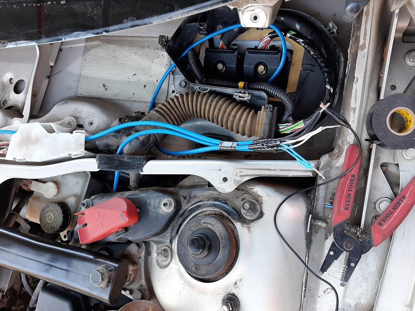

The splice for ABS off the underhood CAN is in the bundle in the cowl with wiper linkage. The twisted pairs of white and green wires make it fairly easy to locate and it is taped. That panel in front of windshield is the access. You can find if you look at the wiring not far from where the harness emerges from inside the car. 99 models have some history with CAN wiring at that underhood splice for ABS on high speed CAN and under carpet in driver's footwell where the harness is under carpet in a flat plastic conduit on the low speed CAN. There is no easy access high speed CAN probe point. The CEM is a good place and you obviousy have CEM bracket experience. The CAN wires are at the OBD plug but on 99-2004 these wires are gatewayed through CEM and are not live unless a signal is being sent by a scan tool on the K line wire that is shown to that plug from CEM to OBD plug. You could use VIDA and then back probe OBD plug also.

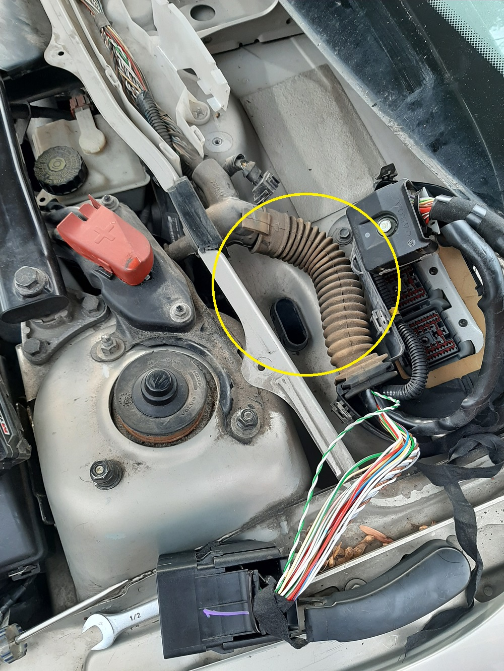

The splice point in the wiper loom eludes me, it must be inside the rubber boot circled in yellow?

Yes, the splice in that boot. You may have to cut it and then wrap well with tape after you've picked it up so you can circle it with tape roll.

There's no evidence of water on/in/near the cem, and everything looks good above it when viewed from the windshield wiper side of things.

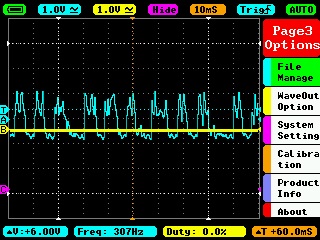

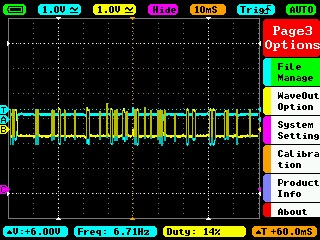

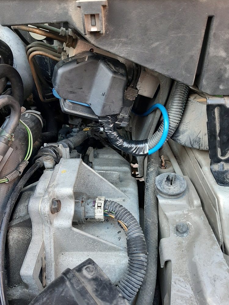

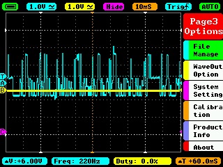

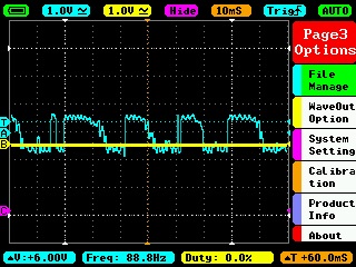

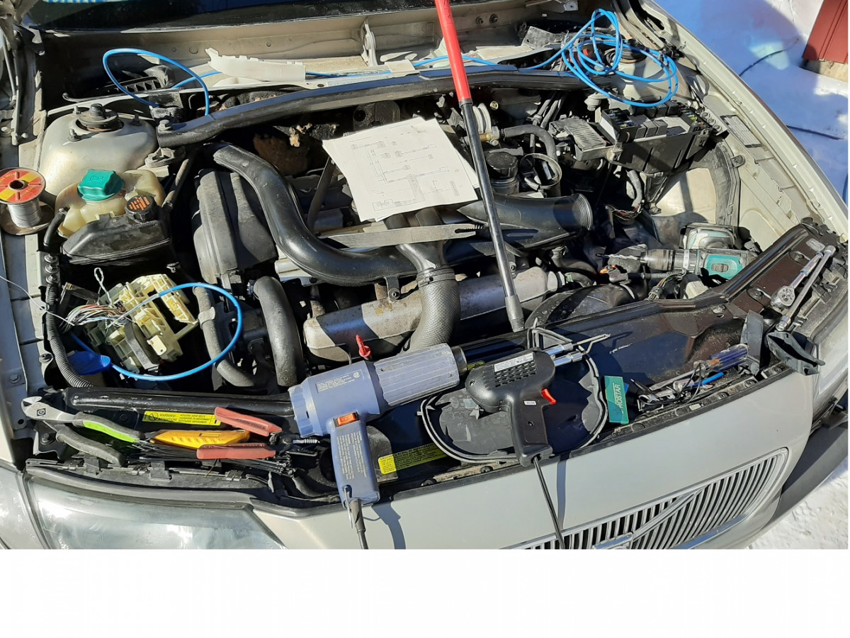

To eliminate the possibility of a bad splice or broken wire I re-wired the high speed canbus from the CEM to ABS and TCM using belden "blue hose" wire, which is a durable twisted/shielded pair used for devicenet in industrial settings, it's has a thousand times better shielding than just a twisted pair. I bonded the shield to ground at one end of the cable only so any induction drains to one end and no ground-loop can be produced. I cut in about 4" away from each module, abandoning the green/white in the loom entirely.
The jumper from TCM to ECM looked fine, plus rang out fine with a meter while shaking/bending the green/white pair, they maintained continuity so I left it alone.
I used a torch tip cleaner to clean up the 6x hi speed can pin sockets at the TCM and ECM plugs, checking continuity as I went, everything is good, same for the 2x at the ABS module. I have eliminated wiring as a possible cause. The joint where the 3 wires connect, (and are bonded to ground) I put my oscilloscope and volt meter on. (CAN HIGH)
White to Ground = 2.3vdc
Green to Ground = 1.8vdc
White to Green = 0.5vdc
Probing CAN HIGH White to Ground:
Probing CAN HIGH Green to Ground:
With the ECM and ABS disconnected: -
With the ABS, ECM, TCM disconnected, so JUST THE CEM, White: Green: -
With nothing hooked up to the CEM on the high speed loop, I reconnect the battery and after a few seconds it goes to BRAKE FAIL on the DIM.
