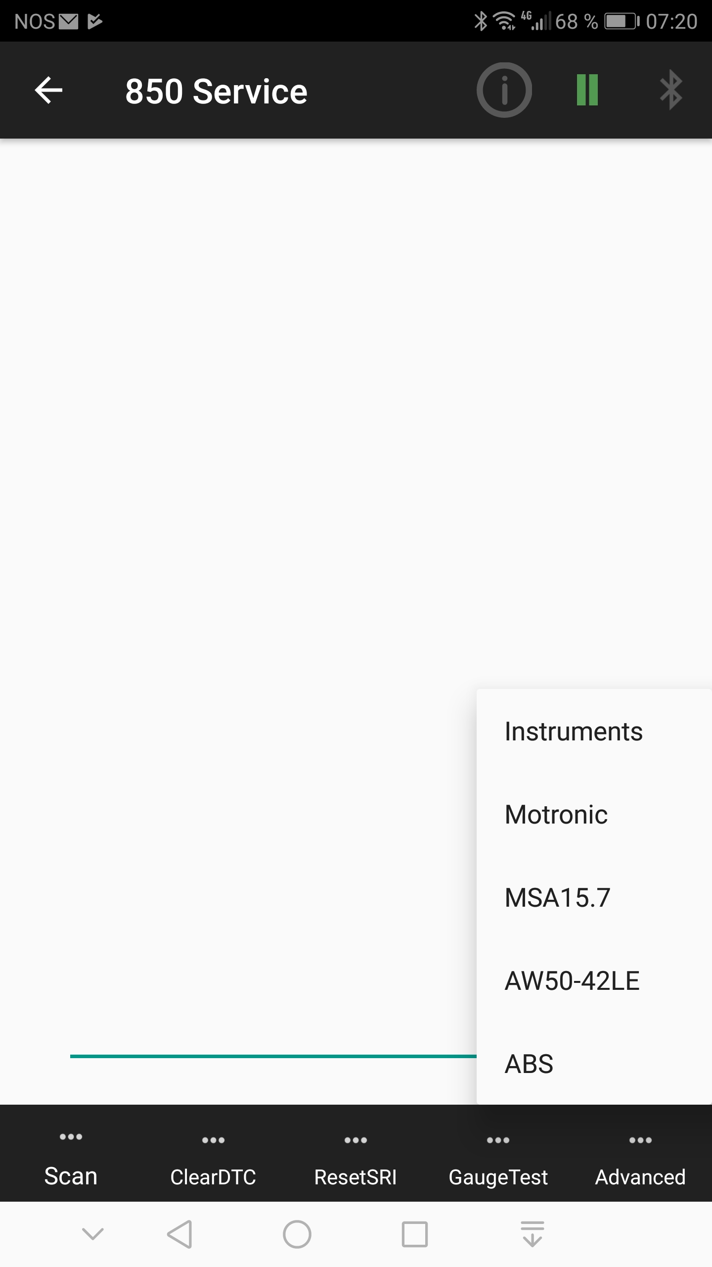

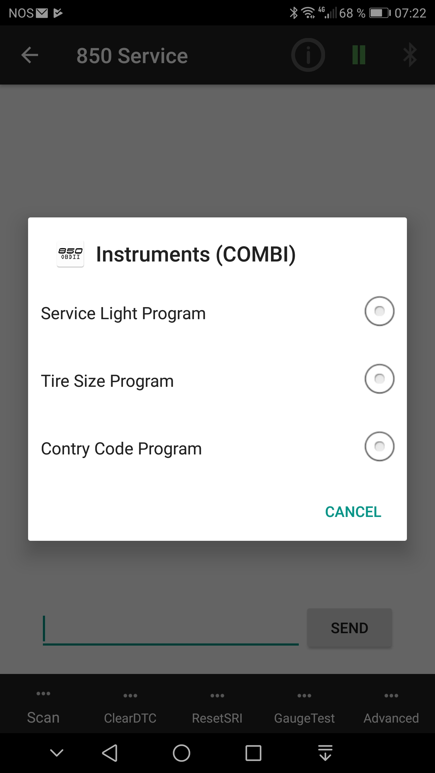

Sorry, Misha, but you are not right about-it, most of what you listed can be done with 850OBDIImisha wrote: 23 May 2020, 16:16 Climate control(ECC),immo2,instrument cluster,transmission,power seats,service light reset and programming it on what mileage to turn on....those can't be accessed with nothing else but original diagnostic equipment....and certainly NOT with generic scan tools or android app.
https://play.google.com/store/apps/deta ... bdii&hl=fr
It is not a generic scan tool, but specialized as its name indicate. (And most of it works with my 1998 S70 T5)
I reset the service light each time I do myself an oil change. And I do can change the delay and mileage.
Too I had changed a solenoid in my automatic gear box, and the DTC was right about the one in failure, reading the gearbox codes..
So... May-be it can help some reader ? It is free and it saved-me A LOT of money.

Seems yes on 850, not on S70
Can it retrieve the "real" mileage?
yes
Can it program instrument cluster...for real?Can it test the instruments?
Dunno/Yes
Can it pair code keys with immo2 box?
NO
Can it read and inspect ECC unit? It should read & clear...but can it operate the dampers of the ECC unit?
Yes/Dunno
And it can test all the components of the ABS: sensors, pump, etc...
Anyway this is out of topic and don' help.
