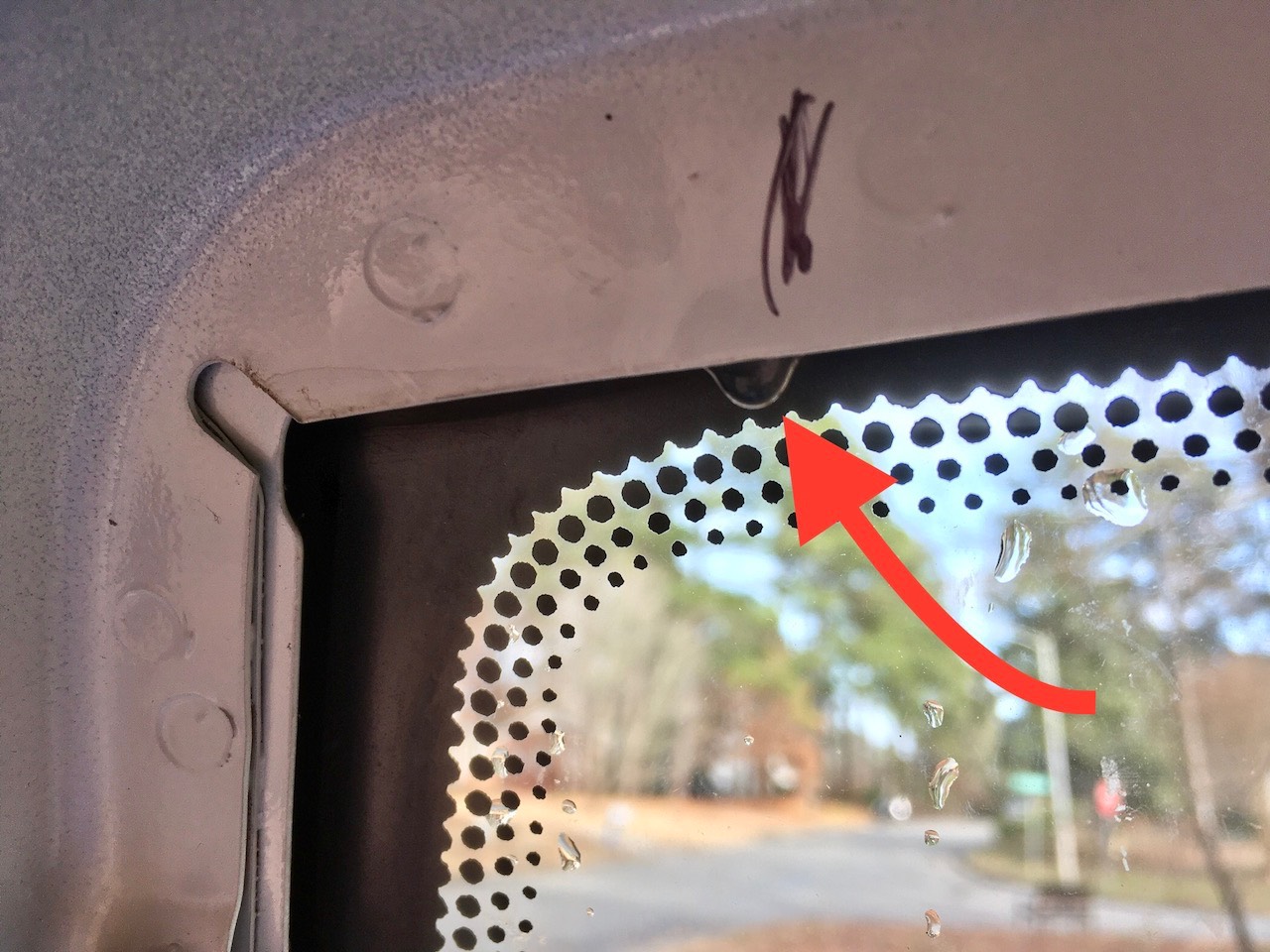

I found a new way that water can leak into the back of the wagon, and fixed it. Took some photos along the way in case anybody else finds water dripping down the trim and wetting the carpet in the tailgate area.
After removing the interior side trim, water drop visible after splashing a little water on the rear roof of the car (red arrow shows droplet hanging from metal).
Interior view, water drop above rear window
Close up of droplet
Close up of droplet

Over the years, the rubber delaminated a bit and failed to seal the hole completely, allowing water to get in.
I sealed the hole with a sealant, reinstalled outer trim strip.
Hole sealed with sealant
We had a couple rainstorms since I sealed the hole, and I verified it's stayed dry.
Just thought I'd describe the leak-hunt and repair in case anybody else is having the same problem.

As you probably know, those are the mounting holes for the roof rail bolts. They are a tar type, I guess, 'self-healing' type material so that when the bolt passes through it, it seals against the threads to stop it leaking. I've seen it leak there on roof rails as they age also.
Thanks for the education and taking the time to write it down. Mush appreciated!
