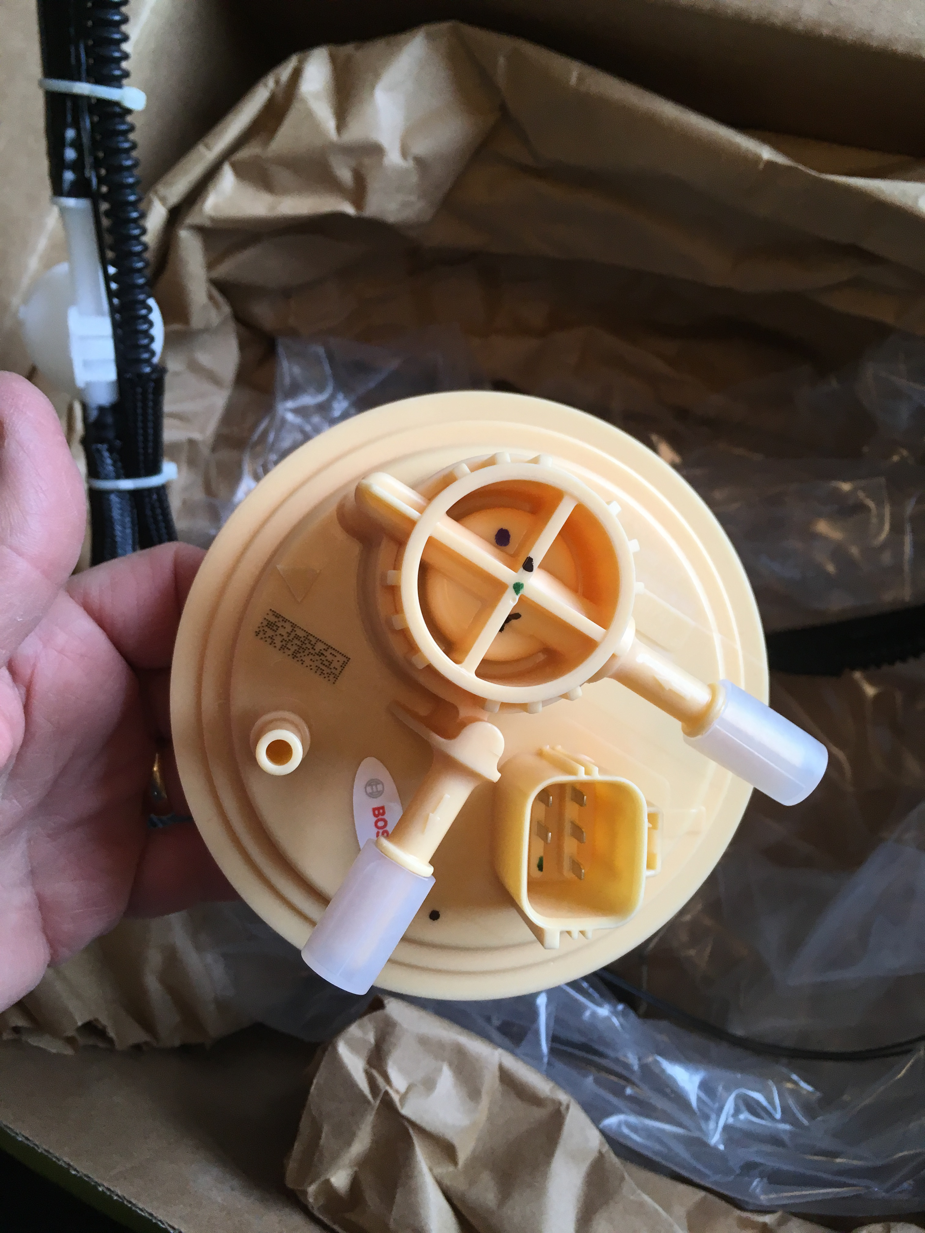

FCPEURO.COM sells everything for Volvo practically and they have a "Lifetime Warranty " on everything they sell and they cover the warranty themselves. I purchased a Bosch Fuel Pump Assembly (assembly comes with everything, not just the actual pump itself), Bosch is the "factory Genuine Volvo " fuel pump with the exception of coming in a Bosch box instead of a blue Volvo box. I'd replaced the retaining nut gasket while I had it apart.

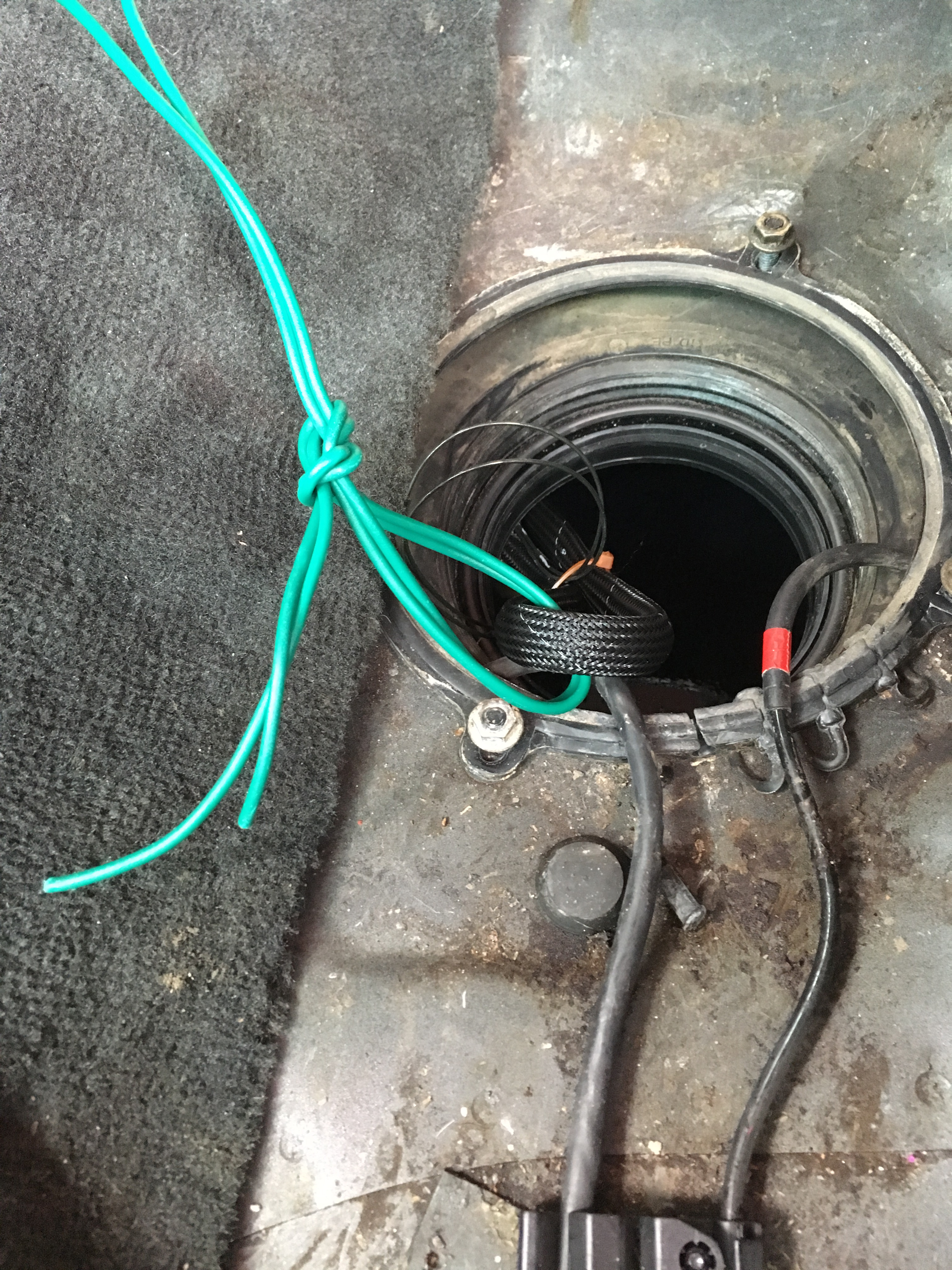

The Bosch pump I bought...

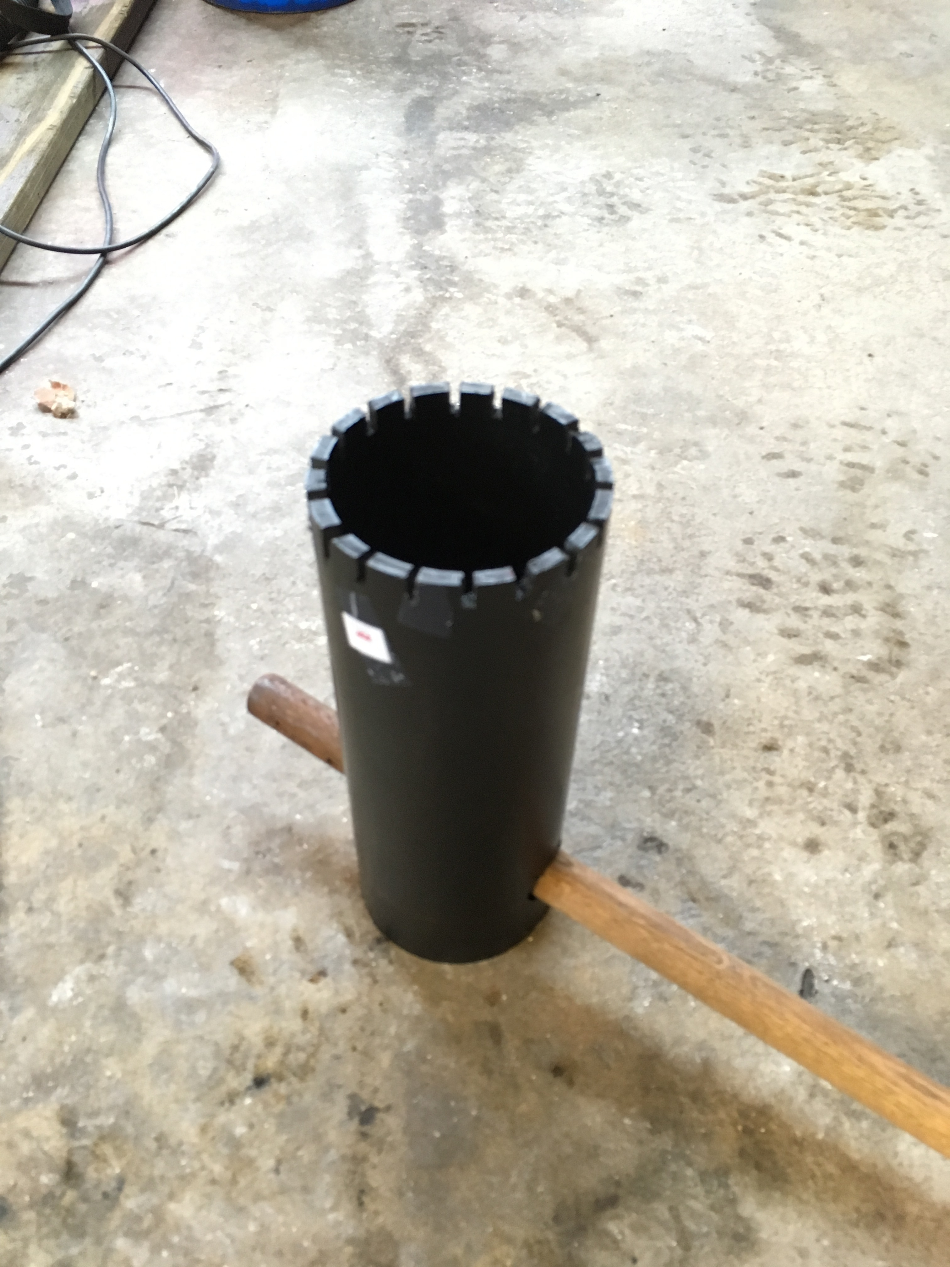

The tool I made from a PVC pipe to undo and retighten the locking collar....
You have to pull the hoses from one side of the tank to the other. I used two heavy wires.

Nice fuel pump ring tool. For the record, what size was the PVC pipe?
- BlackBart
- Posts: 6728
- Joined: 10 Dec 2016, 17:03
- Has thanked: 967 times
- Been thanked: 923 times
It's about 4 1/2" OD, 4" ID. Not a perfect fit, but it gets the ring off.
