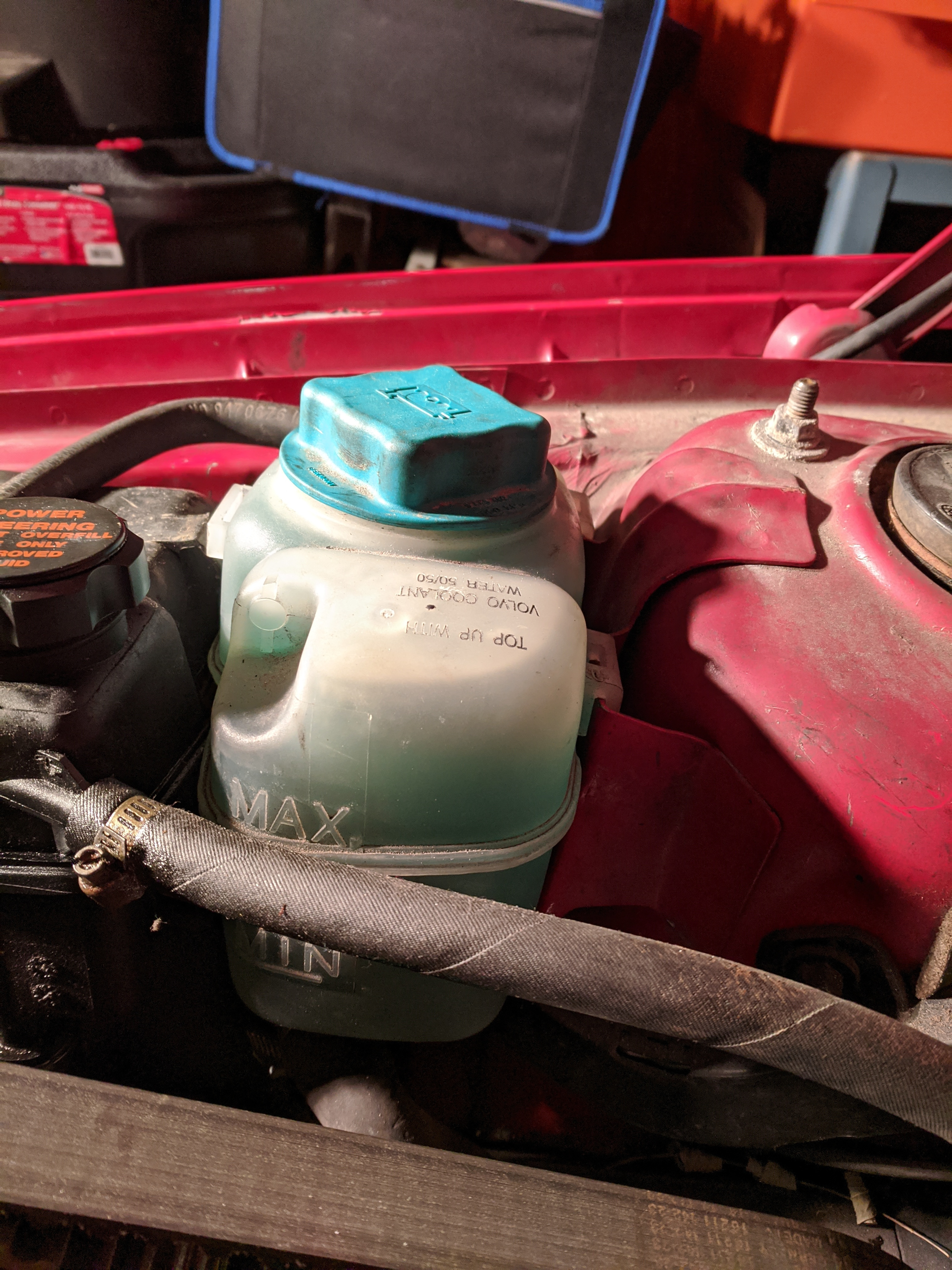

One observation. after car wormed the temp gauge arrow stayed in the middle on the dashboard and the coolant almost reached to the top of the coolant tank . Is it normal ? Before replacing thermostat I drained 2 qts of coolant and when I re added the level stays above the MAX all the time.

If the level is staying the same cold it’s fine. It’s normal for the level to fluctuate during cold, warm,hot running conditions. Check it the same time in the morning so you get a ,reference,

I will check again, but I think level is higher after I replaced the thermostat with Volvo genuine one and refilled the coolant tank. Also seems like lower radiator hose in not getting hot or at list worm. Should right?abscate wrote: 05 Feb 2020, 09:40 If the level is staying the same cold it’s fine. It’s normal for the level to fluctuate during cold, warm,hot running conditions. Check it the same time in the morning so you get a ,reference,

With car cold pull some coolant out to get it to the MAX level. You want room for expansion

When car is cold coolant level drops to about MAX level, so I guess that is fine. Time to chase perhaps vacuum leaks.abscate wrote: 05 Feb 2020, 12:43 With car cold pull some coolant out to get it to the MAX level. You want room for expansion
