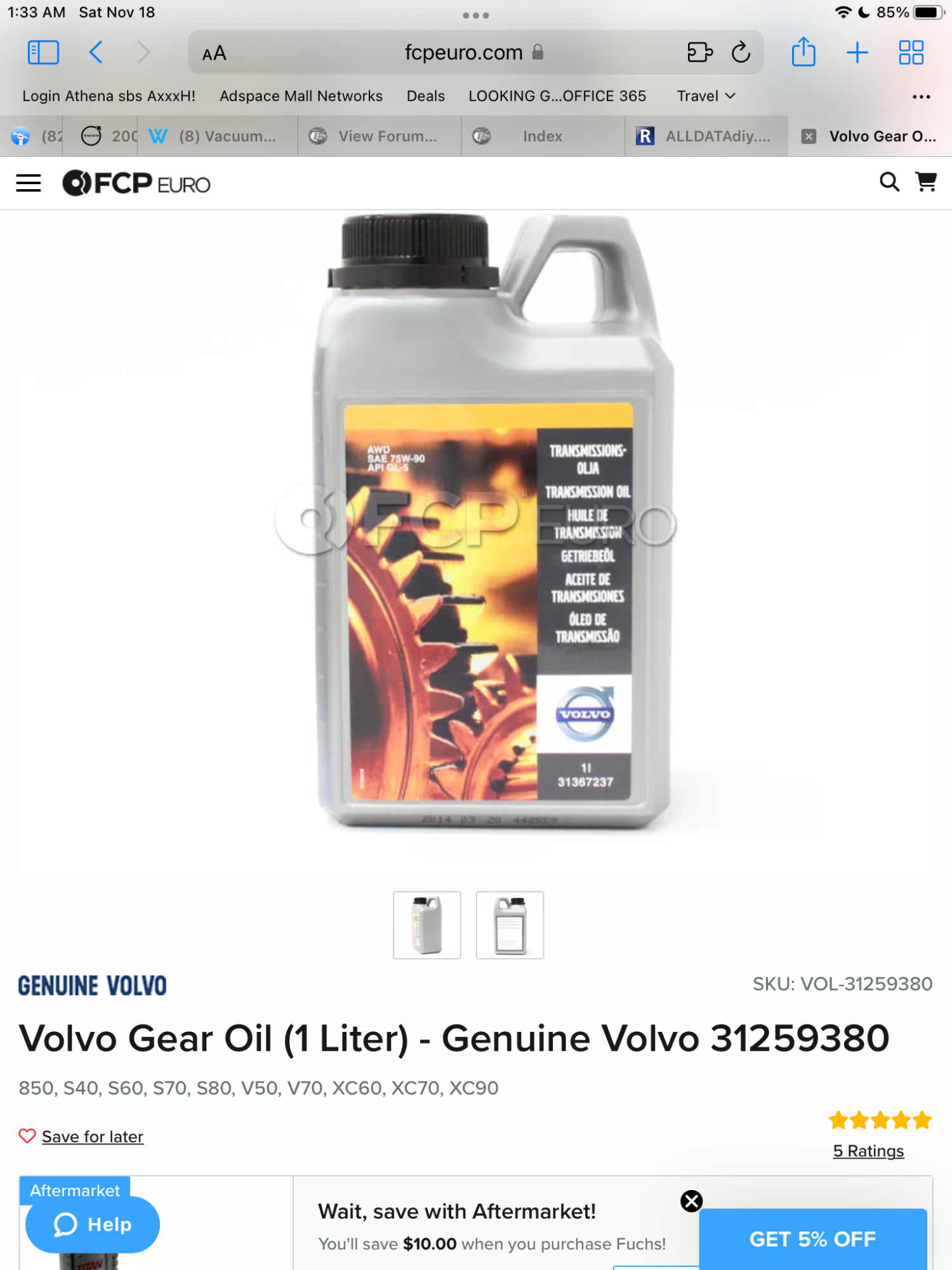

Fcp has it I believe
- Posts: 15506
- Has thanked: 2210 times
For how little you use, and how few times you replace them, just use the Volvo stuff.

Alas they do not, should have mentioned I checked there first. Nor do they show the Volvo product but I could look that up I know ..
