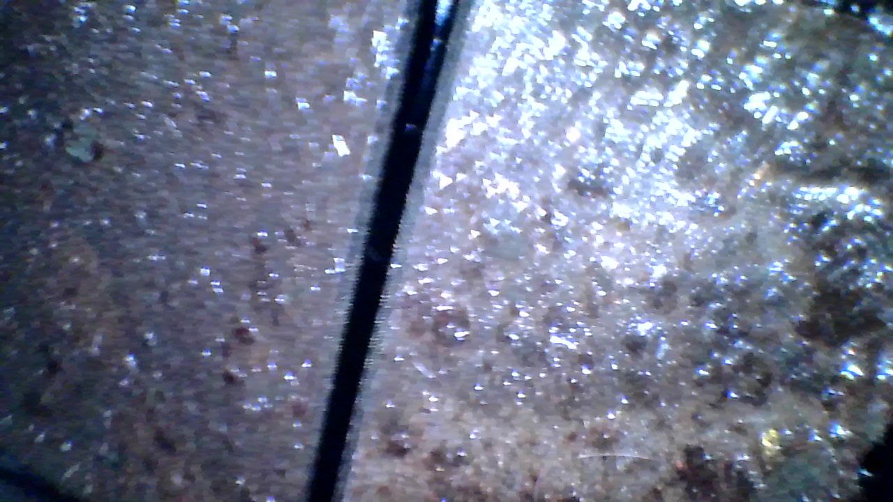

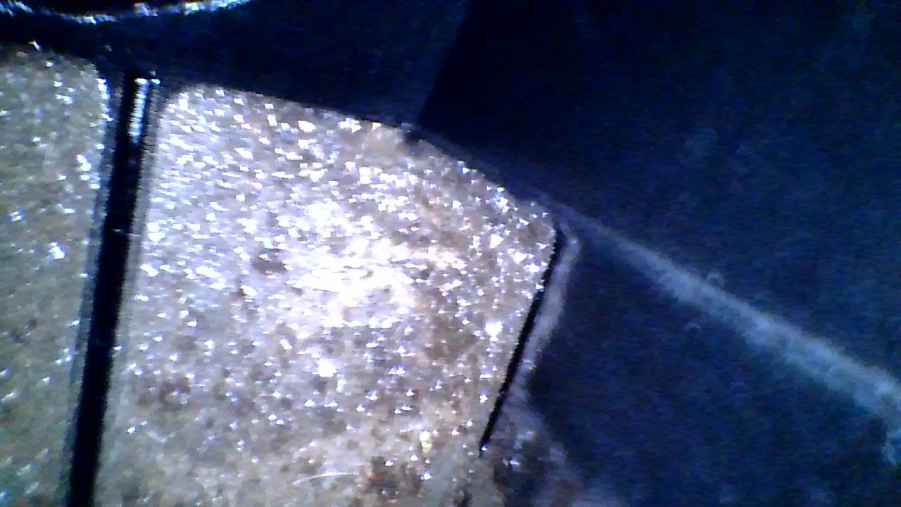

Something to consider to determine the condition of your existing engine is using an endoscope to check for cracked sleeve and evidence of head gasket leak. For $80 you can get one with two cameras; front and side or $40 for the single camera version. I recently bought one to help me determine what's wrong my transmission and what to do about it and I'm impressed with the image quality and the ability to snap photos (or video) while using it. I was able to determine my trans filter is clogged up even though I've regularly replaced ATF and have always used on inline filter that was changed on regular basis.
Through the spark plug holes it's very possible you could better determine whether to replace or keep the current engine without tearing it apart. Would recommend getting the one with the second side camera.
This is the one I purchased and I've attached a couple of photos captured while using it.
DEPSTECH Dual Lens WiFi Endoscope
I also have a plan how I'm going to clean my transmission filter and I'll be able to find out how well it works out using the tool.
