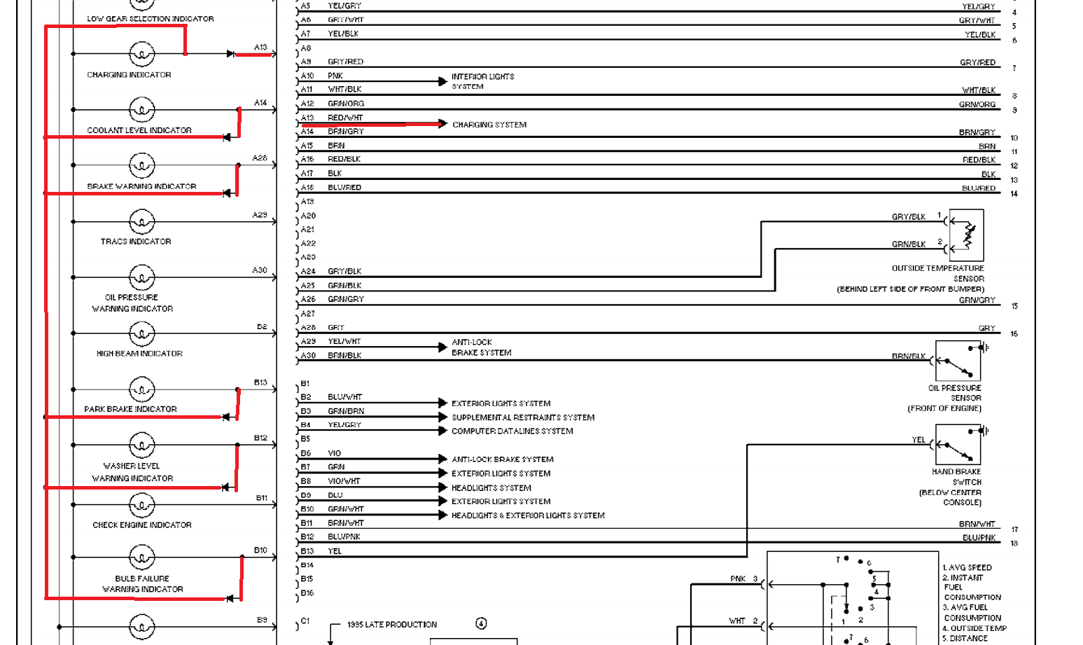

Yesterday I replaced the knock off RPM sensor with an OEM sensor. There is no change from doing it, CEL still comes on during hard acceleration, but im glad i swapped it out, doubt the knock off would last much longer. Maybe I just need new spark plugs? Theyre coppers and im pretty sure ive been running them for at-least 10K.
As for the cluster, its not defective
. I did however figure out why the key-on lights don't come on! When the battery/charging light comes on it will also turn on most of the dash warning lights, which would also explain why the key-on lights come on if the alternator belt snaps. (pic below). So my battery light isn't getting a signal from the charging system, which doesn't bother me yet.
EDIT: The alternator signal wire was disconnected, now my dash shows all the warning lights when in position 2. Still have a CEL on acceleration though.

It should...because if the warning light doesn't work...your alternator will not have output.
The light works as "awakening" for alternator.
EDIT...i just saw that you re-connected the wire.

That would definitely explain why my headlights would be dim until i started driving.misha wrote: 14 May 2020, 09:07 It should...because if the warning light doesn't work...your alternator will not have output.
I've drove about 150 miles total sense the reset, the coolant sensor is only about a year old and I re-did the connector wiring when I replaced the sensor.Chuck W wrote: 14 May 2020, 13:24 How long have you been driving it since the battery disconnect?
