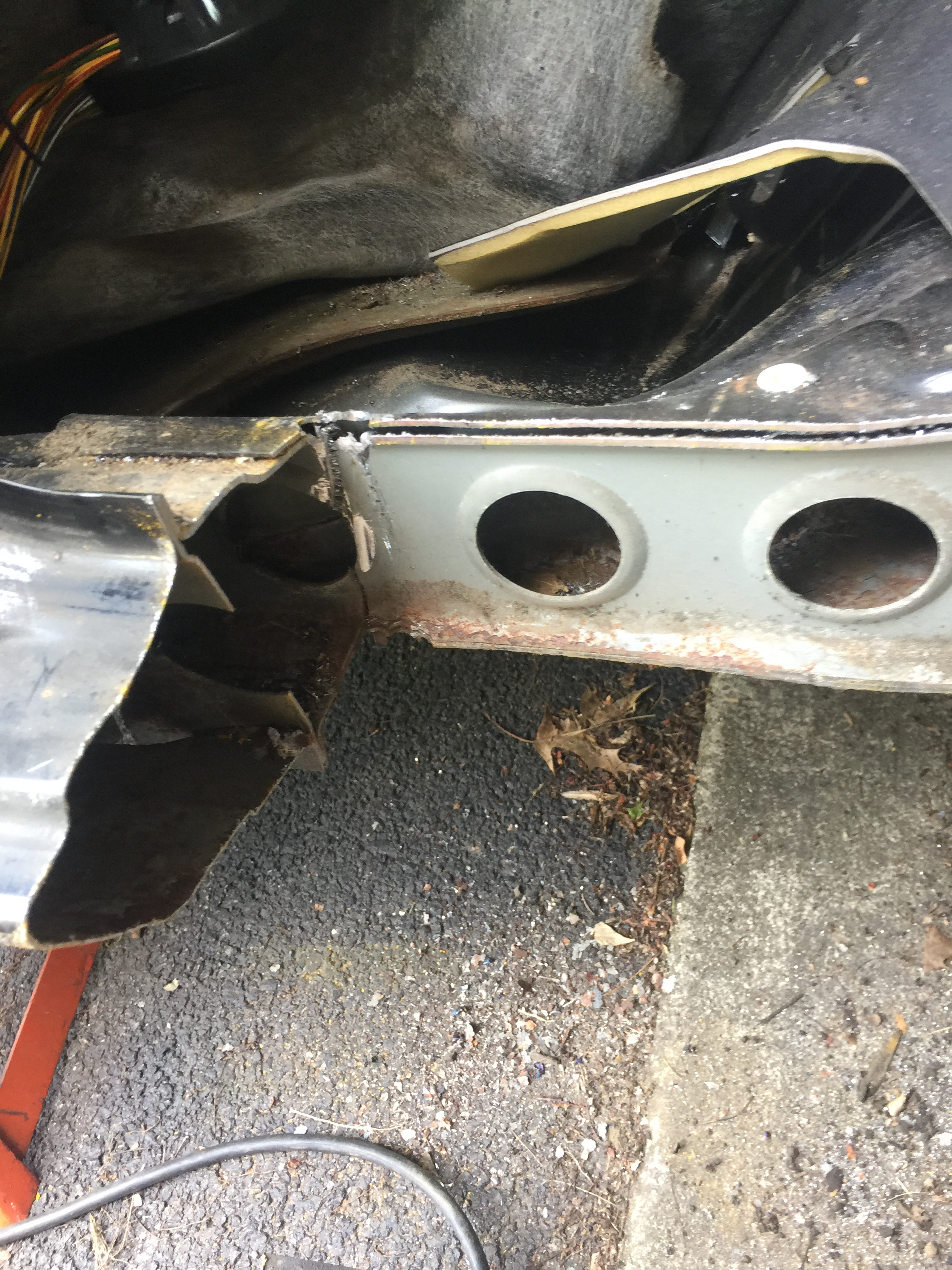

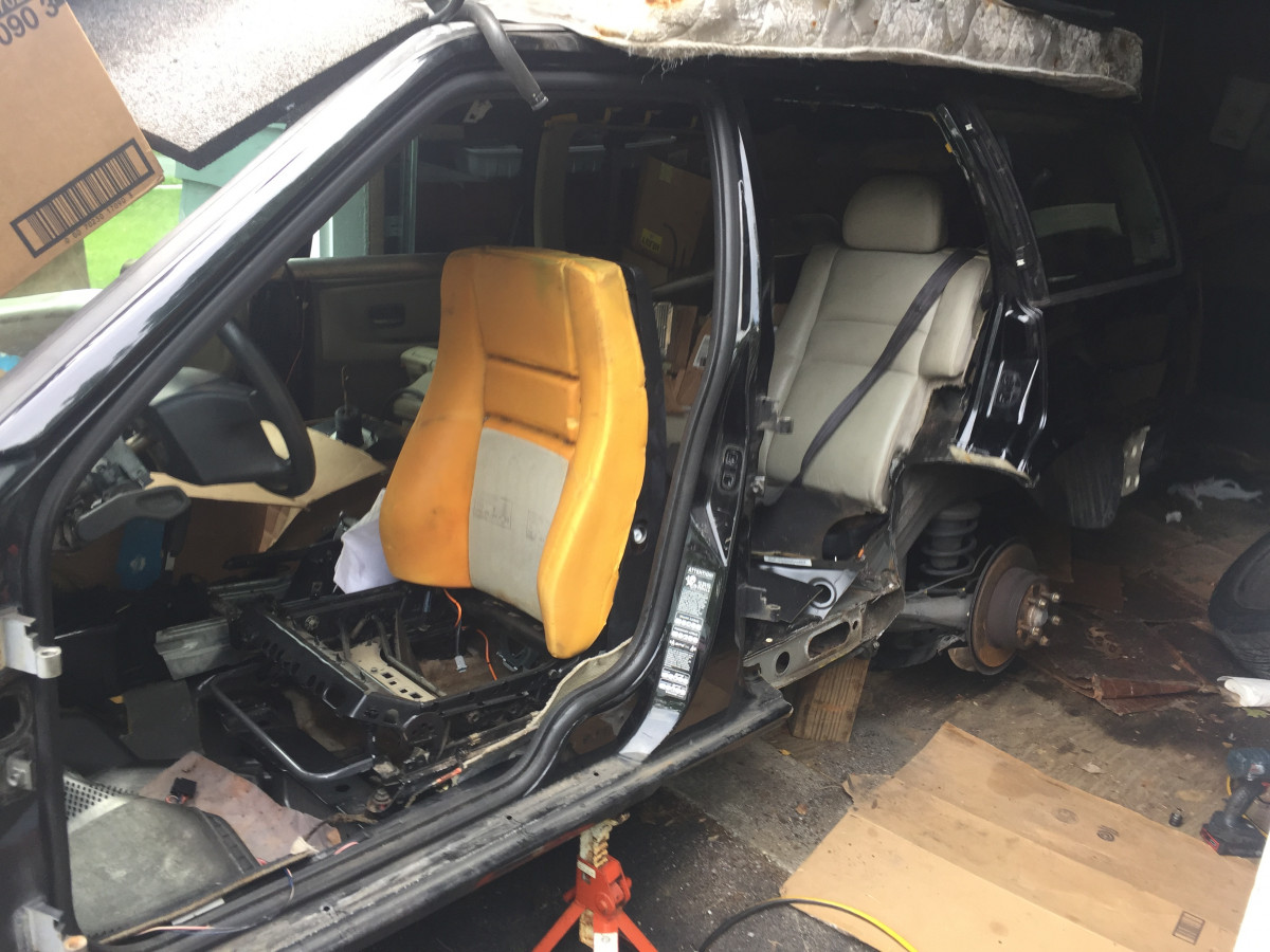

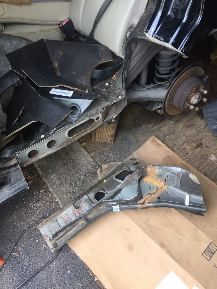

abscate wrote: 03 Jul 2020, 03:39 There is some massively thick steel and framemembers in the back corner near the rear door.
It’s going to be a ***grind****to get through those
P80 harvesting left passenger rocker panel

Methodology
Bosch Corded sawzall with 12 inch Dewalt metal blade. Used one blade
It sounds like......Victory..
Methodology

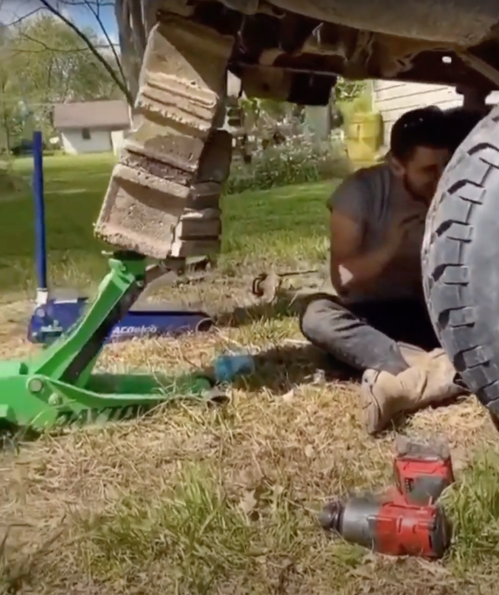

Hey, that doesn't look like a Harbor Freight jack stand under there!
- Posts: 36137
- Been thanked: 4063 times
There was no way I was going underneath this car while I was cutting frame members. All bets are off when you are cutting support structure to the underbelly.
I cribbed the back axle with lumber, and had jack stands under the rocker, but the first line of defense was no body parts, including feet, ever went under the car during this.
Hey - in your pic, is your pawl lock bar all the down? Mine sit lower than that, and that is important for full pawl engagement.
Im going to try harvest a passenger floor piece from this car, but that will also be from up top, where my biggest danger is a 6 inch fall.
Don't be this guy
Don't be this guy

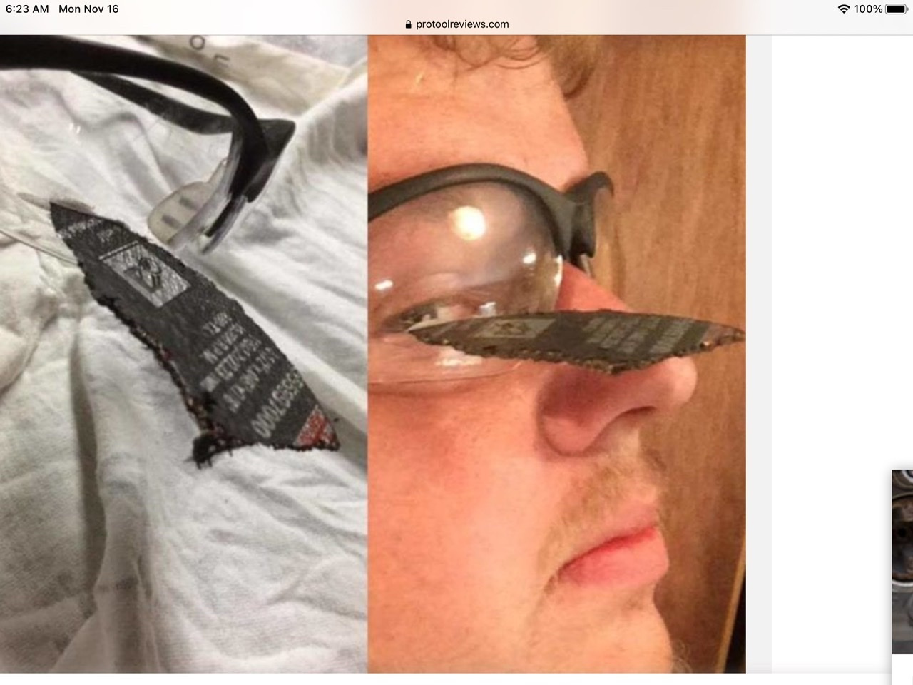

There is nothing cool about getting hurt working on your car, either short term or long term.
Full face shield
Glasses
Heavy leather gloves
Good shoes
Ear muffs.
Grinders and Sawzall blades can fly stuff off with high velocity
Be safe out there. Here’s some motivation for the visually oriented....
