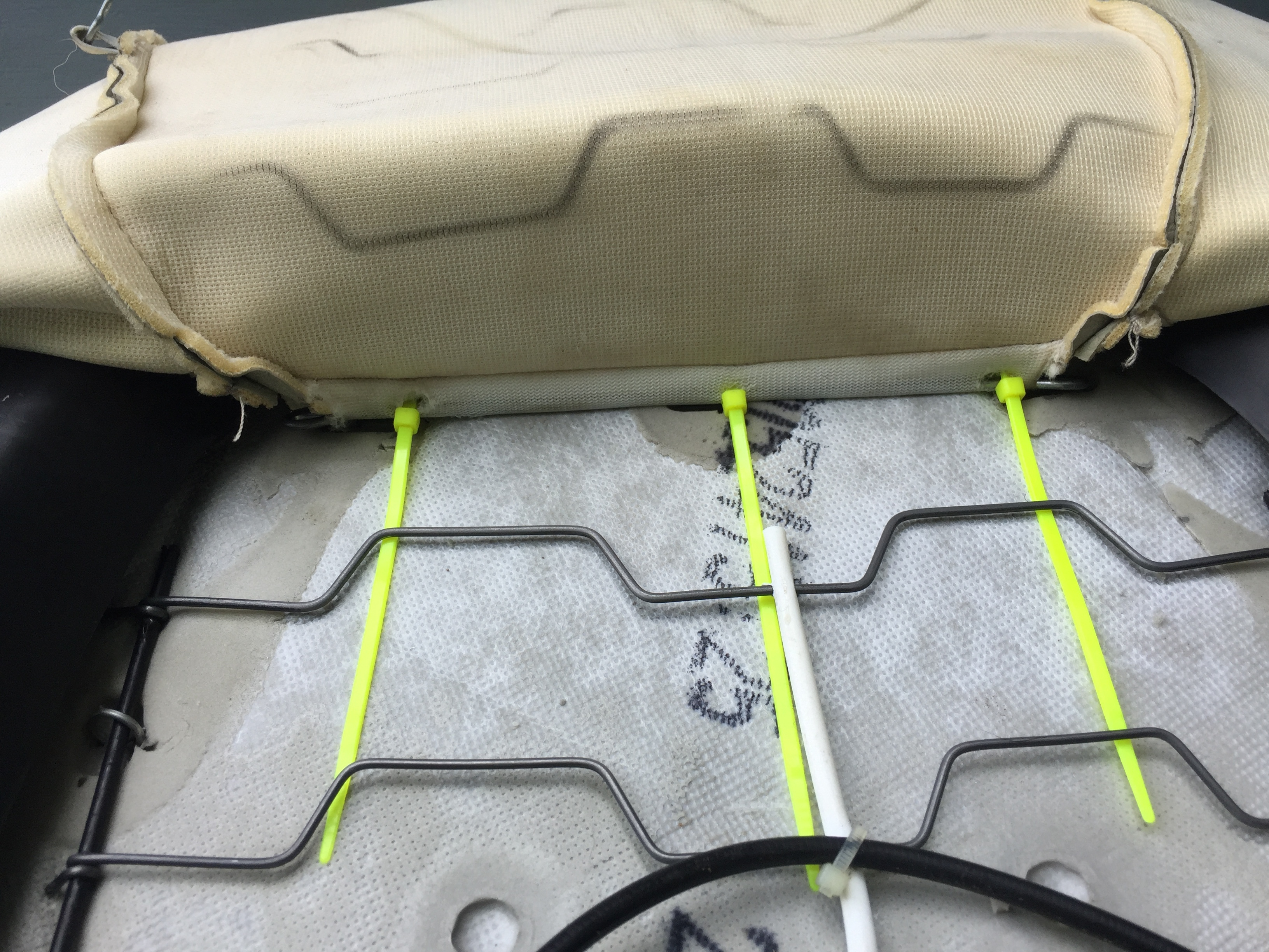

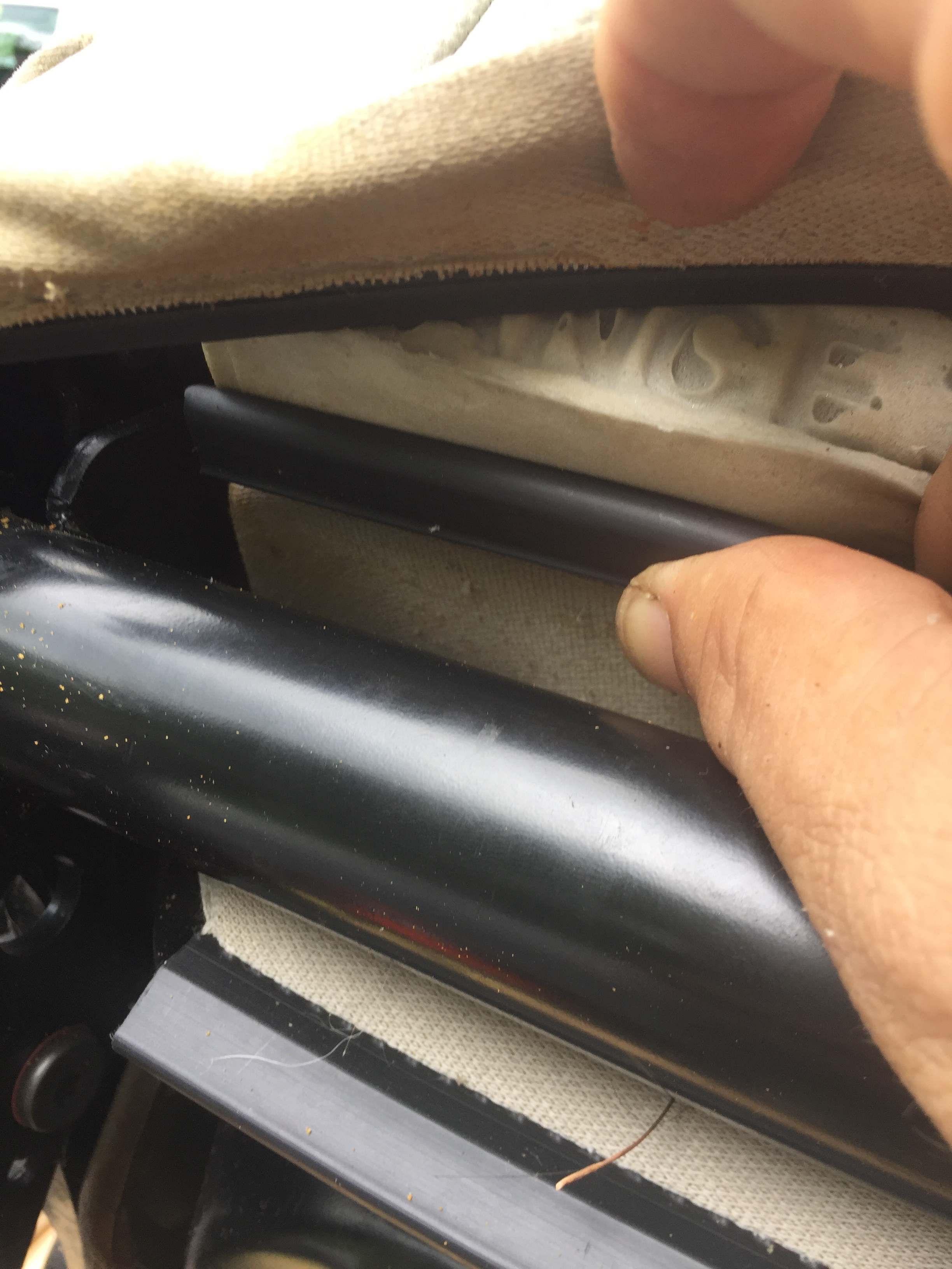

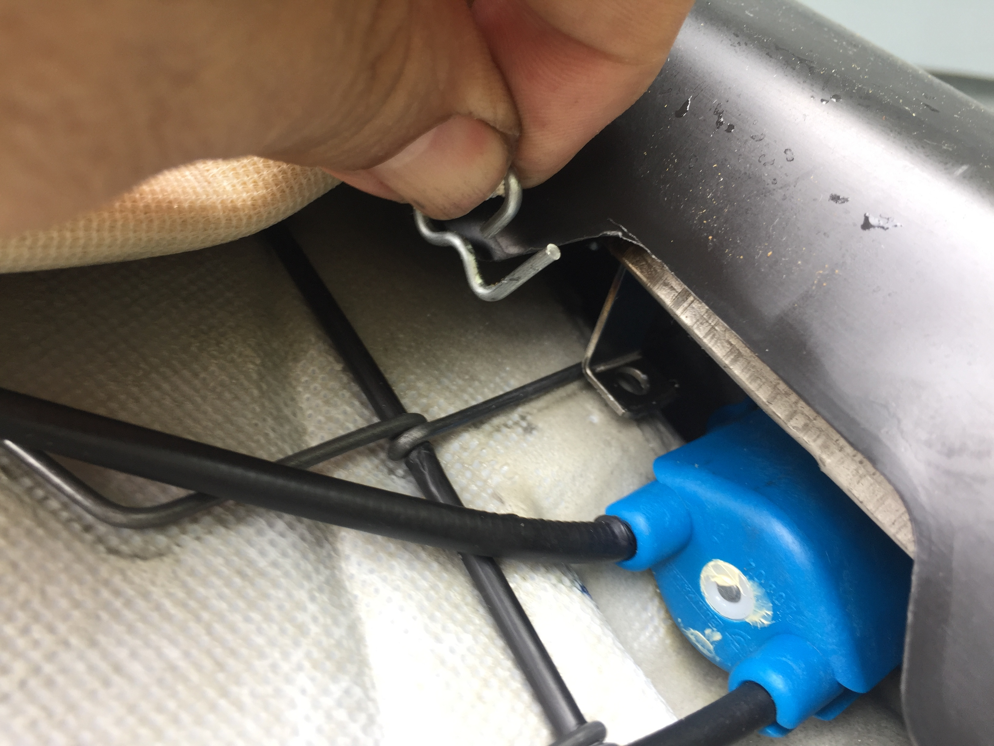

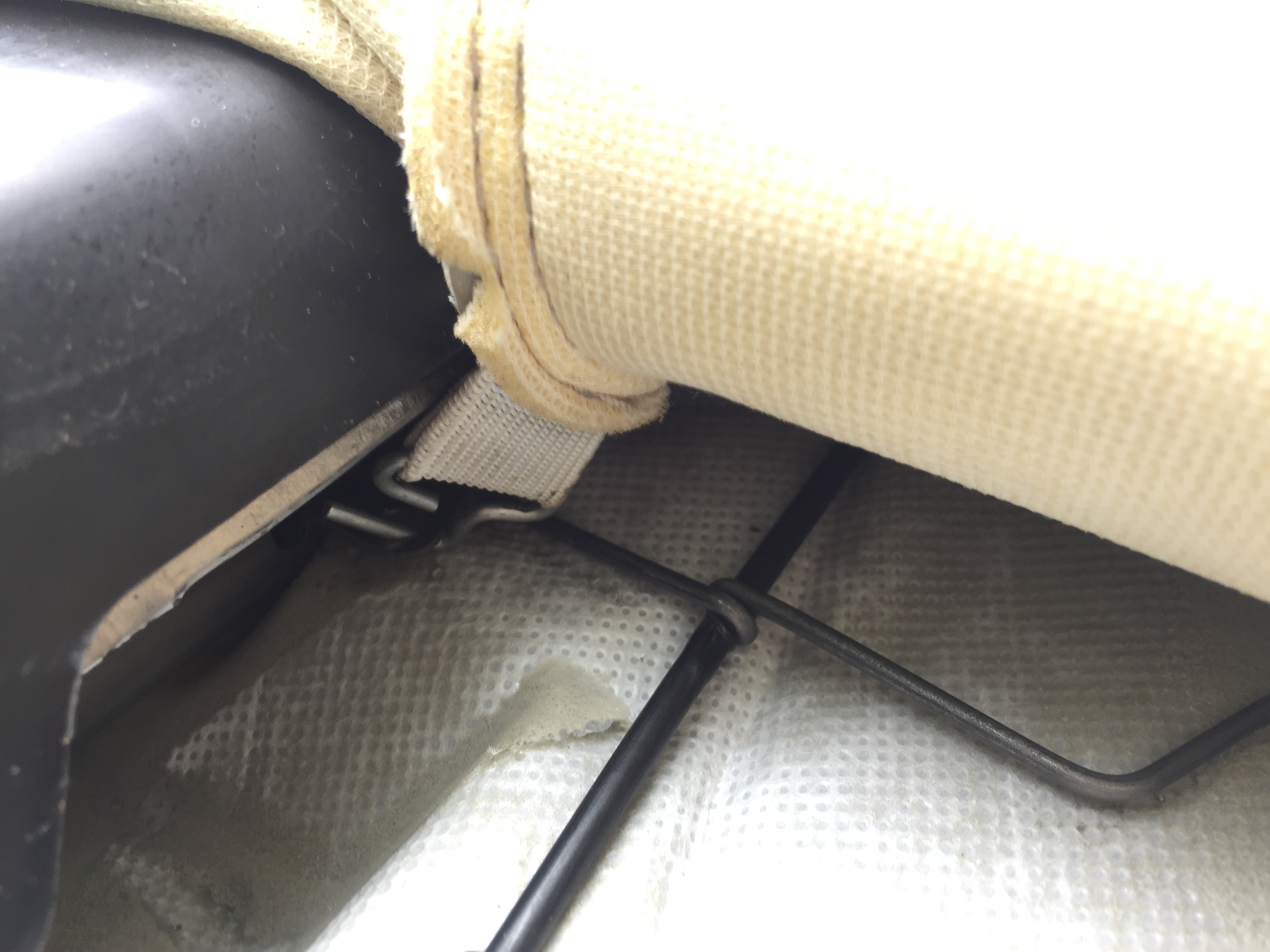

Stiched, ziptied, and reinstalled.
P2 2005 V70 upper driver seat skin repair 39897761
- Posts: 36142
Comfortable Arena... missed that one.

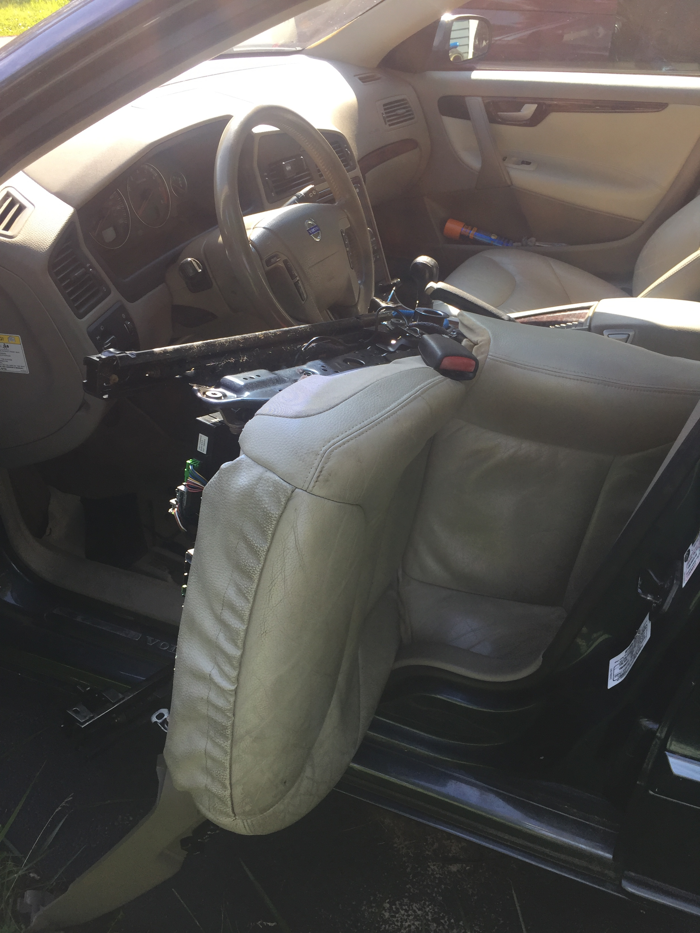

Wrapping up this thread

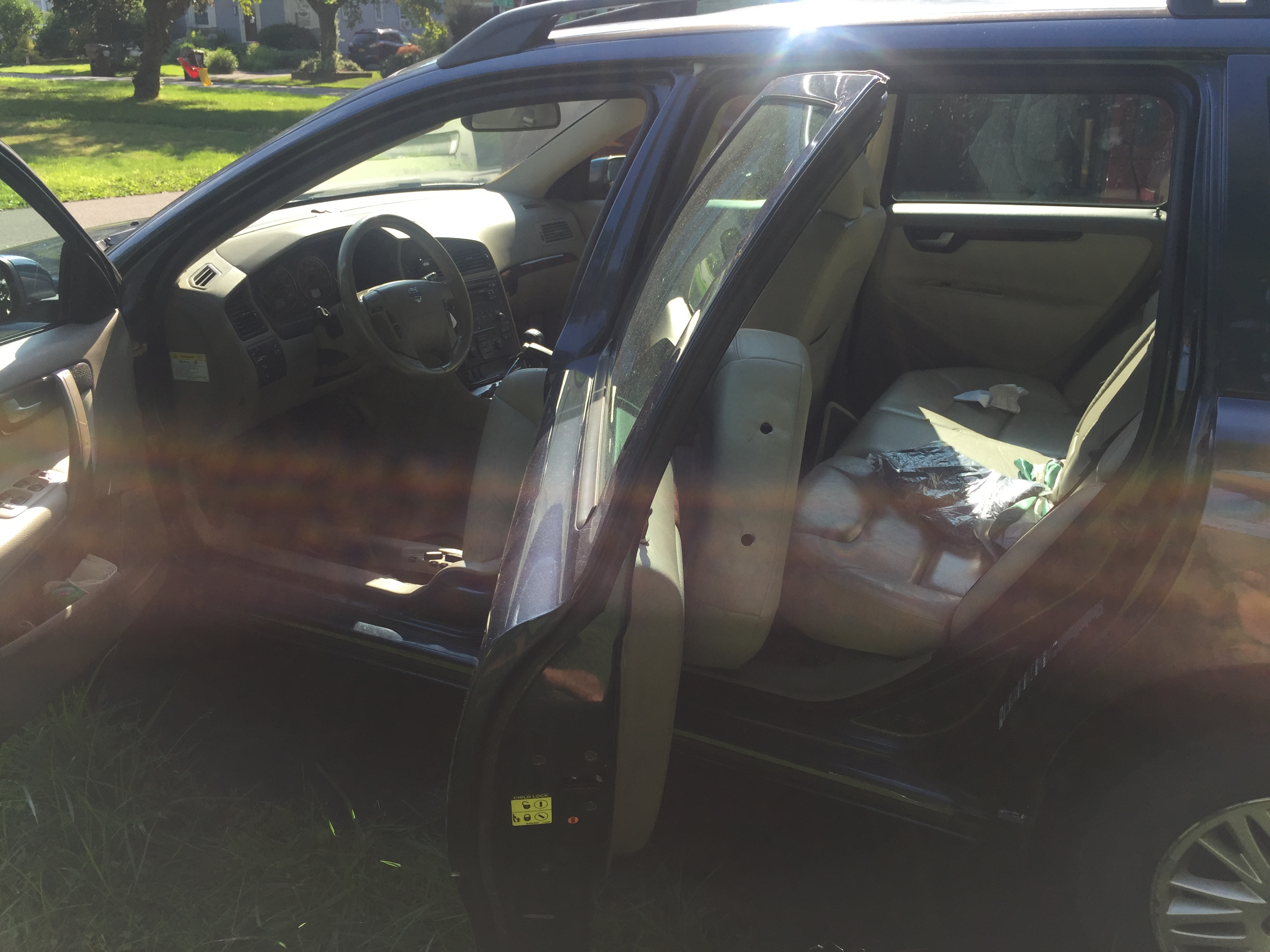

Here is the one person way to put a front Drivers seat back in a P2 without scratching anything
Open both front doors driver side doors
Seat goes in on its outer side down
Bring back rest to rear door, pivot seat up to mount position
Bring seat to mounts in correct configuration
4 m8 Bolts, 14 mm hex

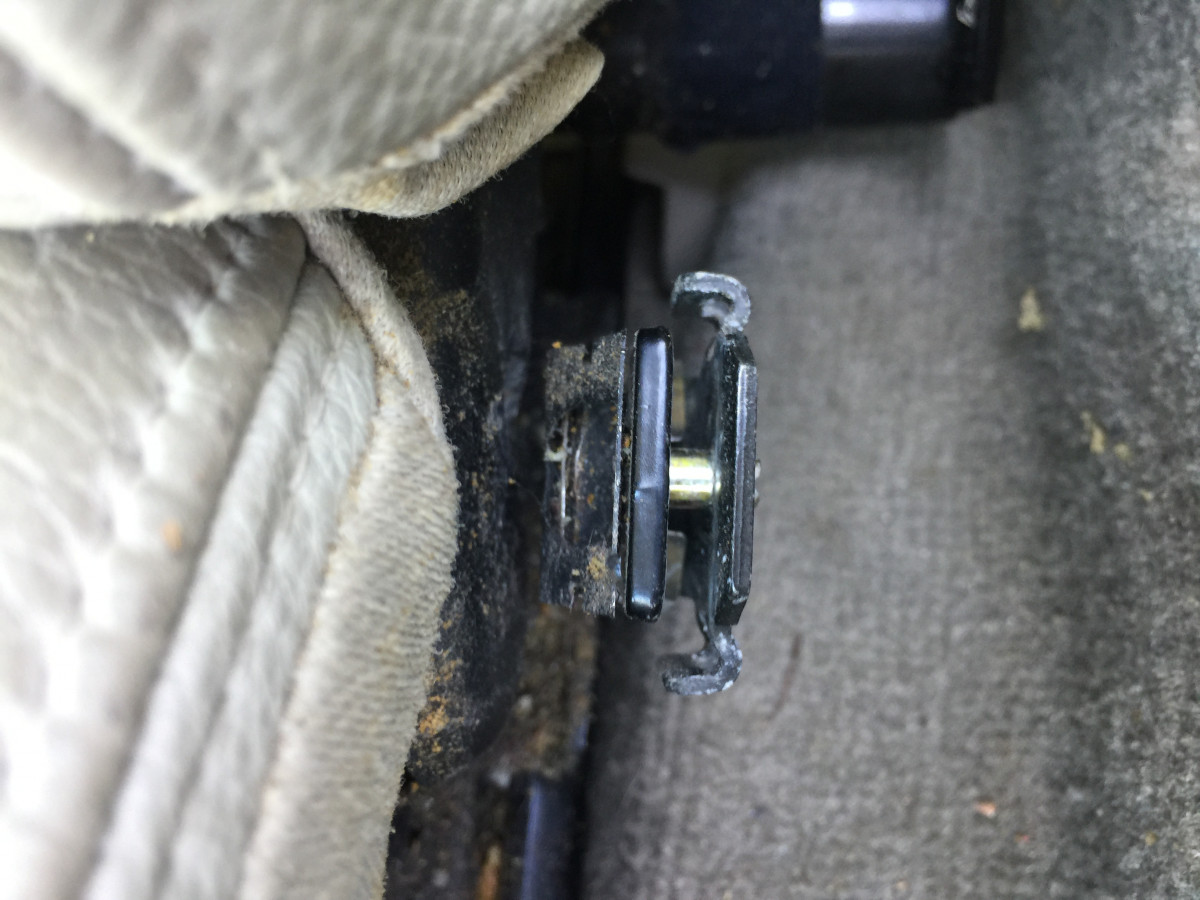

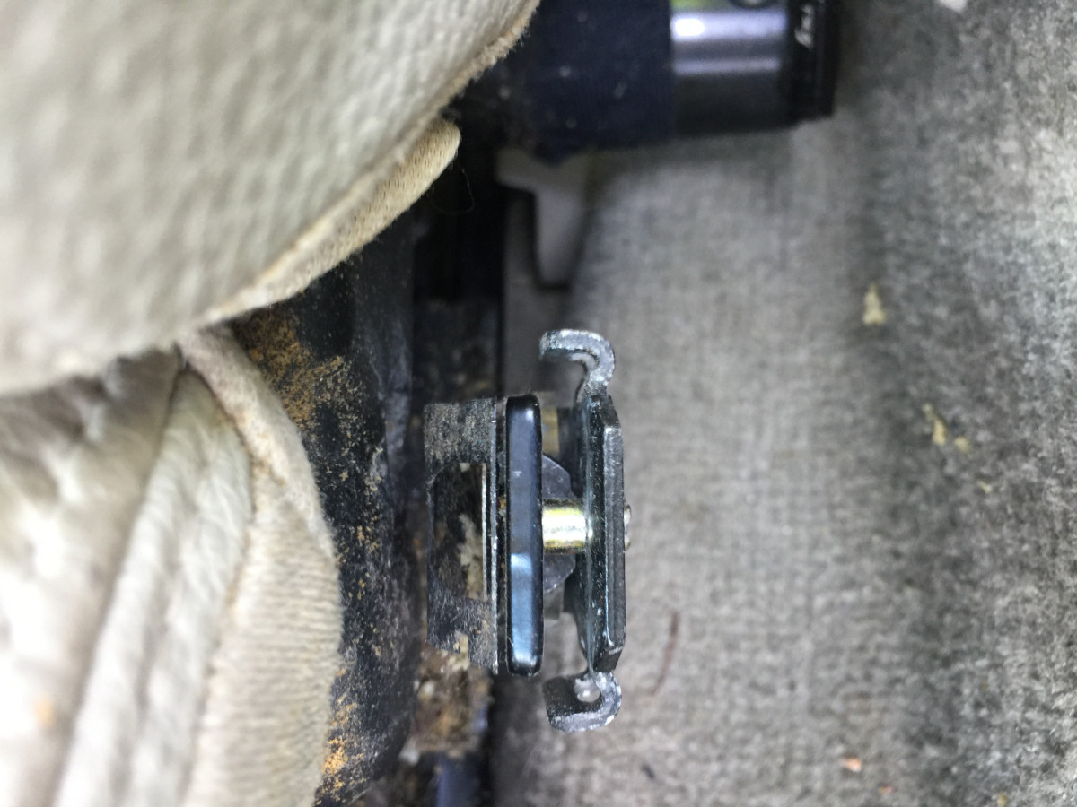

Watch out for this
My Showell clip hung up and didn’t engage the seat belt correctly, make sure the tab picks up the seat belt with a firm tug upwardsd

Did you mean open both front and rear doors on the seat side of the car?abscate wrote: 13 Jul 2020, 14:05 Wrapping up this thread
Here is the one person way to put a front seat back in a P2 without scratching anything
- Posts: 36142
Yes, apparently my head was still breathing in leather cleaner!volvolugnut wrote: 13 Jul 2020, 14:55Did you mean open both front and rear doors on the seat side of the car?abscate wrote: 13 Jul 2020, 14:05 Wrapping up this thread
Thanks for correcting.
