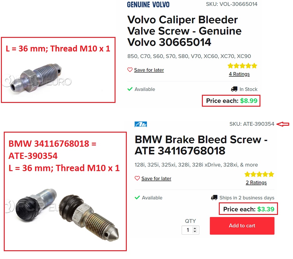

- Since ATE makes brake calipers for Volvo, BMW, Mercedes, VW, Porsche etc. etc.
- Volvo PN 30665014 has a dimension of L = 36 mm; thread M10 x 1.
Current price is ~ $9.00/each!
- BMW 34116768018 is basically ATE-390354 and also has a dimension of L = 36 mm; thread M10 x 1.
Current price is ~ $3.39.
- If anyone in forum buys ATE-390354 and installs it sucessfully in the Volvo, please report back.
This is bc if you refresh these bleeders x 4 every 8-10 yrs, it is good to have a source for identical item for much less.
BONUS: the ATE-390354 includes the rubber cap.
The Volvo PN above does not include the rubber cap!
