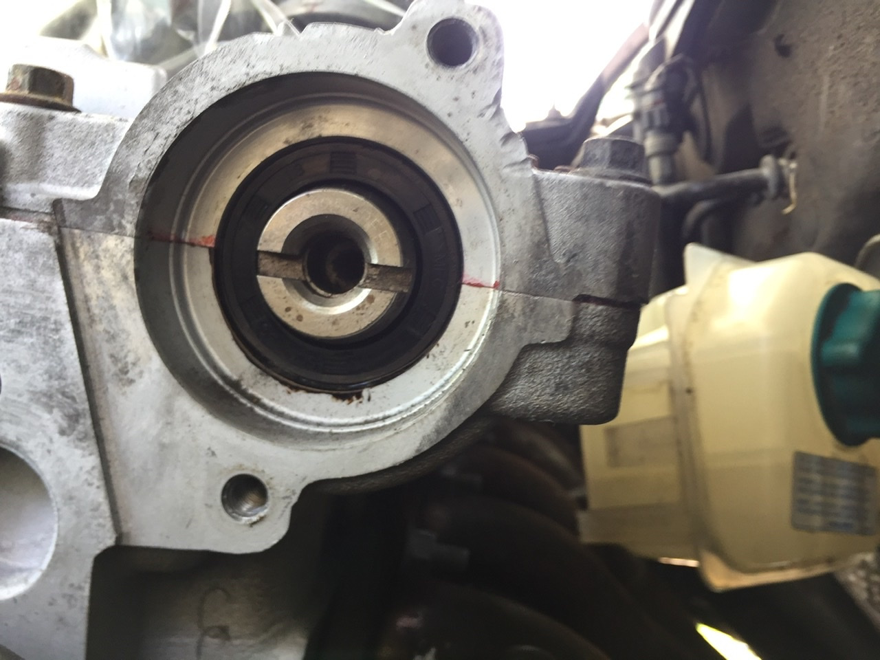

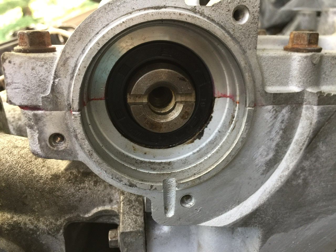

Confirmed that I put the cams inthe right place
