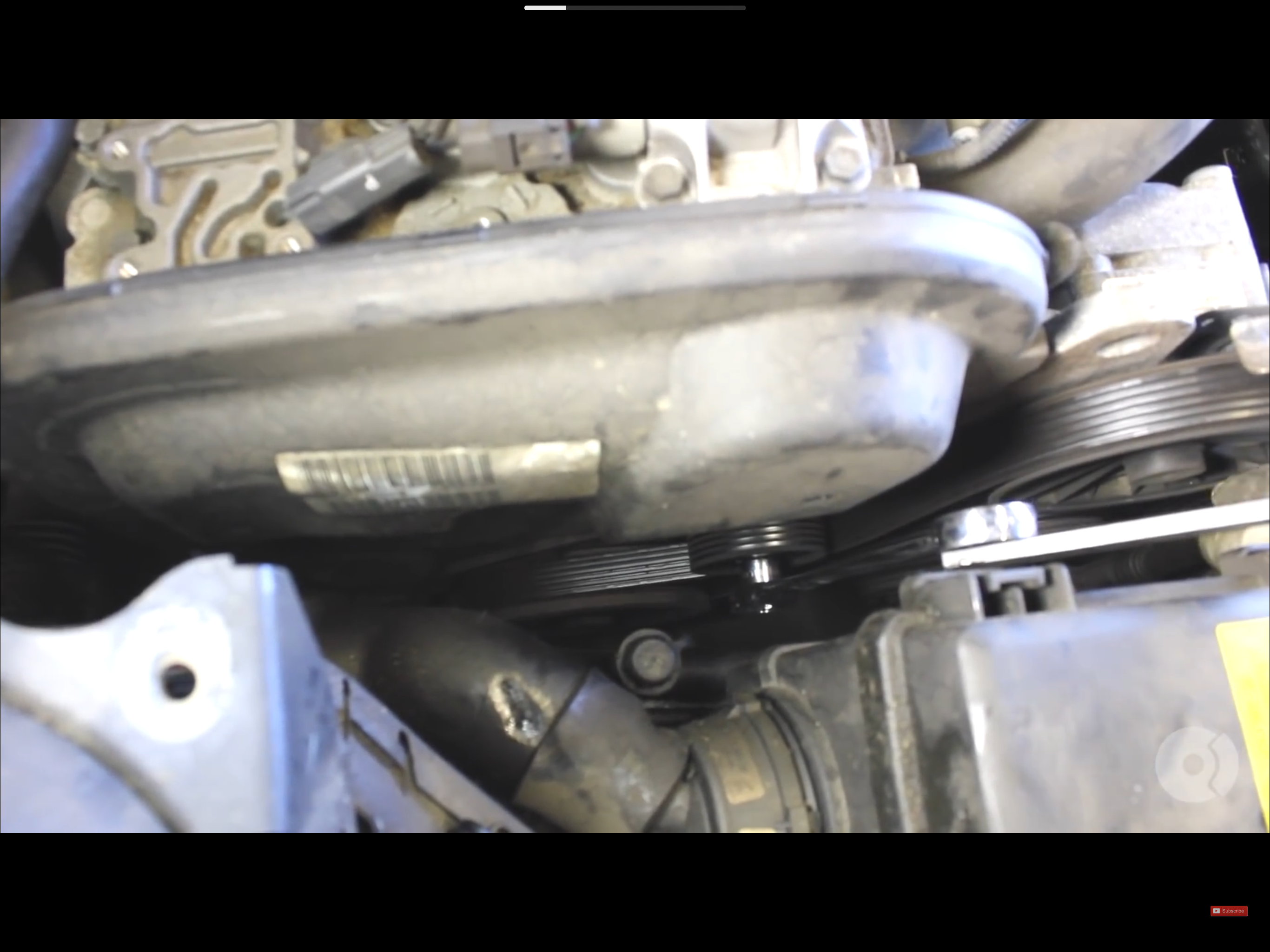

Some people say the serp belt is easy, I find it pretty tricky when it keeps jumping off one of the lower pulleys :(
What the videos usually don't show is how to slip the belt on without removing the crank pulley, how to adjust the later type of tensioner (mid 2004-up) and also how to release the cam hubs tension.

Serp belt is difficult with 1 person.
A trick is using bungee cord with hooks to apply tension on the belt while you try to route it through the pulleys.
