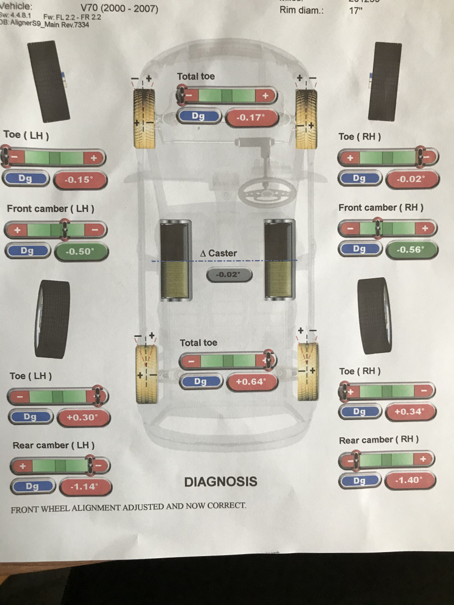

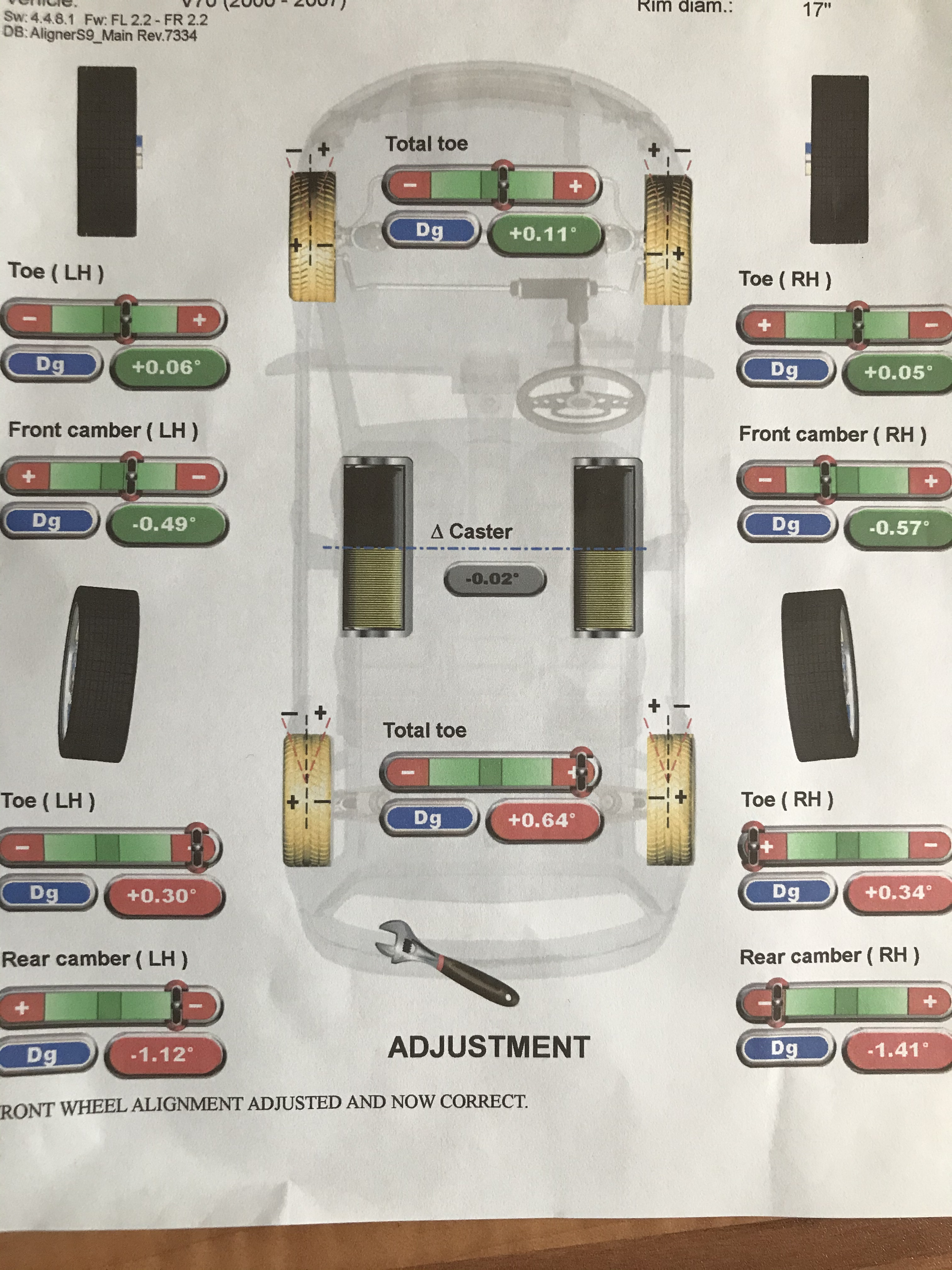

could be an extreme case of both camber and toe being out. but yes, the toe out is what it looks like to me as well.abscate wrote: 08 Sep 2020, 18:54 That looks like bad toe in to me, not camber, I should say toe out.
Front of tires are wider than rear of tires
Abnormal tire wear..
