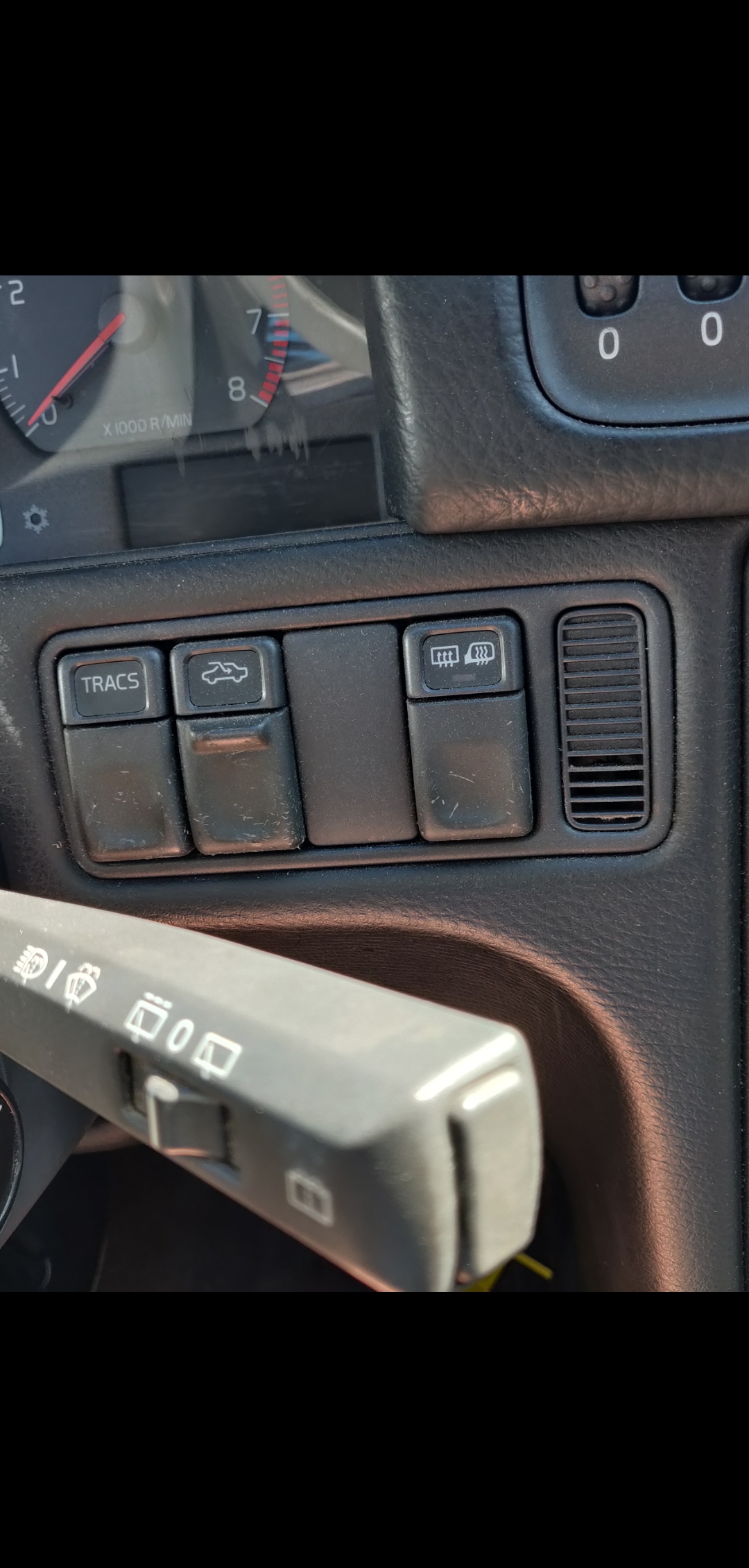

The TRACS light is always on....no matter what position the switch is in.

TRACS is a super common failure, it is almost guaranteed to be the ABS module but occasionally it is something else. You can run it as is without anti-lock brakes, or you can get the module fixed https://www.midwest-abs.com/1998_S70.php.

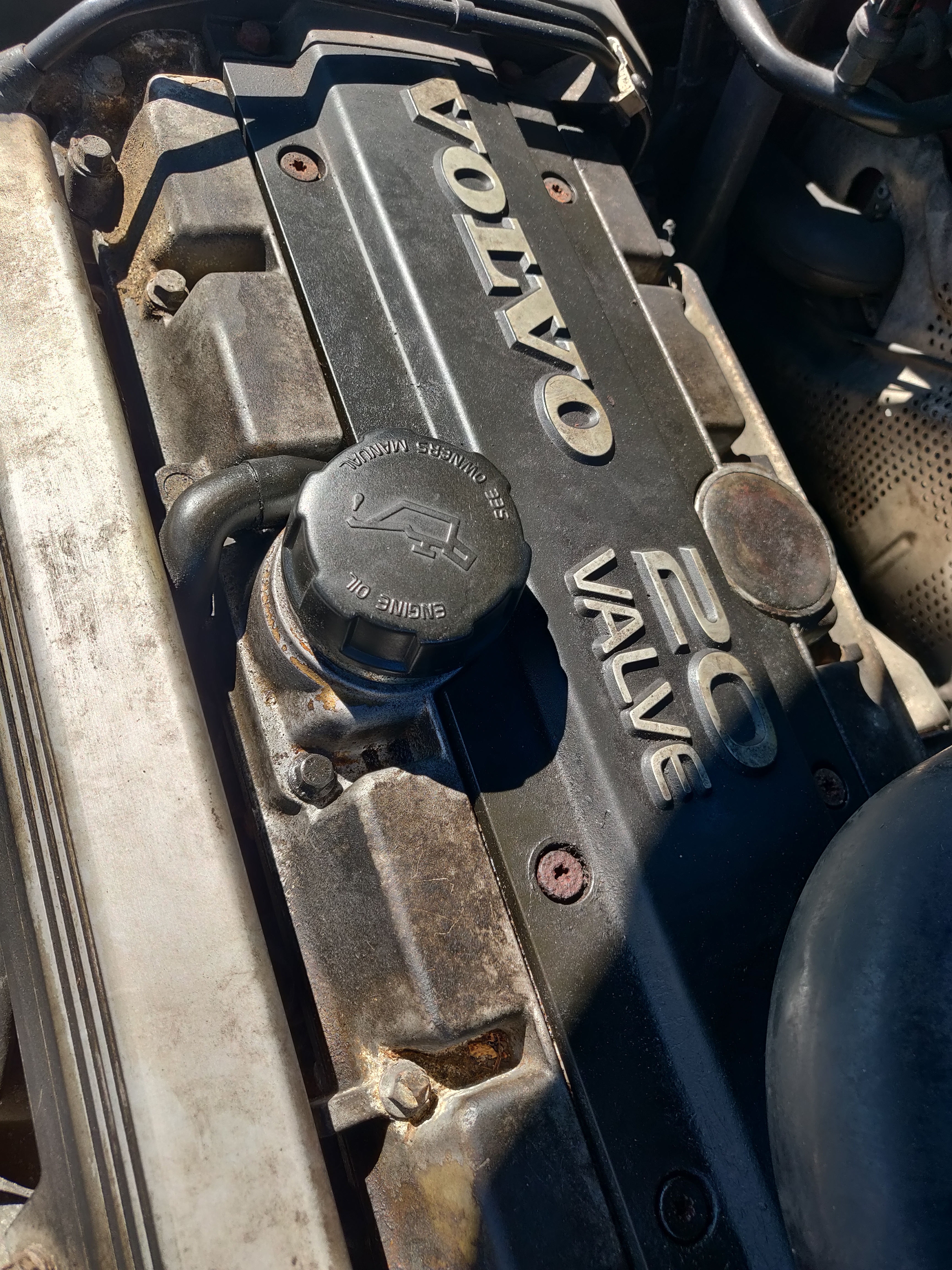

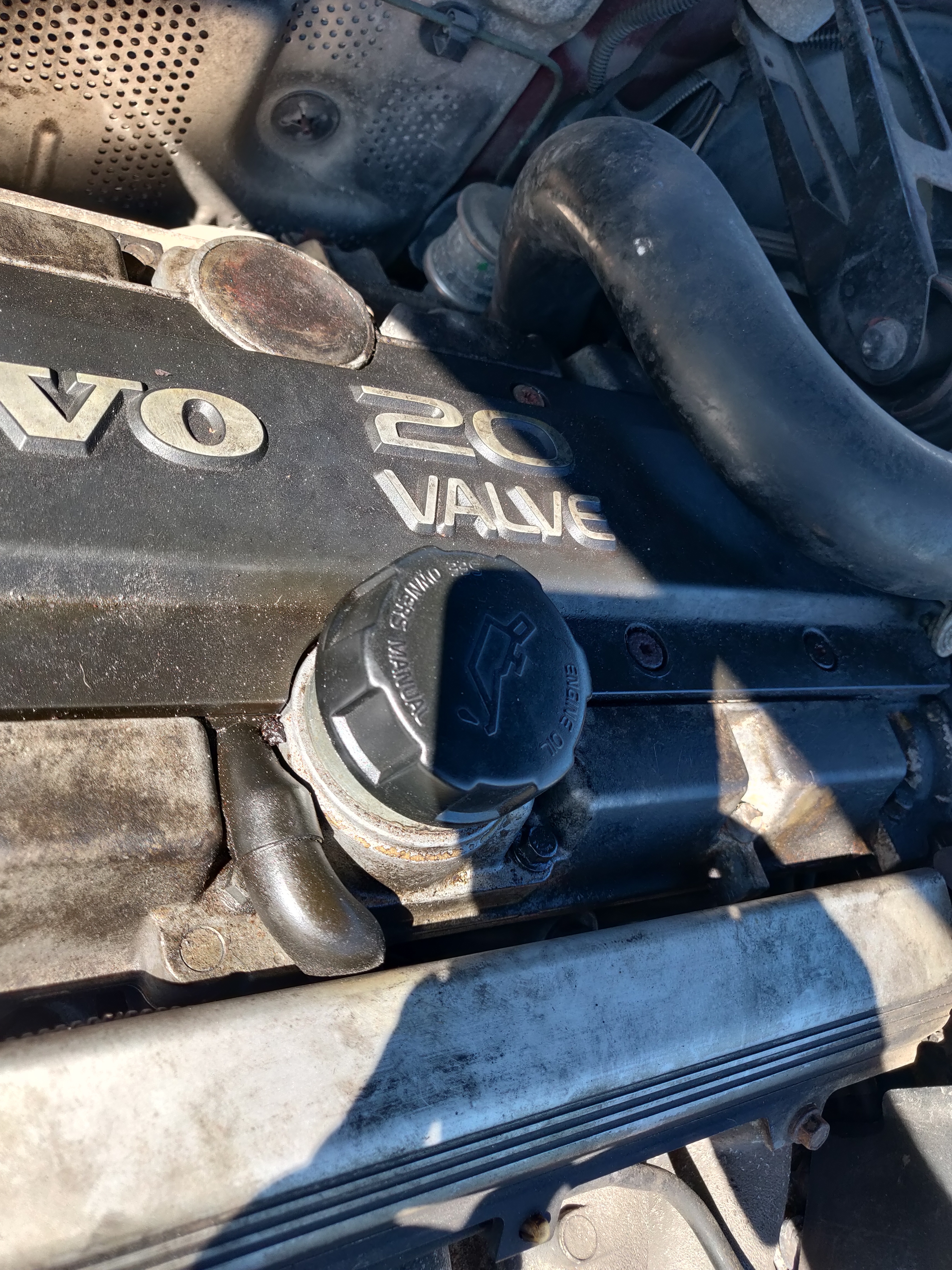

Also, little bit of oil near the fill cap, I didn't have the key, so when I do I can do the glove test. (Hopefully it's just spillage from a top off) and hope it's not the pcv system.

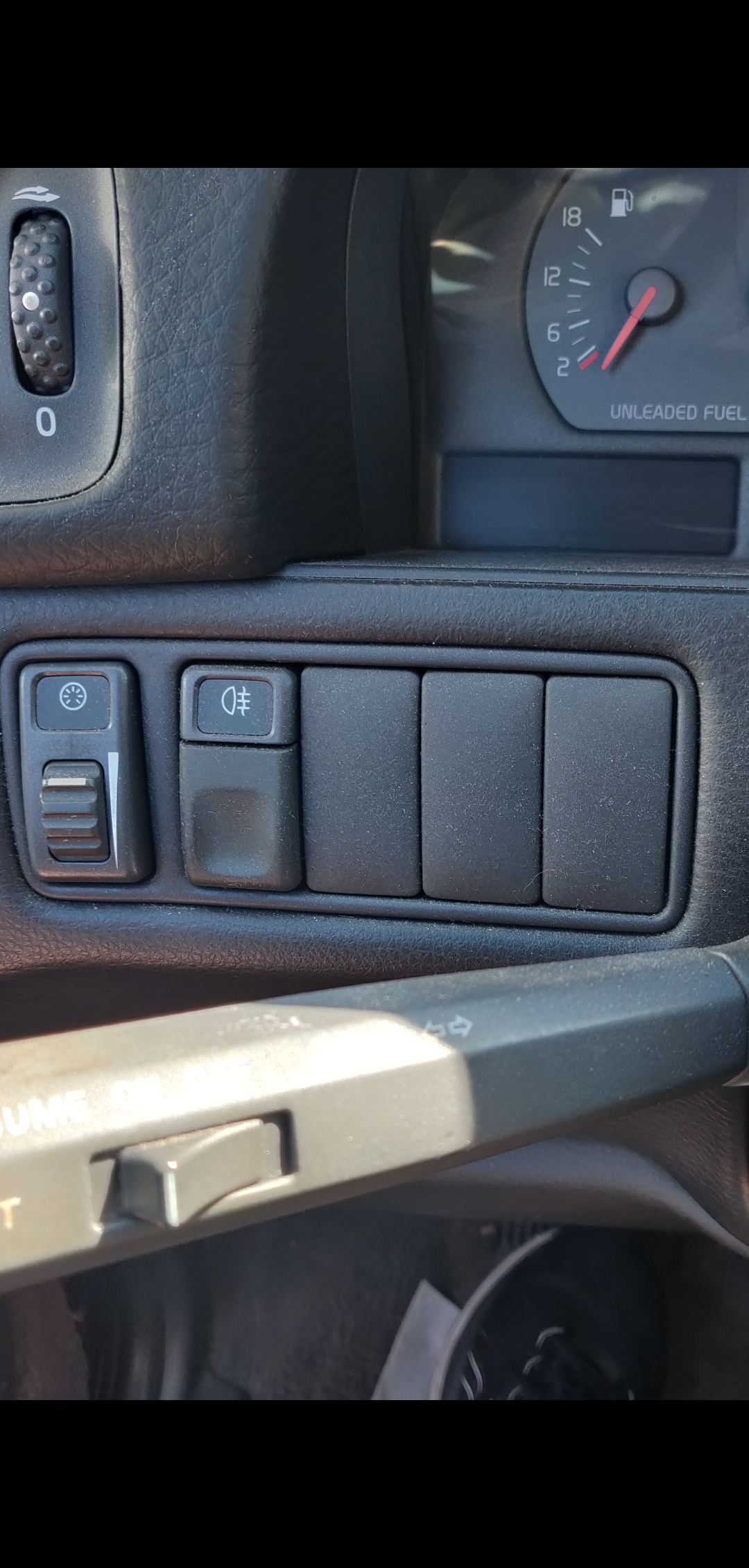

And.... Does it have front and or rear fogs? I think the switch is for rear fogs (straight lines) and, can I install front foglights, normal easy job?

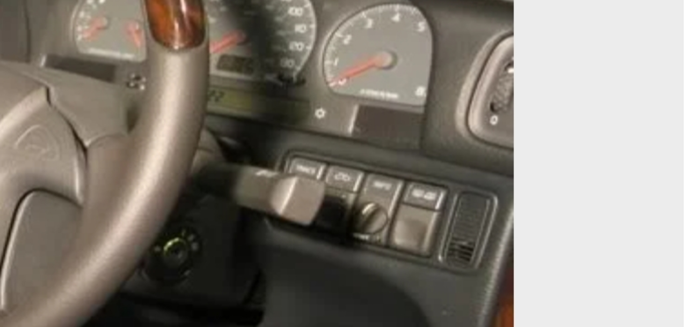

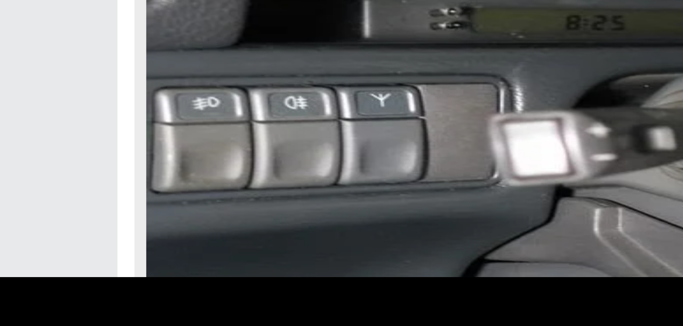

Found these pics....
I heard that the button blank next to the antennea button, is for a headlight leveling that is not an option in North America.
The other side, that is a vertical info switch
