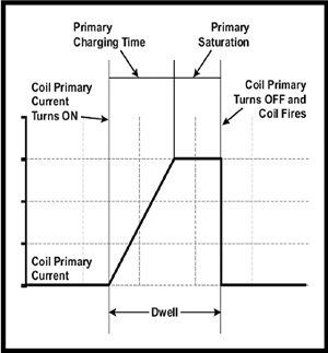

abscate wrote: 07 Oct 2020, 04:08 The Coil packs get a constant 12 volts and get fired by grounding through the ECU
Fired by interrupting the ground or un-grounding the primary winding ... turns off the primary.
Current flowing through the primary stores energy in an electromagnetic field. When the ground is interrupted, the current ceases to flow and the electromagnetic field collapses. The energy from the collapsing electromagnetic field is transferred to the secondary windings. That energy is what induces the high voltage in the secondary windings. The energy discharges through the spark plug.

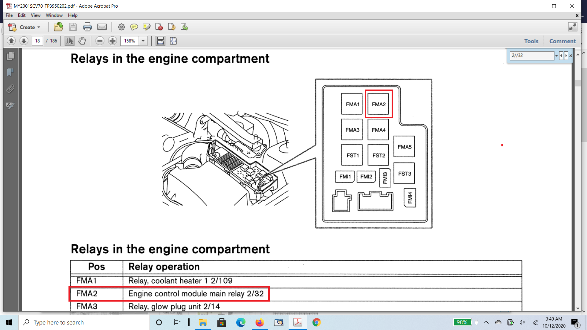

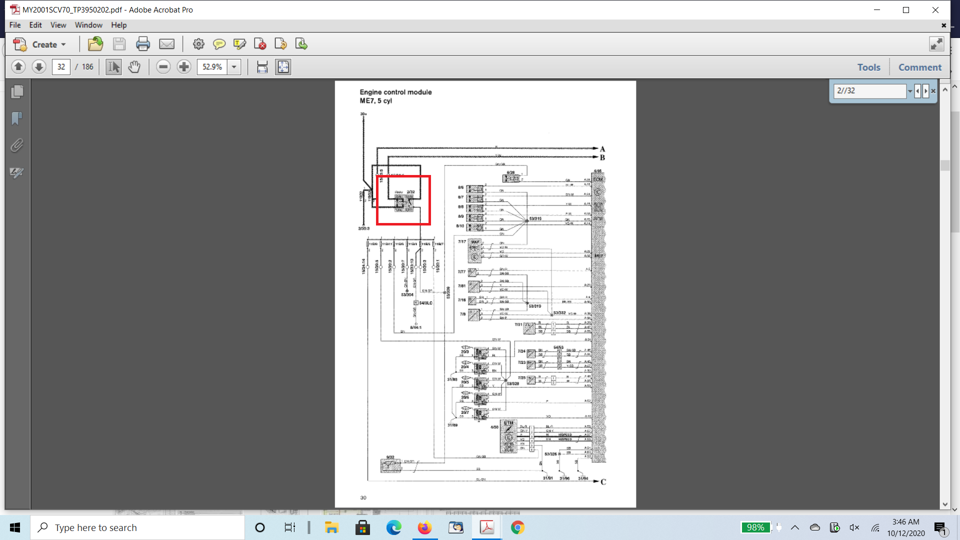

spineda wrote: 11 Oct 2020, 22:49 Do you or anyone know where it is ?
