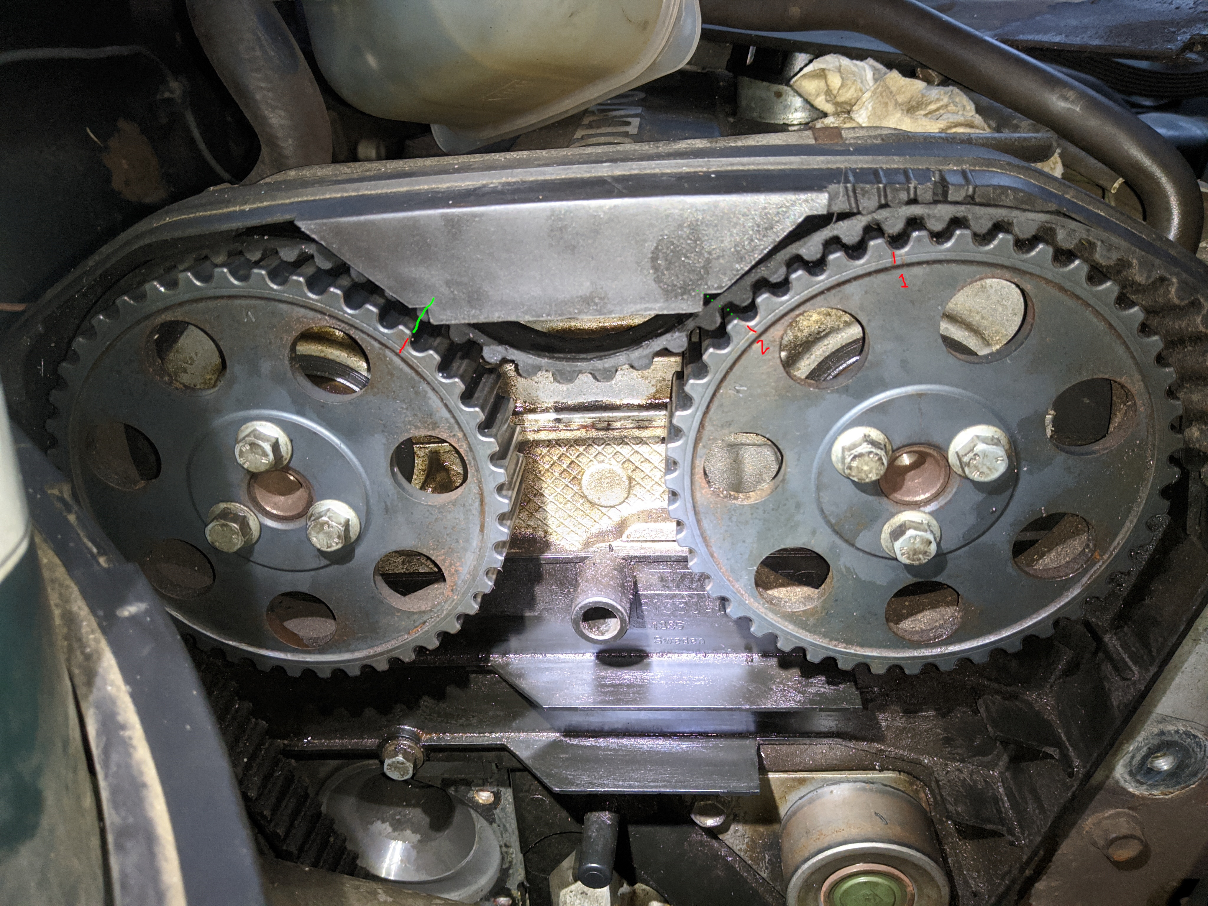

Was able to do this successfully. If I go by the rule that the cam sprocket bolts have to form opposite triangles it means that 'mark 2' from my original picture was the correct one, thus probably skipped around 4 teeth. Here's it now: I'm guessing not, but would there any point in filling up coolant when doing a compression test?erikv11 wrote: 23 Nov 2020, 11:34 Alternatively you can remove the belt then move the crank until it causes pistons to jam valves, then fiddle with cams to free them up, then inch the crank some more, etc until you have the crank to the mark.

Before you run the starter sure to crank it around 720 degrees by hand and make sure all marks return to in-time.

I think you are going to be ok with four teeth off. Lottery win! (I’ve won it twice)

^^^^^^^erikv11 wrote: 26 Nov 2020, 02:17 Before you run the starter sure to crank it around 720 degrees by hand and make sure all marks return to in-time.
Read this three times and definitely do this check
By hand, no valve damage.
Starter will bend valves.
Well, I was hoping to write a message of a different tone today, but alas. No compression on two out of the five cylinders.
Abscate, your pump came today and I got it installed. Checked the timing belt alignment five or six times doing a 720 degree crank rotation, was lined up every time. Disconnected the ignition coil, the fuel pump fuse, and the fuel pump relay. Full throttle while doing the compression test. Of the two cylinders that had no pressure, there was no normal rhythmic cranking noise, just a steady starter noise.
