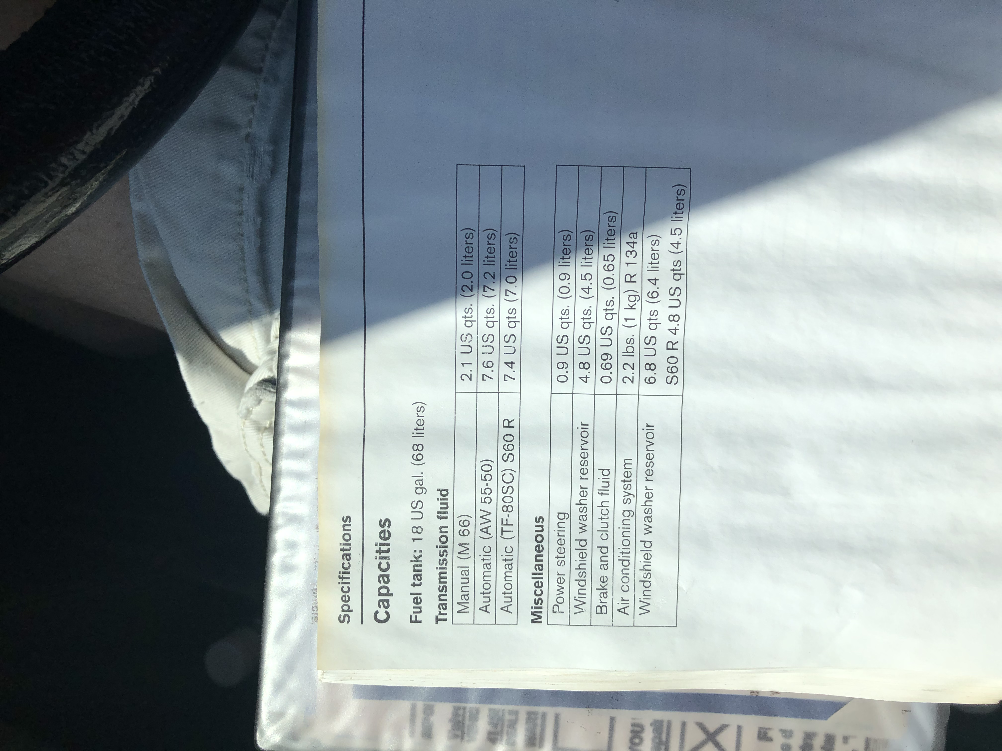

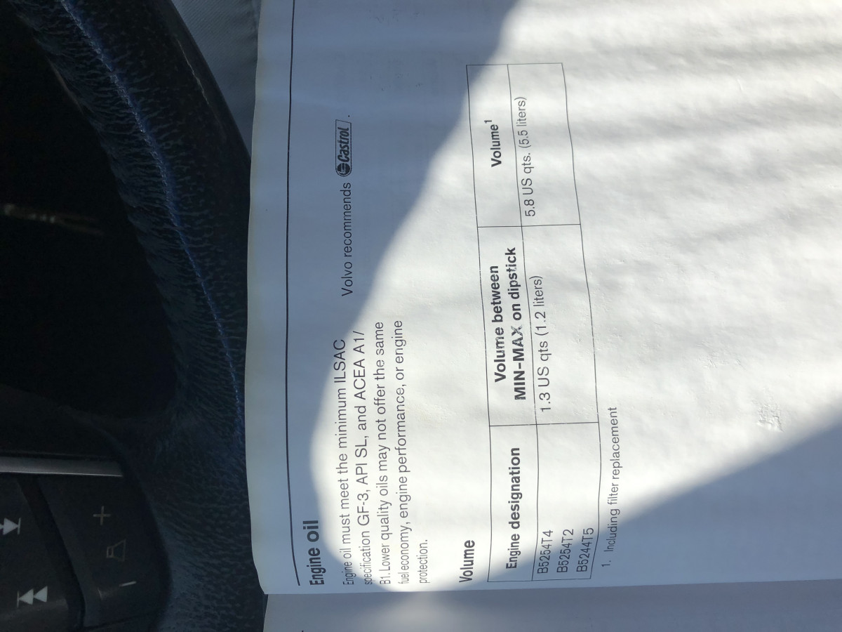

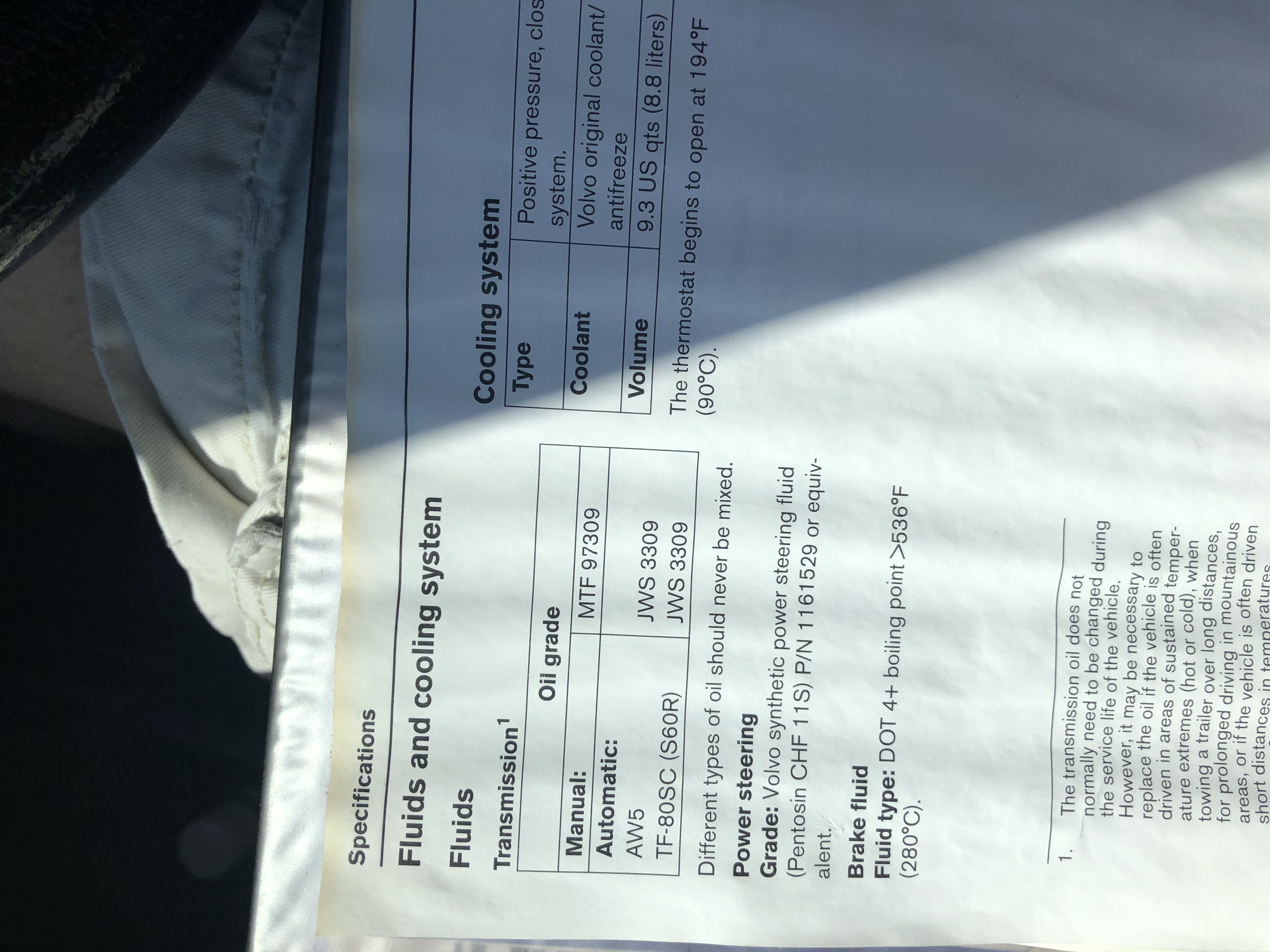

Here are the capacities from my owners manual. I keep these pics on my phone. Power steering is .9 Liters.

DonnVa wrote: 25 Apr 2021, 06:02 Here are the capacities from my owners manual. I keep these pics on my phone. Power steering is .9 Liters.
Everything in those pics has been added to the top post, thank you.
