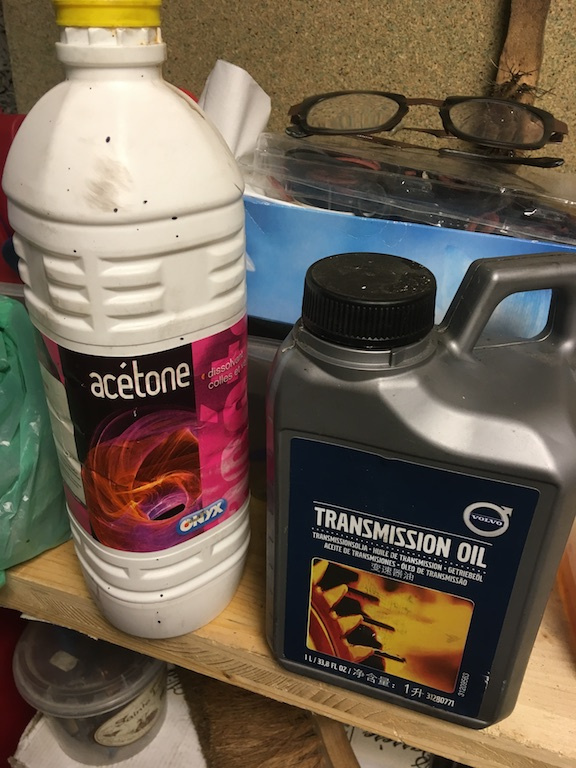

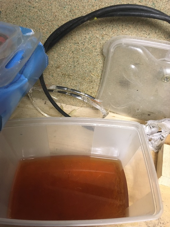

erikv11 wrote: 23 Jul 2021, 15:54 I agree WD-40 is useless as a penetrant. You can mix 50% acetone and 50% ATF (automatic transmission fluid) for a superb DIY penetrant. Shake vigorously to create an emulsion then apply with a plastic eye dropper.
So, always listen to those who know...
Today, Manov plays with dangerous liquids in his cellar :
The base.jpg (187.95 KiB) Viewed 219 times
The result.jpg (152.82 KiB) Viewed 219 times
tell me, do you have a recipe for day cream? :D
Thanks so much erikv11
erikv11
Posts: 11800
Joined: 25 July 2009
Location: Iowa
Has thanked: 292 times
Been thanked: 765 times
Post by erikv11 »
Looking good!
Mix vigorously right before every application. The phases will separate out quickly.
