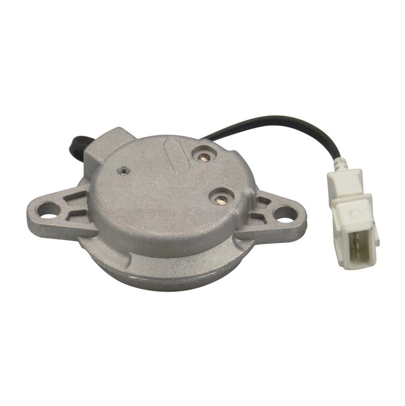

I have a question about tools. I've got an issue to unplug the AAC sensor, this one : the screws are in a bad shape, i thrown WD 40 for the night. Hum ? When i will succeed in unscrew these "bolts", i will replace them by 6 pans ones.

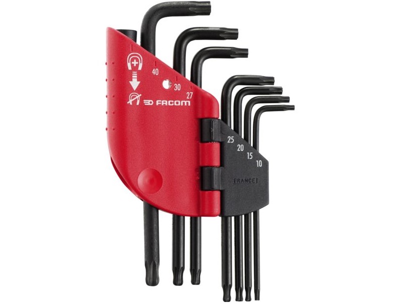

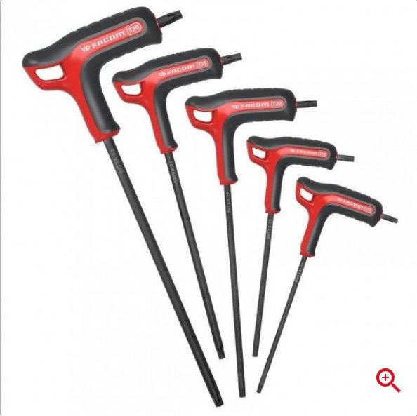

i need to buy good tools. What should i get between these two ones :

Facom make good tools. Either are good, but I prefer the older style as you can add a little piece of pipe to get more leverage. The 'T' type with the plastic may be able to do that but the plastic can crack.

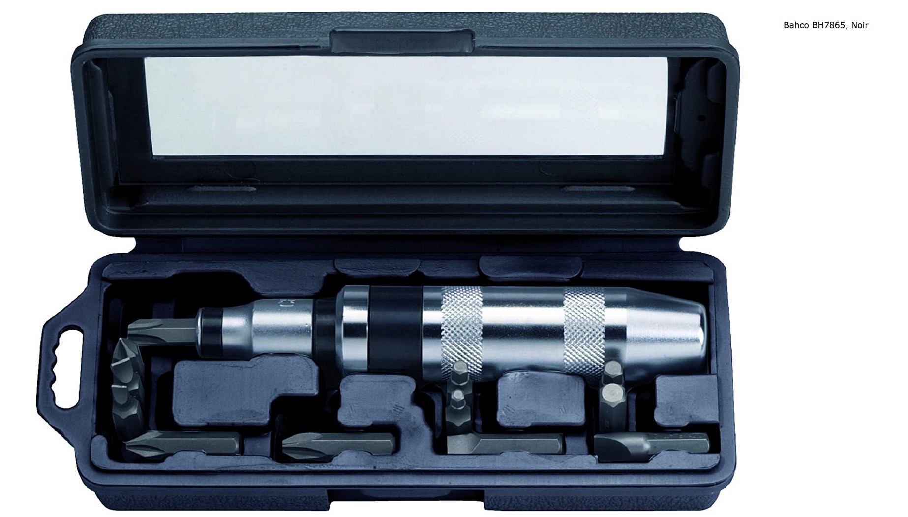

For troublesome small bolts, there is also a simple thing called an impact screwdriver. You can install any kind of bit for allen, torx, screws, etc. It's a small cylinder you hold and smack the end with a hammer. It drives the bit into the screw or bolt so it doesn't slip, while turning it just a hair. A few smacks with that and it usually backs out.

The T-handle will be much more convenient for everyday use, but the L-handle will be more durable and fit into tight spaces better. Best choice of all is a torx socket set, in my opinion.

I have used this type impact tool with surprising results many times. It even works on straight and Phillips head screws.
Added comment: This tool has a 3/8 drive and with some adapters can be used with your 3/8 (or other size) sockets.
