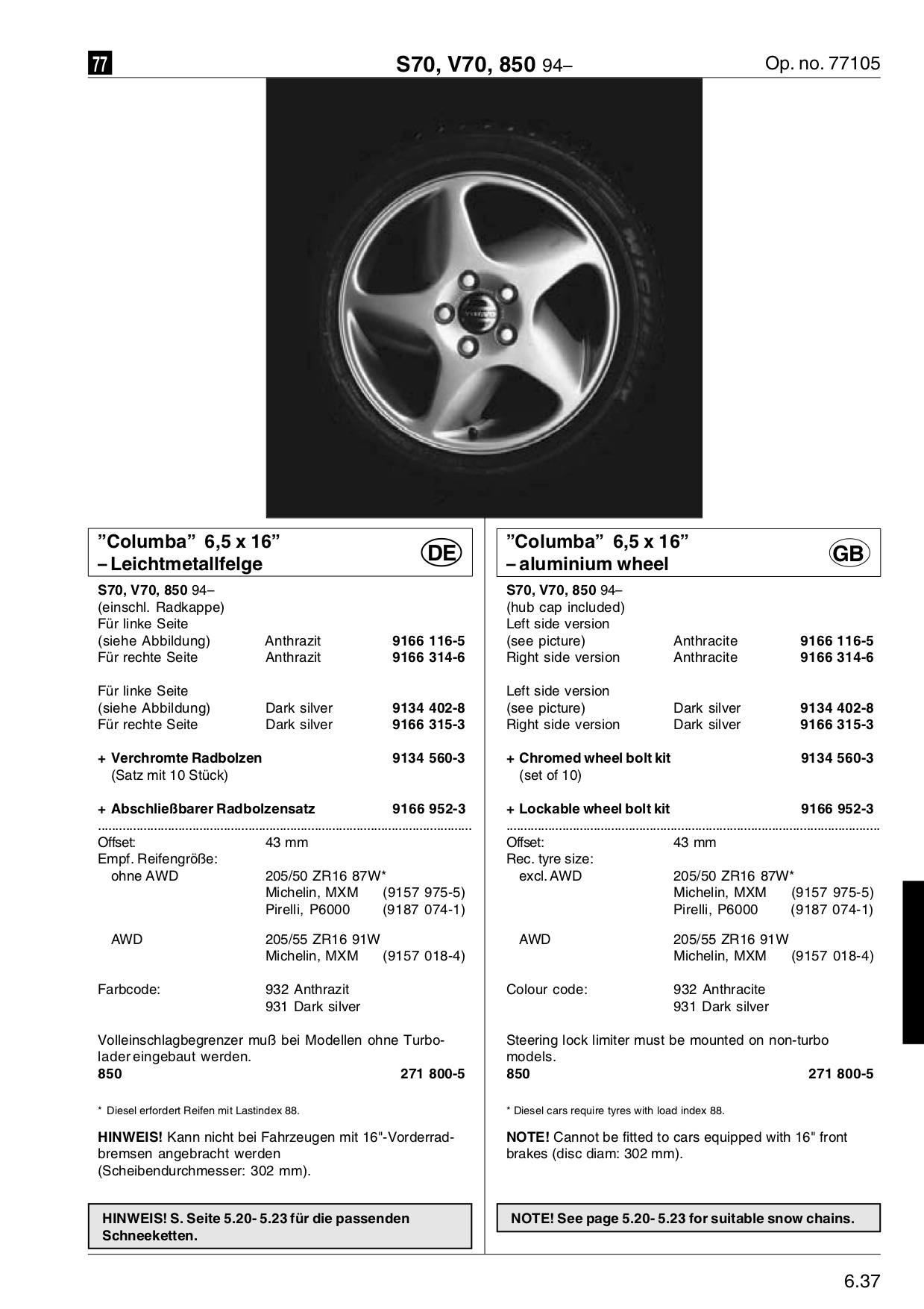

Salut Neil,
Thanks to you and to all others buddies for the help,
I will check the rims and the all the parts of suspensions again, but as said before, everything is new in OEM. But a other control can't be a bad idea.
The sub-frame bushes are the OEM ones originals ones i mean. A track to explore.
The rims i have :

I read an article in a recent classic car magazine on buying an 850 T5-R or 850R. They warned to watch out for worn front wheel bearings causing issues with steering. Never had that issue as usually by the time they are that bad you will hear them!
