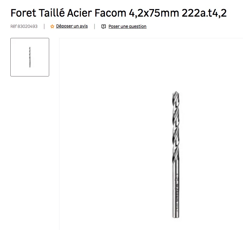

Hy Buddies,
The 10 mm pin that fixes the brake disc to the hub is broken into the hub. Each time i brake i feel the disc moving till the brakes platelets are taken.

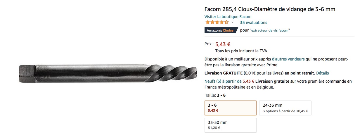

What tool do you recommend me to extract this screw ?
Drill bit 4,2 mm
and then, this one ?

Left hand drill bits (cut in opposite of normal direction) are recommended for extraction work.

I agree with @misha , the rotor should be captured by the wheel and lug bolts. People who use some aftermarket wheel have to take those little pins off anyway.
If you can get the rotor off, maybe you can get a grip on the nub with some locking pliers ?
