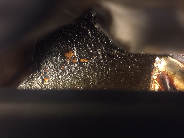

darylrobert wrote: 19 Aug 2021, 02:47 I recently vacuumed picked that broken corrugated plastic from the spark plug wells before removing the plugs, a real pain. I will not be putting the "VOLVO" cover as i think it traps heat and cooks the coils. For wires near the engine wrap new corrugated in scotch tape.
I had a fearful time removing one spark plug, it wouldn't turn. Once removed, a blackish substance around the thread and in the well was present -- did not know then that the disintegrated loom had turned into lock tight.
I used the other spark plugs repeatedly to thread and pick up most of the substance. I suspect some particles may have reached bottom of the oil pan.
