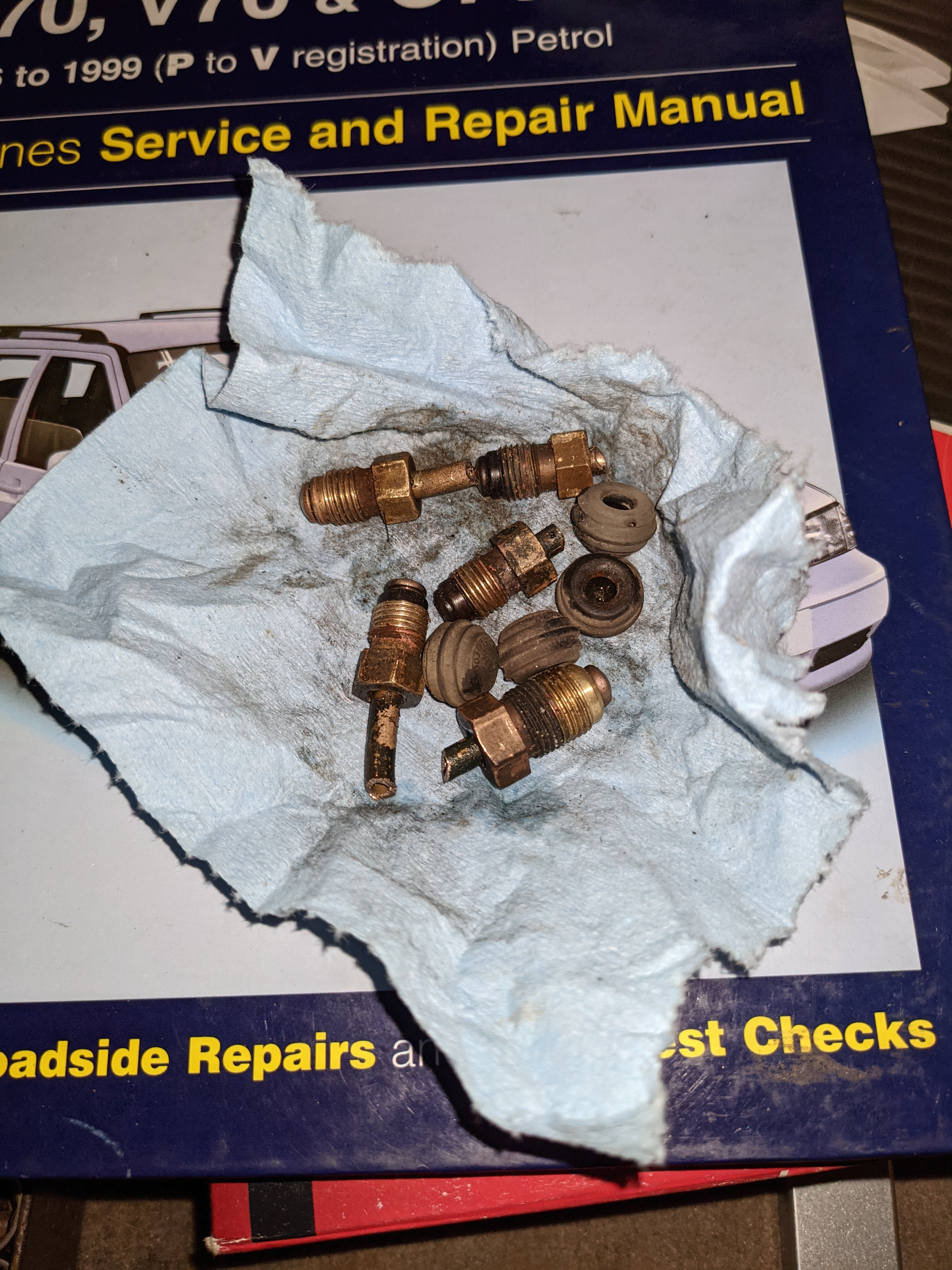

Get the good brass brake line fittings. Your rear fitting threads will wear out or they'll get stuck when the caliper rusts. Though stuck, the brass ones can be removed because they don't rust. I can find nowhere to buy M10 x 1 x 3/16" fittings in brass like Volvo uses. Instead, I only see steel ones which will surely rust firmly in the caliper requiring you to cut and flare the line.
The fittings at the ends of the four brake lines may be no good (rear stuck in caliper, front at hose with worn threads). But the rear which connect to the hoses deeper under the car at the hoses should be possible to remove and have perfect threads. Feel free to cut the metal line and rubber hose, then carefully separate the fittings once you're back at home.
The fittings inside at the ABS module and master cylinder are larger than M10 x 1. They're kind of accessible so I grabbed one, but don't think I'll need it.
Or can anyone find where to buy these in brass? Skandix has fittings but I can't confirm they are solid brass like Volvo uses.

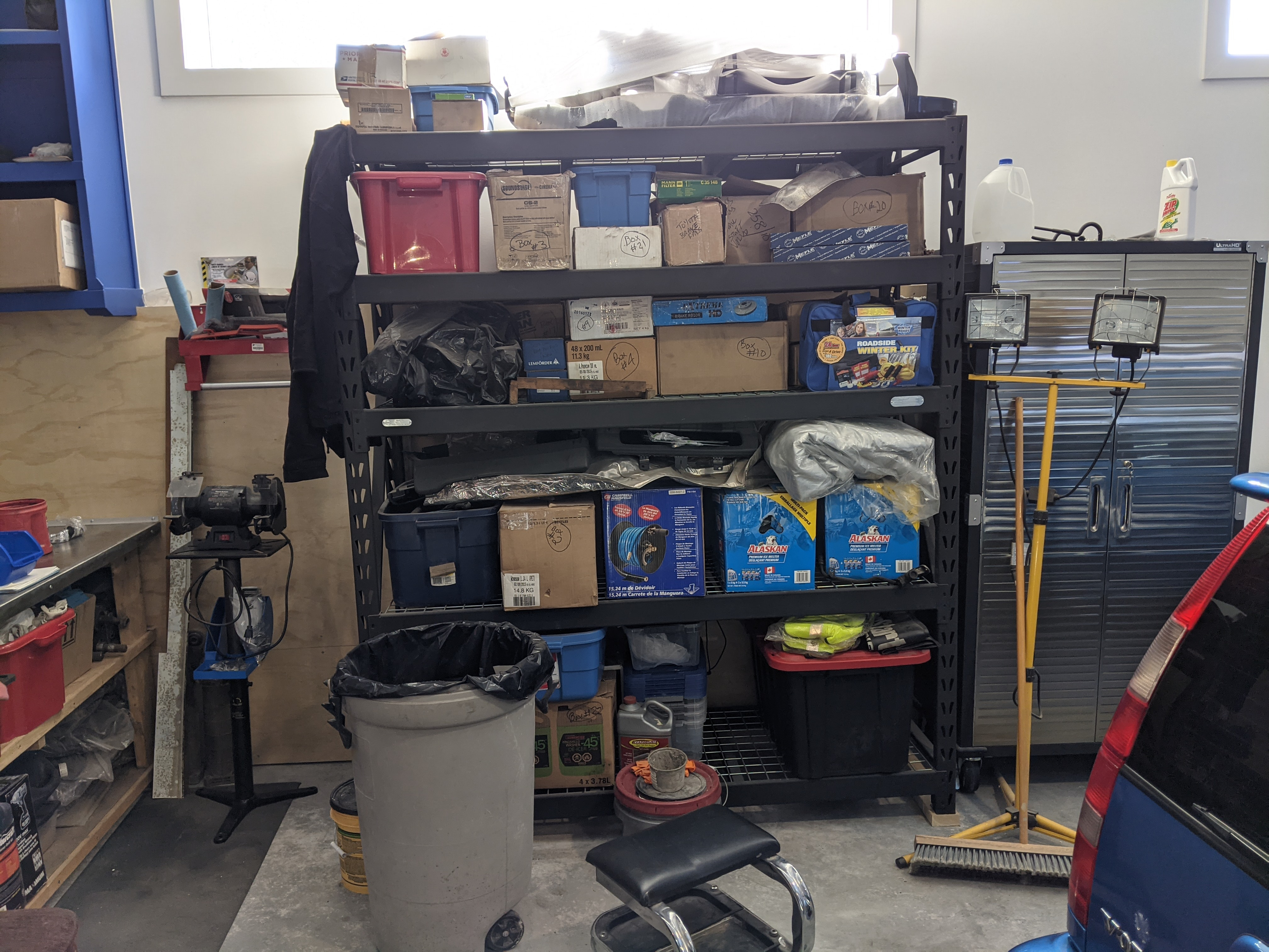

Be careful where this leads! You can see how my garage has ended up!

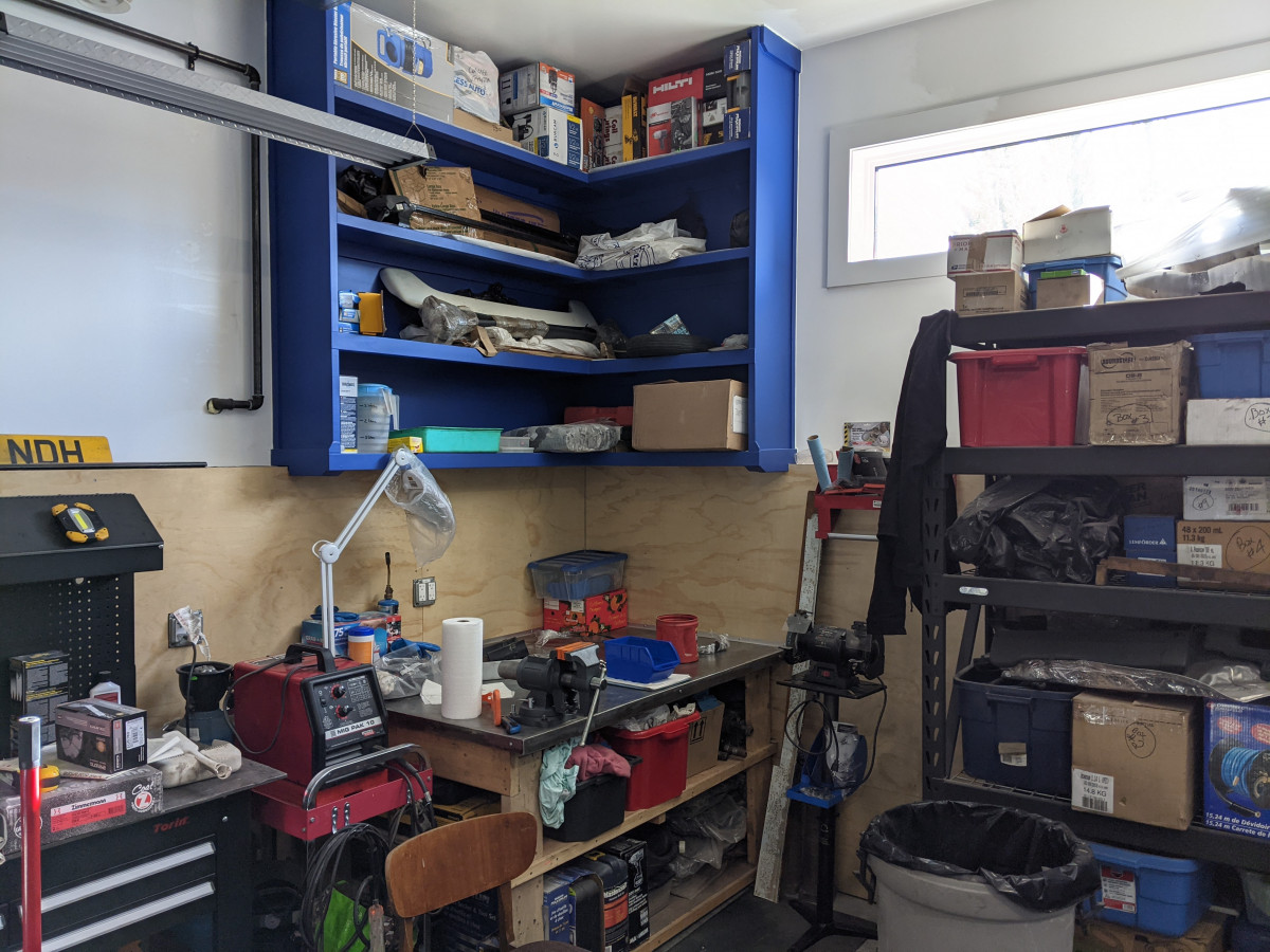

Electrical parts and lights
Most of the parts on the RH shelf unit apart from the travel fridge and large white box on the top shelf are larger electrical parts and lights.

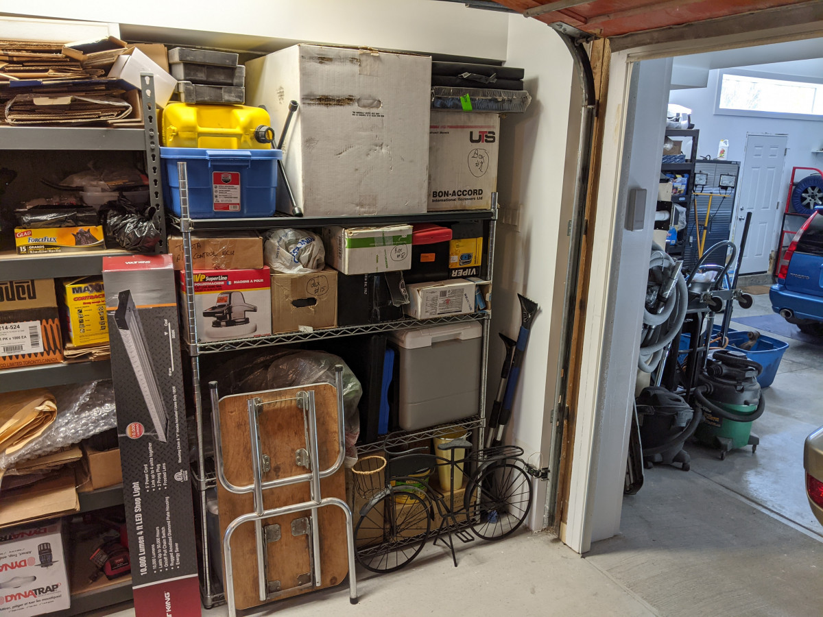

Larger parts
Larger parts
Blue shelves have 3 shelves of longer awkward parts to store. Work bench below has 10+ sets of floor mats and many other larger parts.

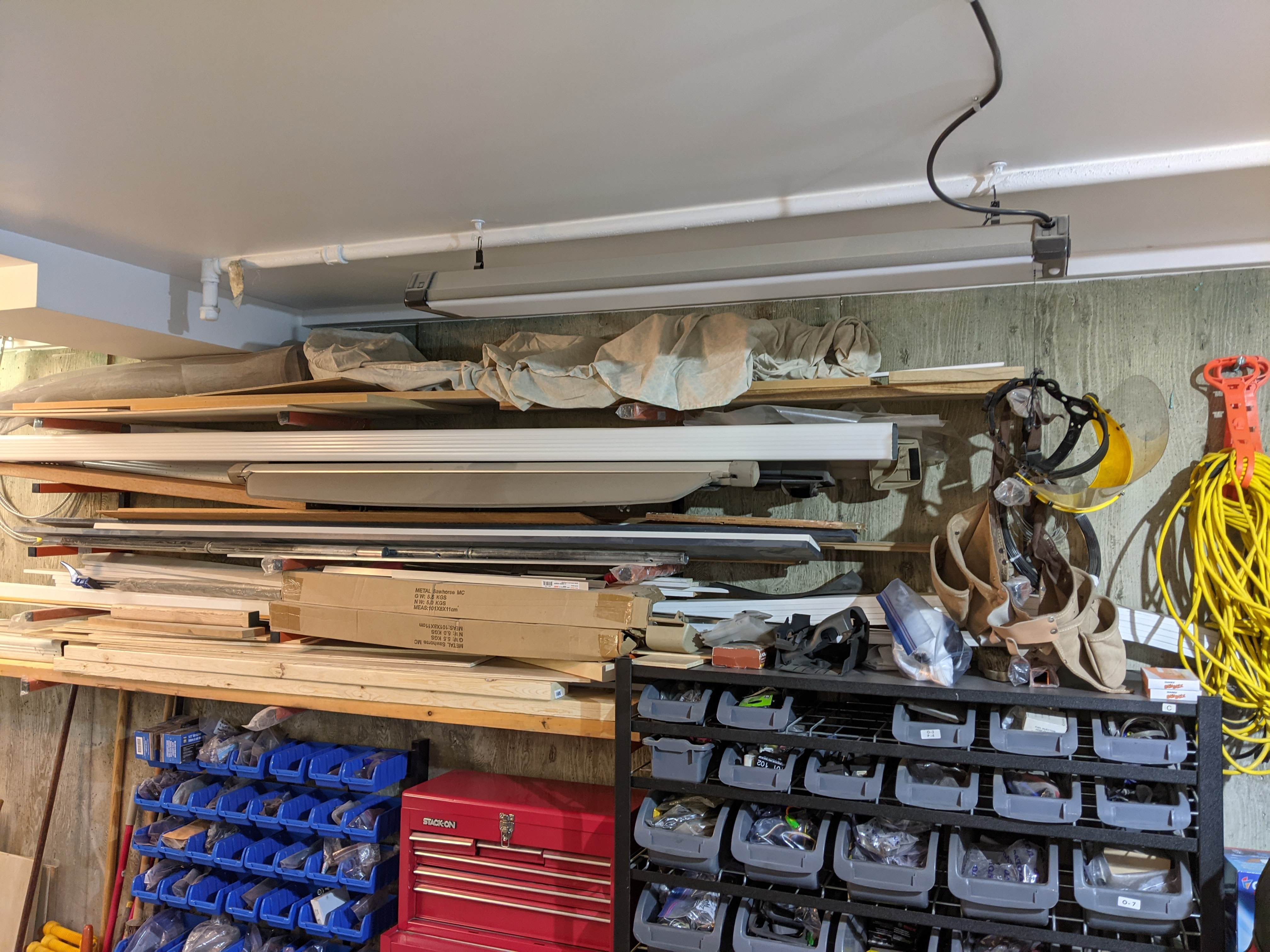

All larger parts mechanical

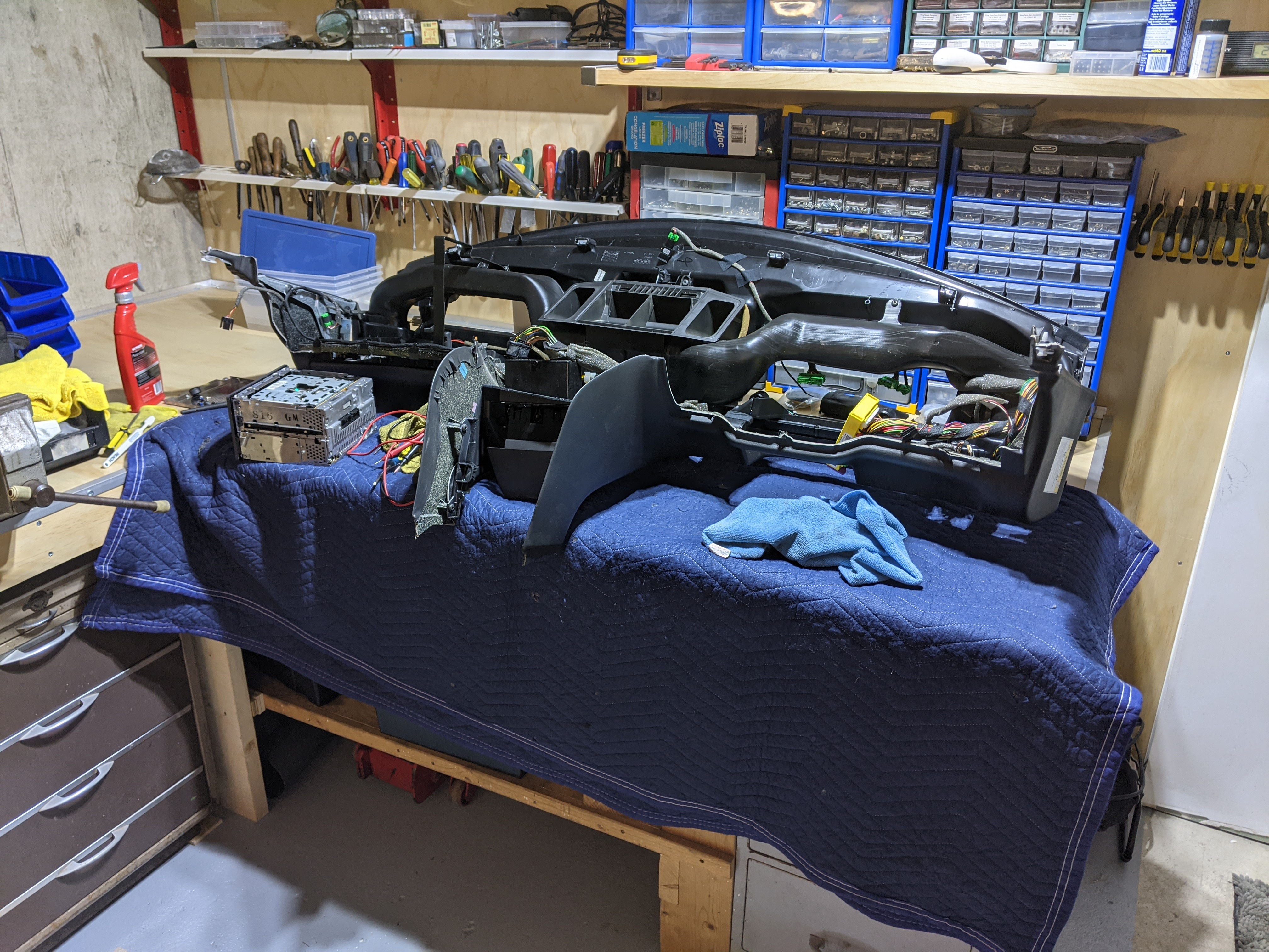

Top shelf has dash pad

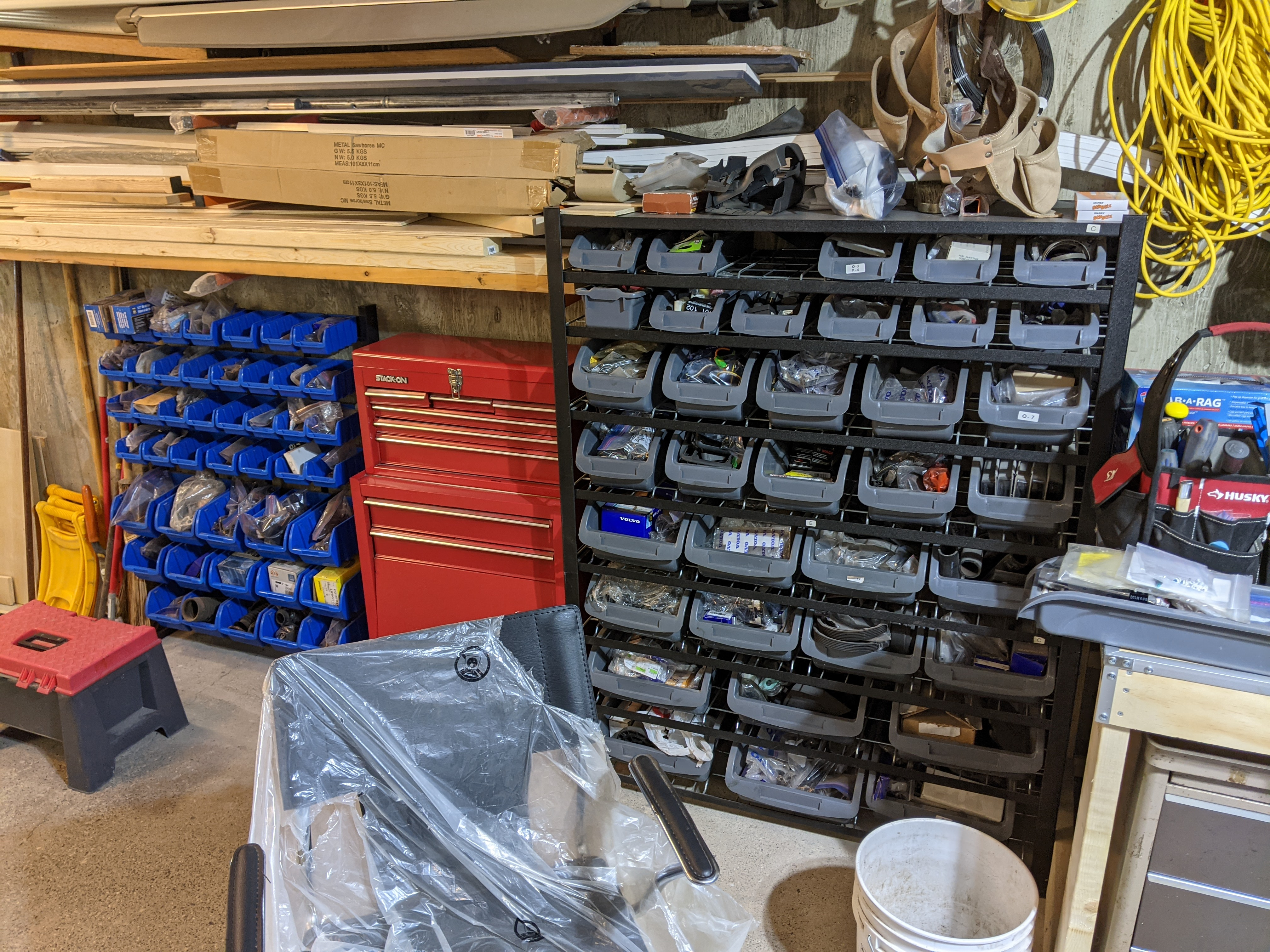

Smaller mechanical and electrical parts
New arrivals
New arrivals
Now in fairness there are some Toyota pats in here and a few P2 parts, but the majority are P80 parts including 850 which I no longer have. I am now being pressured to start finding homes for some of these! :lol: :lol:
