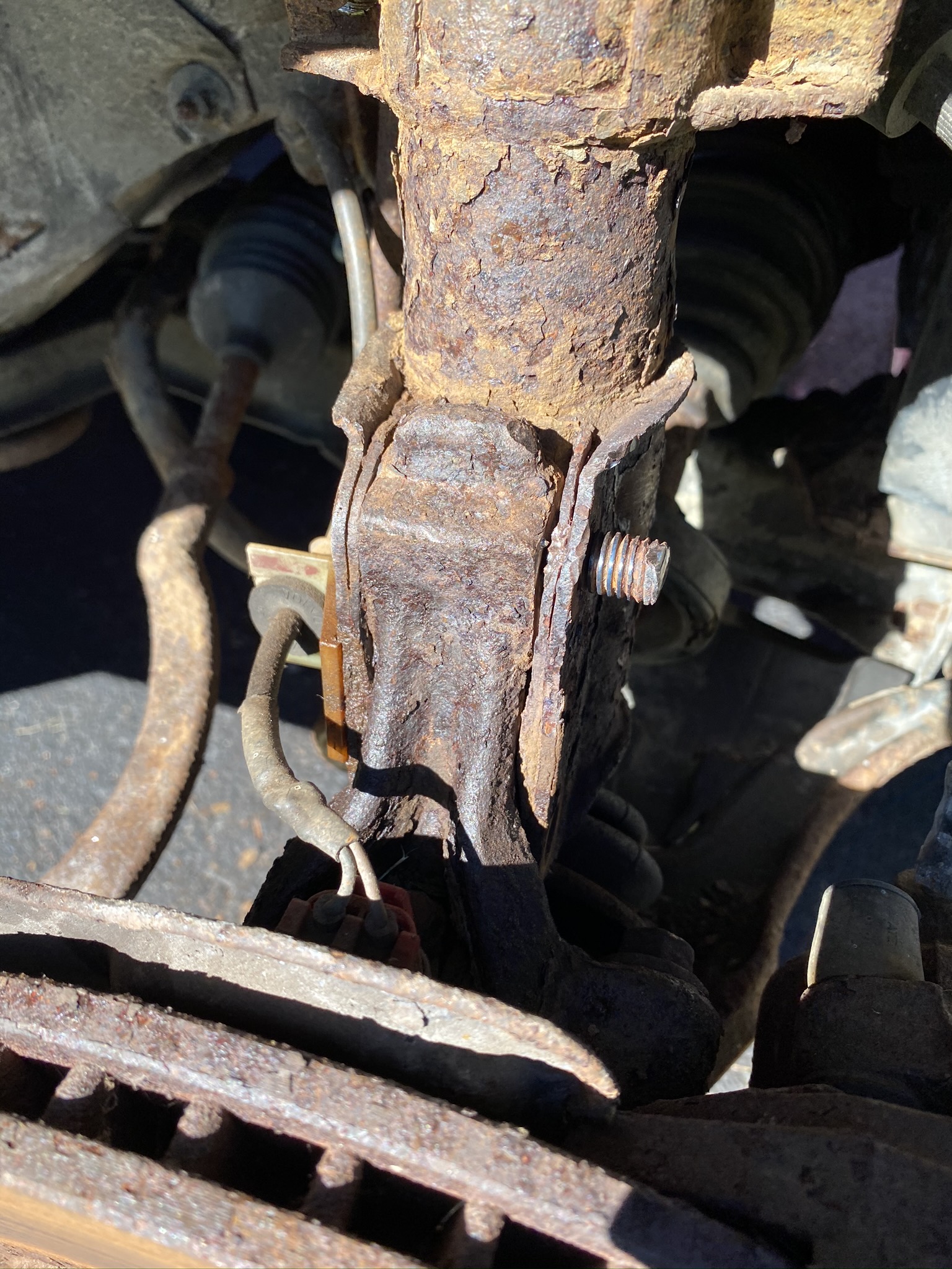

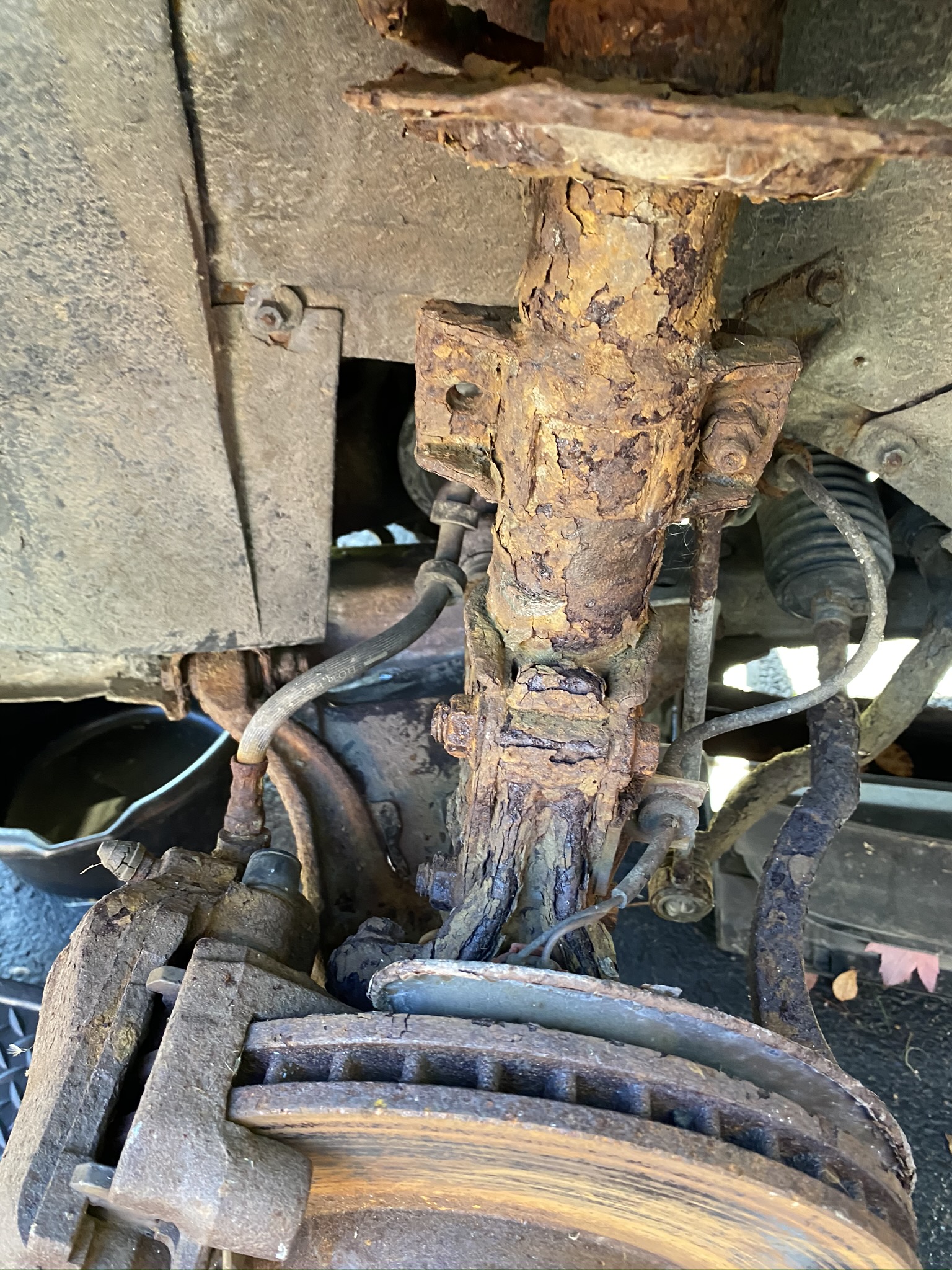

- Eddystone
- Posts: 564
- Joined: 20 Jan 2014, 16:30
- Year and Model: 1967 Ford GT40 Mk IV
- Location: Lorain, Ohio
- Has thanked: 63 times
- Been thanked: 81 times
I just moved from the Cleveland area from Philadelphia after about 30 years there. ALL of the cars in Ohio are rusted, and I fear for my poor Volvos. Cars that NEVER had rust in eastern PA are horrible out here. Cars that are relatively low mileage, in great mechanical shape and with nice interior have horrible rusted bodies. I know the winters are hard in Maine. Do they also salt indiscriminately up there? The only bolt I have ever broken on a Volvo was one of the two radiator mounting bolts, and those are not hard to replace.ericmci wrote: 08 Sep 2021, 17:21 One of my 14mm top bolts going into the block on the side pad mount was so rusted that I twisted the head off and I am in the process of using an Easy Out/ Bolt extractor. I was able to remove the other 14mm bolt and the the two 17mm that into the subframe but man... it wasn't easy.

- ericmci
- Posts: 166
- Joined: 08 Oct 2019, 11:56
- Year and Model: 1999 S70 GLT
- Location: Maine
- Has thanked: 73 times
- Been thanked: 15 times
Man - I hear you.
I replaced the entire front and rear suspension- and I mean everything last summer.
My struts looked very much like yours although to their credit were still functioning decently and being the originals.
It was the housing rust that prompted the change.
Maine is terrible with salt- it varies by the town but overall it's an issue.
That being said these 'cars that don't rust'- Really don't. It's always the replaceable parts- bolts.
The body is in fantastic shape.
Have you ever replaced the hydraulic mounts on the S70?
