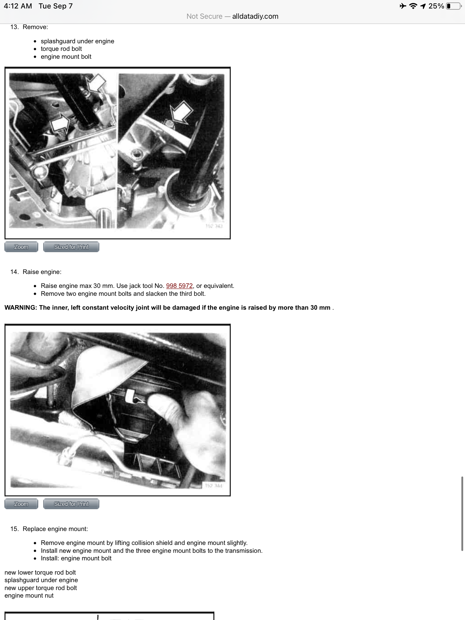

Watch out for the rear mount. There is a tab on it that has to be located in a hole on the bracket. Be careful also jacking the engine too high as you can damage the drive axles. Volvo does have a max. height you can jack the engine, but I can't recall what it is now. Just be very careful and watch the axles.
- Posts: 36137
- Been thanked: 4064 times
It’s one Imperial inch for that height limit
Raise engine:
Raise engine max 30 mm. Use jack tool No. 998 5972, or equivalent.
Remove two engine mount bolts and slacken the third bolt.
WARNING: The inner, left constant velocity joint will be damaged if the engine is raised by more than 30 mm .

Yikes.
Thanks for this.
In the FCP video it did seem like he didn't raise it too much but on inch is barely Any travel.
I am wondering now if I should replace the hydraulic mounts at all.
My side pad seems good- my transmission torque mount is def shot as is my Upper mount.
I can see the front hydraulic Mount it looks fine from my limited view. The rear is covered in metal shell of of sorts
so no good way to sinpect it visually.
How often do these go? Is there a way to test them.
I have all six mounts I can do a total refresh here - but do I need to.
I would obviously like to but - is there a need vs hassle and risk?
