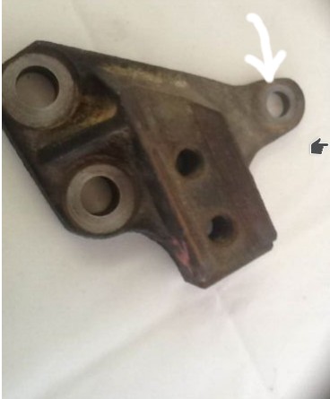

I tell you I am not sure how to get at the 11-12mm bolt that sits behind the serpentine belt pulley.
I was able to move the refrigerant pipe out of the way more but there just isn't any space to get a good wrench on it
and the pulley is in the way of a socket.
I am kind of stumped.
Can you remember what you did to get to it?
I can get you a picture of the scene tomorrow.
For now, this is a pict off ebay pointing to it.
- enginemountbracket2.jpg (22.11 KiB) Viewed 783 times
