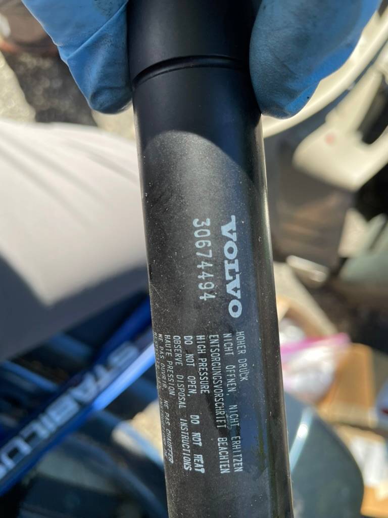

I will tackle this job today and will add pictures. ‘

2006 XC70 Tailgate Strut recommend brands? Volvo 30674494 Stabilus 6308S1

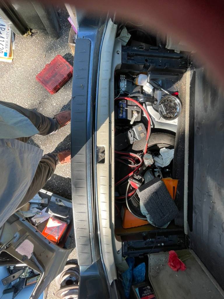

Tools needed
10 mm Hex socket - two bolts on forward lower C-D trim along edge, one each side.
Torx T-25 4 bolts on lower tailgate trim
1 T25 above rear deck light for upper trailgate trim
2 T25 , one each side for upper C-D pillar side trim, to rear

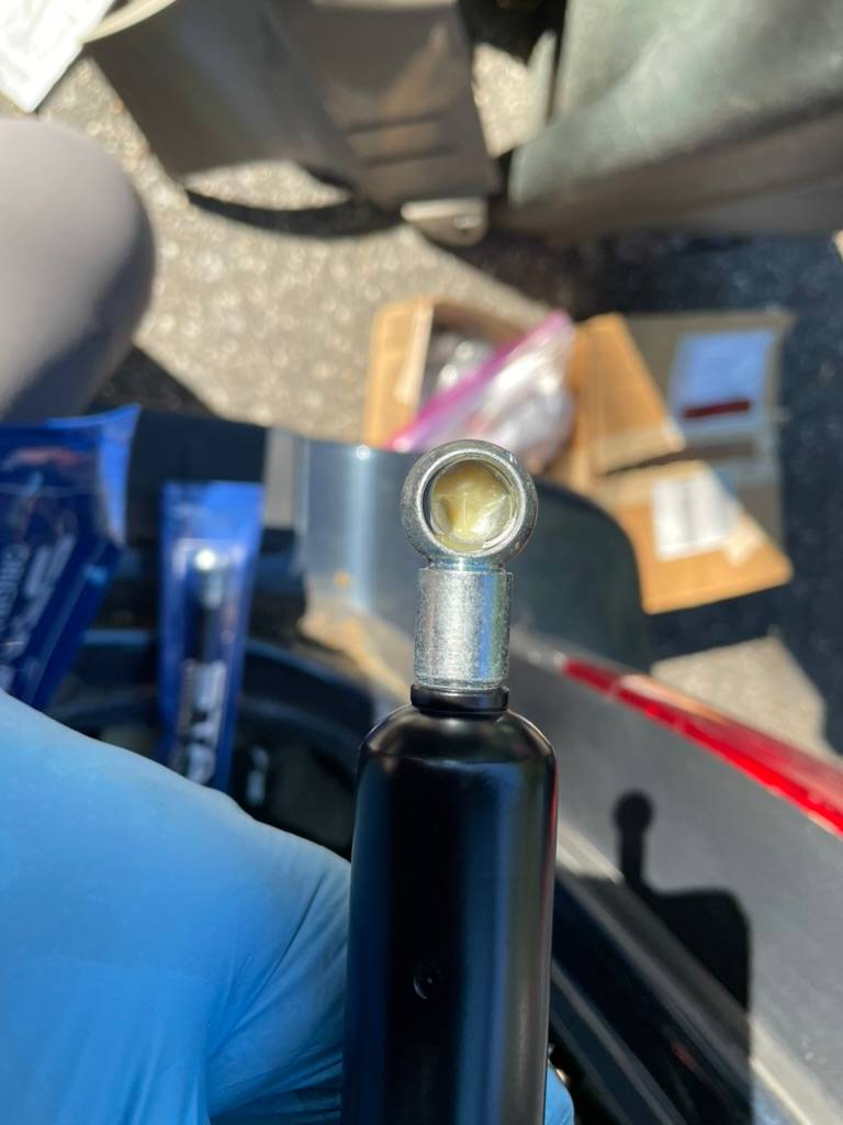

thin screwdriver to remove safety clip

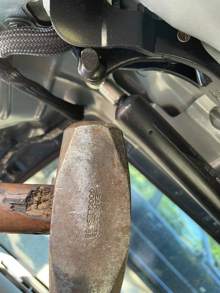

Hammer to pop off strut
Second person to hold/safety tailgate - you can prop it, but you dont want this thing falling on you - it will hurt and hurt you.

Assembly order is
First in lower tailgate trim 4 T25
Next D pillar trim on each side - snaps only, no fasteners
Next upper tailgate trim - one T25 center, on top of light
Finally, two C-D pillar trim - 1 T25 rear, 1 Hex 10 mm socket front (m6 bolt)
Snap in two side cover pieces, left and right, no fasteners
