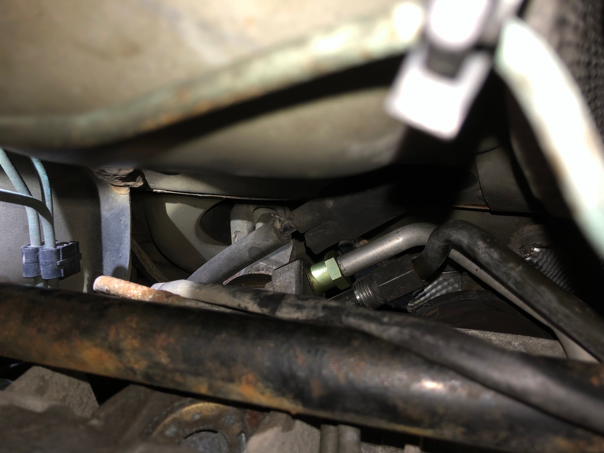

abscate wrote: 04 Jun 2024, 17:01 I’ve done five racks now, on P80s , and I would be impressed by anyone who could do that without dropping the subframe. Maybe P2 s are easier
Not a great photo but gives an idea of the access laying under the car. 1/2” crows foot socket with extension and some contortions and it is doable.
