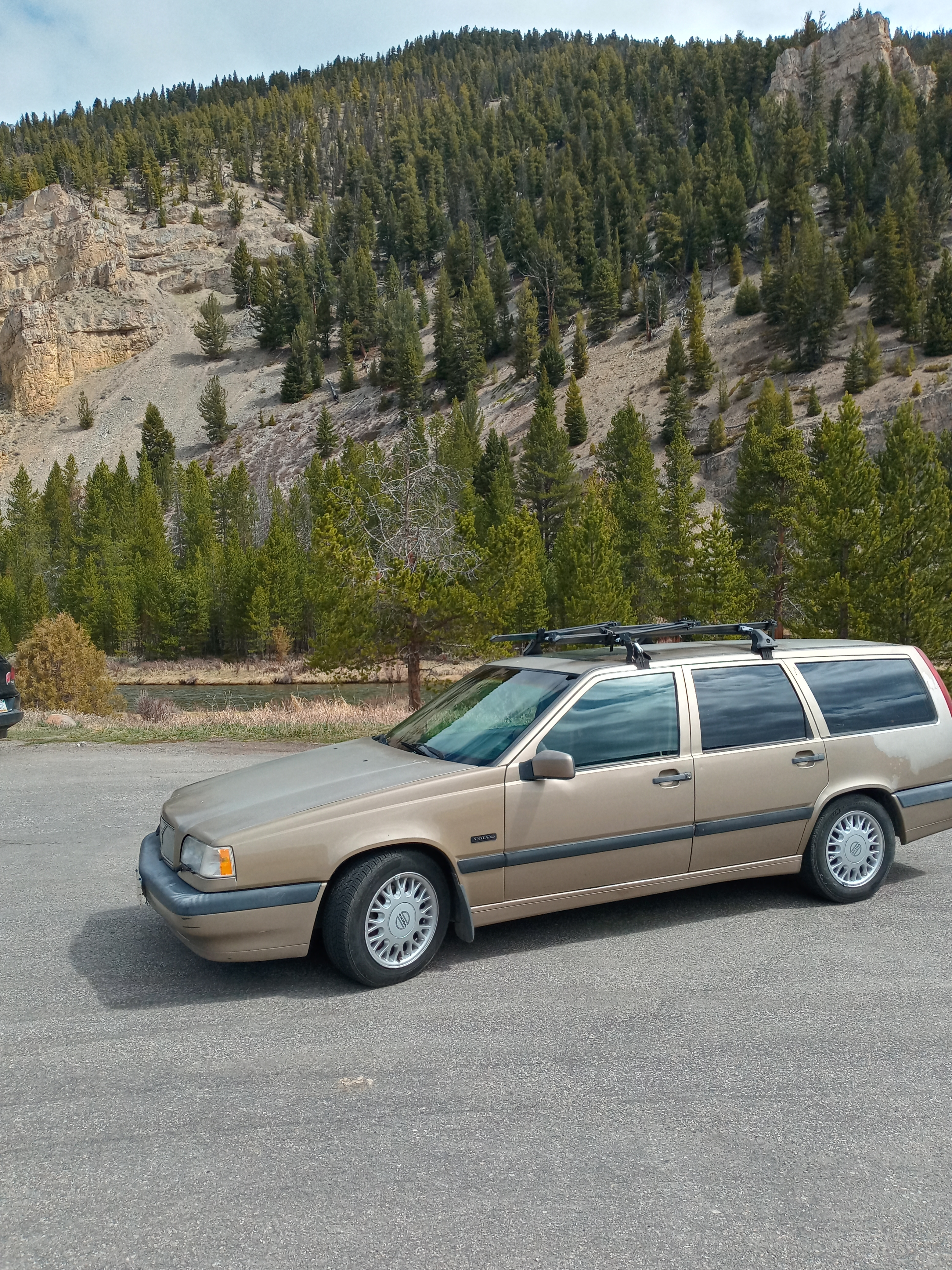

I agree all is not lost,that's what I'm checking this afternoon the compression if it's not raining. My biggest problem is the testing stuff,ya know like go just buy a new one.haha. Im htting the junk yard this weekend,and will wheel my husky box along with my battery. My zip is 92311. Here's a pic of my 850

On the rear of my 850 you may see that looks like a sanded patch....it isn't, its from the good old high desert sun 😎
