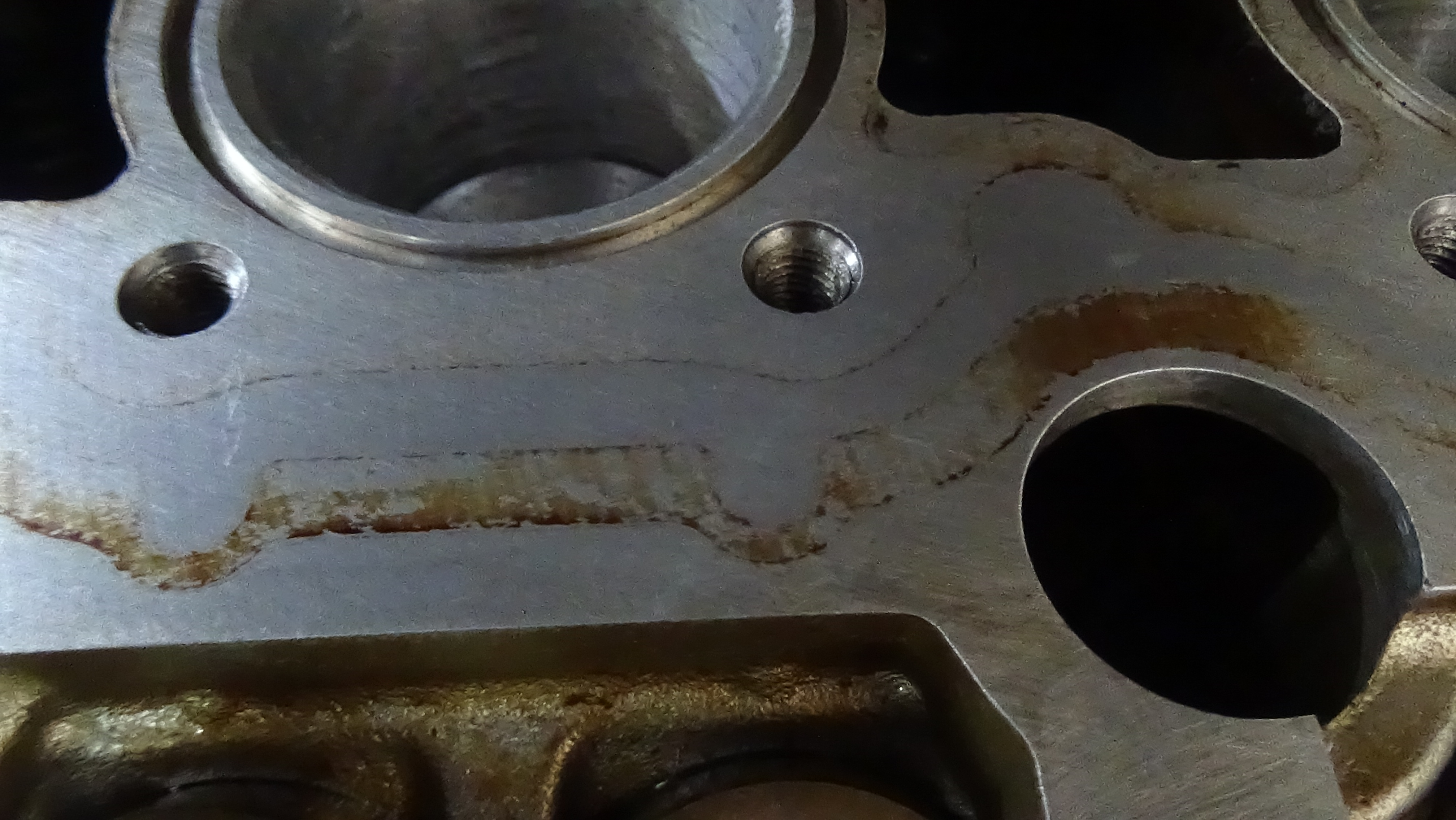

The top of the head that mates with the cam cover has stains that do not come off. Is this okay?

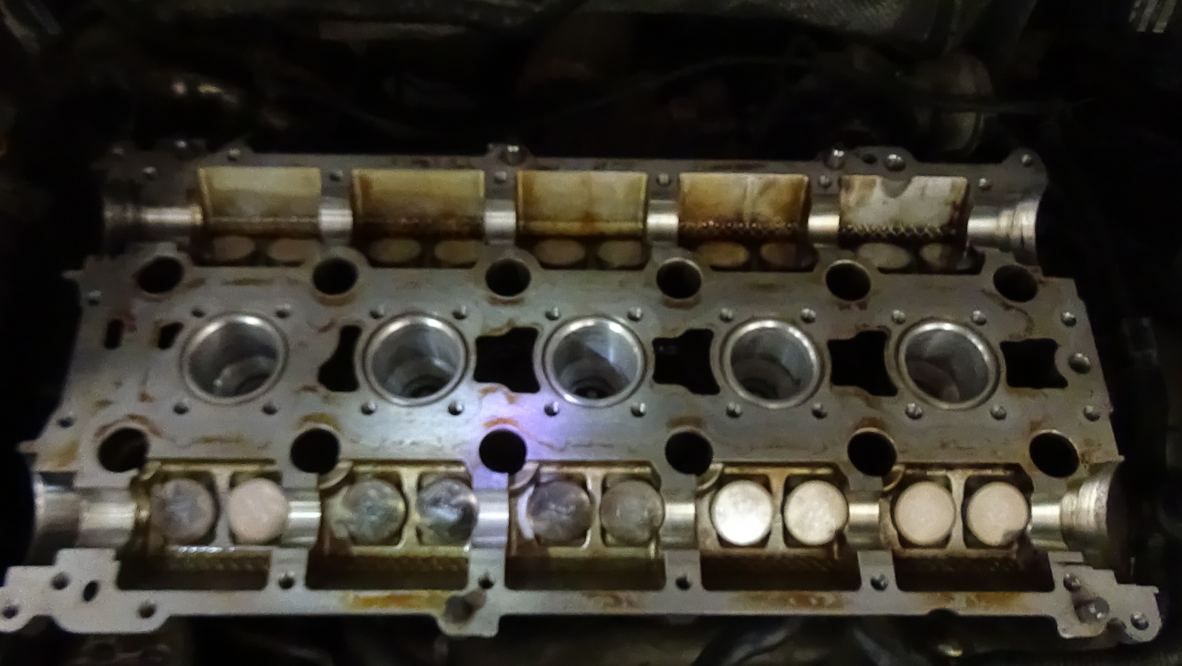

Here are some. The cam cover is similar, but a little better.

Looks ok to me.
Don't forget to lubricate camshaft valleys. Tappets, too.

And the camshaft thrust surface on the first journal from left. I left that bare and it took me 6bweeks to figure out why my cams locked up
