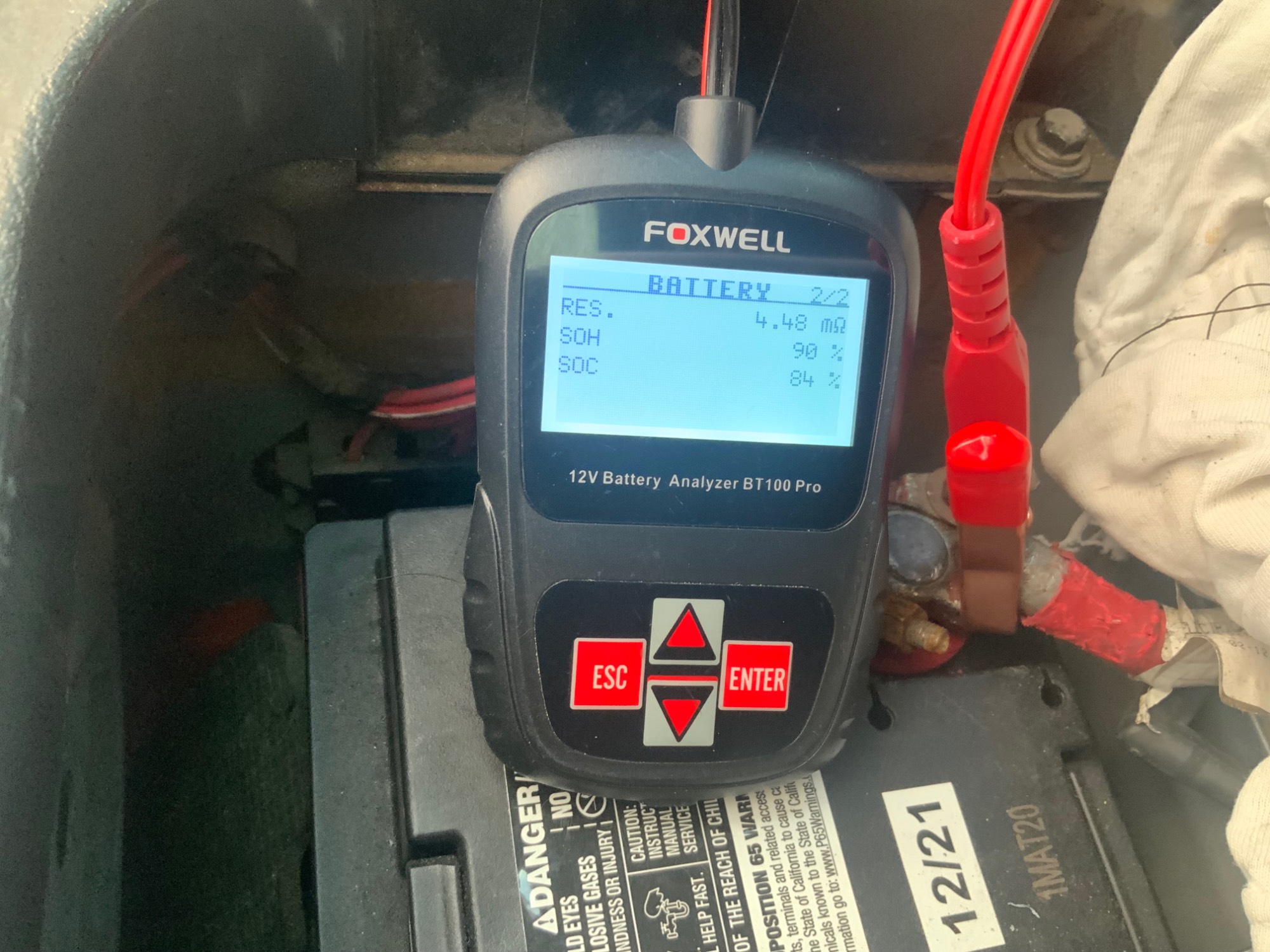

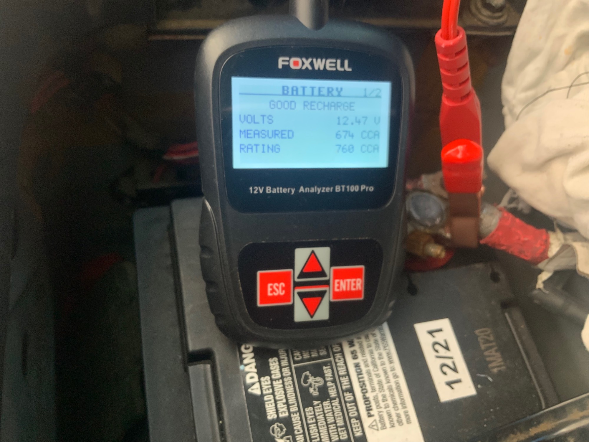

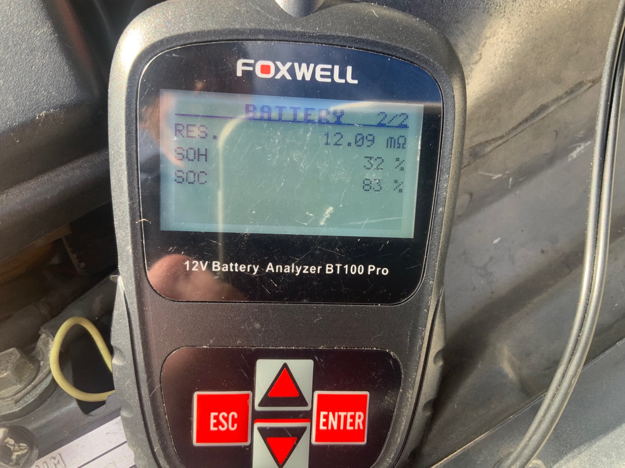

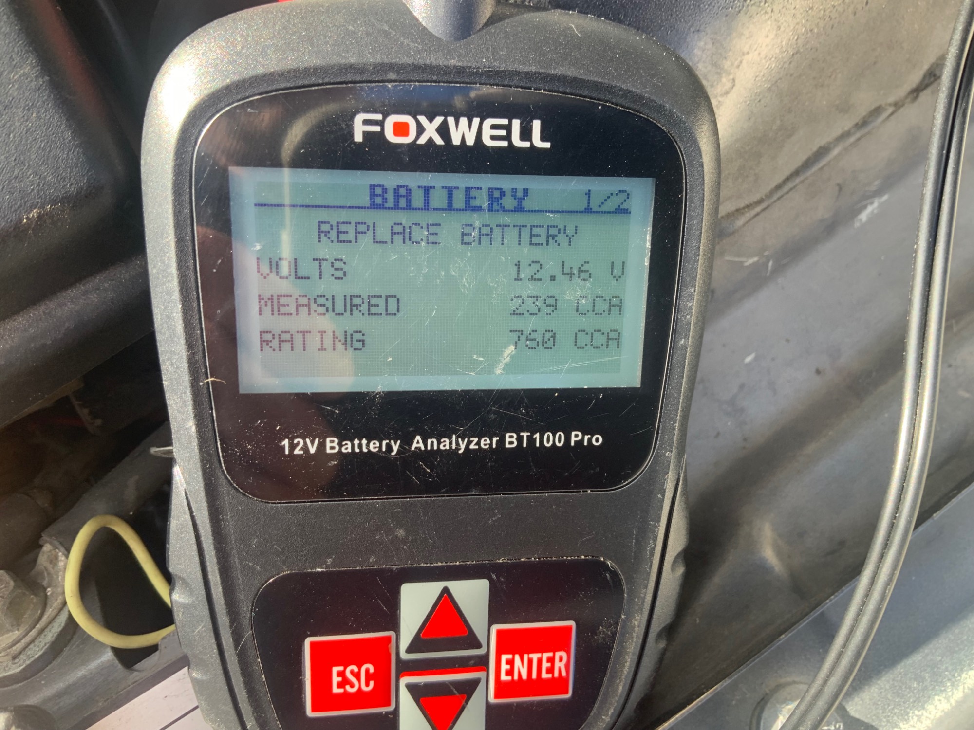

It happened again, complete electronics shut down. This time leaving my (unimpressed) wife stranded in traffic. I believe it’s the battery again. Should a $250 battery last more than 2.5 years, or is that par for the course?
Attached are a few photos showing two different readings, one at the battery location in the trunk (same readings with the negative connected, and disconnected; where it says that the battery is good but needs charging). The other reading was from the +ve connection near the fuse box under the hood (where it says to replace the battery).
Can anyone please explain why there would be a difference between them?
