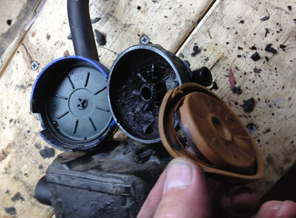

Here’s a picture of a ruptured diaphragm in the separator box that I removed from my 2003 V70 non-turbo.

@chrism,
I think that diaphragm sitting on top of the oil trap is similar to BMW CCV Valve.
Basically one-way valve that allows vapor to enter intake manifold while oil is going
back to the crankcase.
The oil trap by itself is a box, so to speak...
chrism
- Posts: 1351
- Joined: 28 Jan 2009, 09:38
- Year and Model: S80 / 2005
- Location: Atlanta, GA
- Has thanked: 7 times
- Been thanked: 89 times
When the diaphragm ruptured on my car it subjected the crankcase to a very strong vacuum. So strong it caused a loud whistling noise as air was being sucked into the engine through the various oil seals, etc. One person described it as a kazoo.
